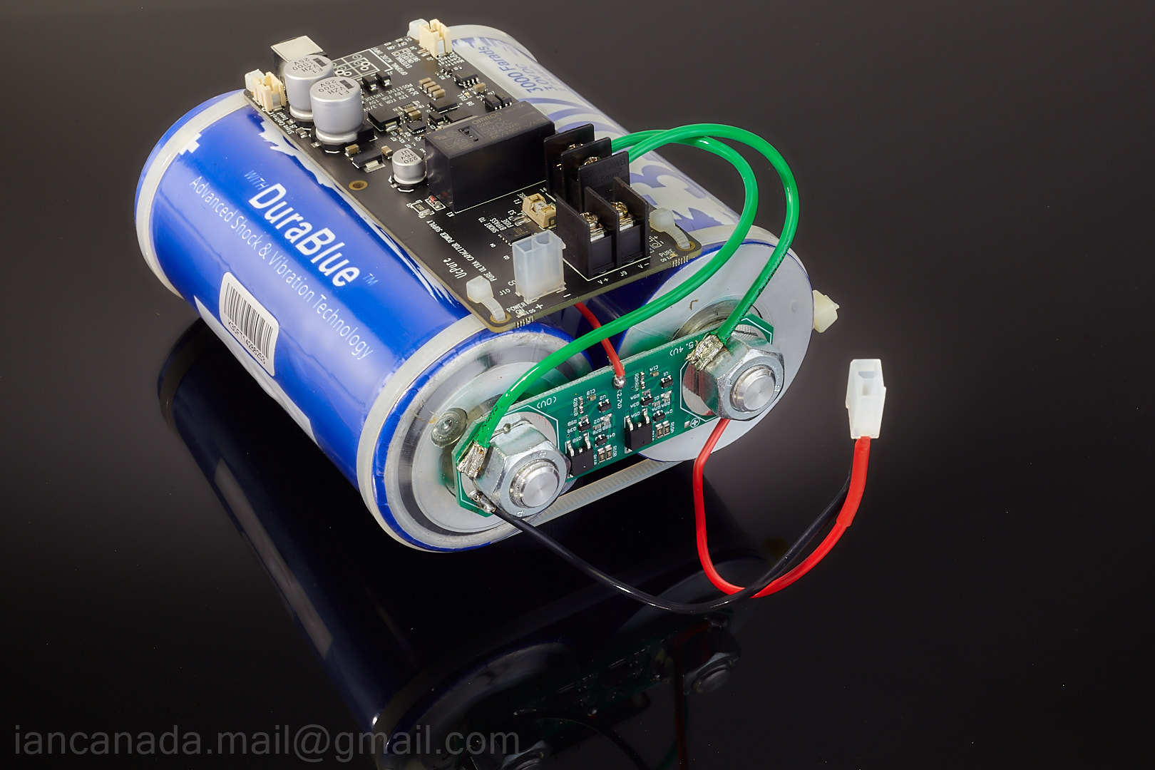

UcPure with Eaton 3000F/3V ultracapacitors report after 10 days of break-in

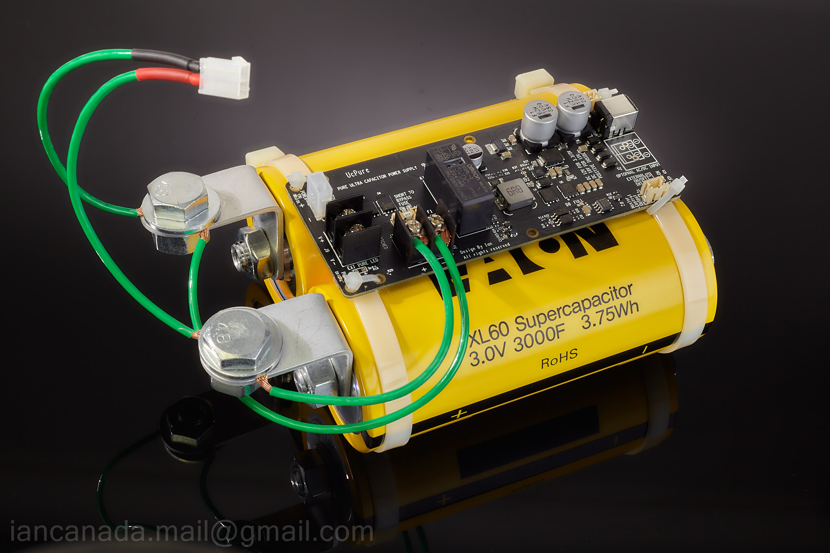

As the power supply of SinePi and FifoPi clean side, UcPure with the Eaton XL60-3R0308T-R 3000F/3V ultracapacitors have continuously been-in my system for more than 10 days. I have to say the break-in really makes a difference. Step by step, the sound changed better and better, and I like them more and more. Here are some reports
1. About the balancing voltage
I didn’t use a balancer board for the two Eaton XL60-3R0308T-R 3000F/3V ultracapacitors because I think the headroom voltage is big enough. Now after running continuous for 10 days, the voltages on the two ultracapacitors are 1.65V and 1.75V when fully charged. The voltage difference is just 0.1V, better than I thought. That's pretty good. I’ll still keep watching the voltages just to make sure there will be no problem for even longer. But for safety reasons, I still recommend use the balancer board for the ultracapacitors.
2. About the sound quality
I have two UcPure setups, one with the Eaton XL60-3R0308T-R 3000F/3V ultracapacitors, and the other one with the Maxwell 3000F/2.7V caps. I got them carefully compared at the SinePi/FifoPi clean side power supply position. I can say, both of them sound great, better than all the active regualtors/LDOs I have ever had, and also, even better than the 3.3V LifePO4 battery power supplies. The sound quality difference between two different 3000F ultracapacitors was very small. But I can still hear some differences, mainly in style, though the difference was just minor.
A. The Maxwell 3000F/2.7V caps tend to be warmer, nature and feels a little bit more musical. Overall, just a little bit more analog and vivid.
B. The Eaton XL60-3R0308T-R 3000F/3V ultracapacitors tend to have a wider and deeper sound stage. A little bit more detail and dynamic. The image pin point feeling was also a litter bit better.
To be honest, I really can not decide which one is better. Both of them are equally great for me. I’m happy with either of them. The good thing is that Mouser still keeps Eaton XL60-3R0308T-R in stock.
Again, the comparison test was just based on my real listening experiences. But it was just my own subjective feelings. And could combine with psychology and other undetermined conditions. So, if there is any question, please trust your own listening test.

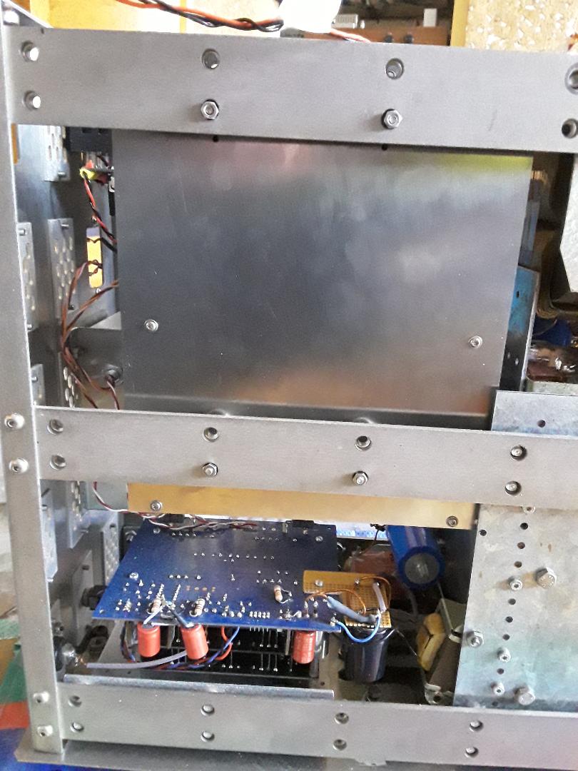

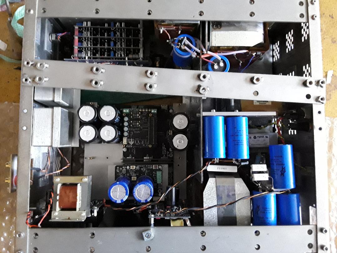

Hello,

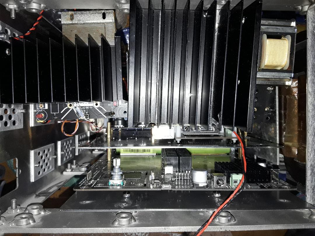

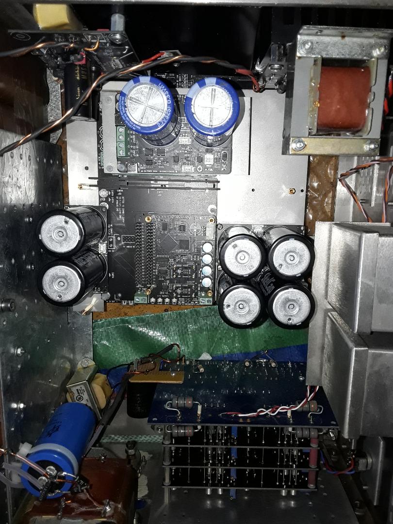

Some photos showing how the fifo tower will be mounted in my DDDAC chassis.
As you can see the '' mainframe '' has been constructed using 3 stainless steel bars going from left to right on the top side and the bottom side . These bars are not welded to the left and right side but use welded nuts in order to be able to remove them when you need to move in a big part like the Fifo tower.
YES, lots of welded nuts because i wanted to be able to use them to mount the bottom or top plate and mounting a construction like the fifo tower.
In the photo it is just temporarily mounted using some rubber grommets and small M4 bolts that pass through the M6 welded nuts. Just want the tower to be safely fixed. No matter what seize of supercaps are used i want the tower to stay exactly where it is ( can move 1 millimeter or so because of the grommets) so if the chassis will be moved one way or another there will never be short circuit because something moved.
Suppose a friend wanted to try your creation at home and after he installed it, switched it on he only hears a strange noise ending with a final boom. Chances are small you will say of course.
The lifepo4 board will be ''fed'' by the supply designed by Doede mounted right above the circuit. The present supply will give the 5 volt for the Raspberry, both supplies for the fifopi Q3 ( both 3,3 volt!) and the 3,3 volt for the reclockpi.
Surely Ucpure should be better BUT first get this tower working. AT LEAST i managed to get short power supply connections!
Yesterday i discovered the ''biggest '' cap on the Fifopi board is missing . I try to find out the details about this C29 cap but the photos i found online are not enough. Which cap i can use here THAT i can solder myself without getting into trouble? I wouldnt mind if it has two leads that you normally see for through hole mounting . A Maybe i have some Oscon somewhere but not 680 and probably higher voltage. I have one Oscon 180/20 volt and Black Gate NX 100/16 volt.
Sinepi is still at Dutch customs since 12 november but still wanting to have everything ready end of this month.
Greetings, Eduard

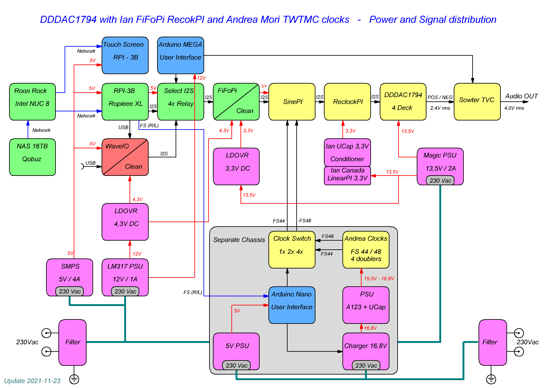

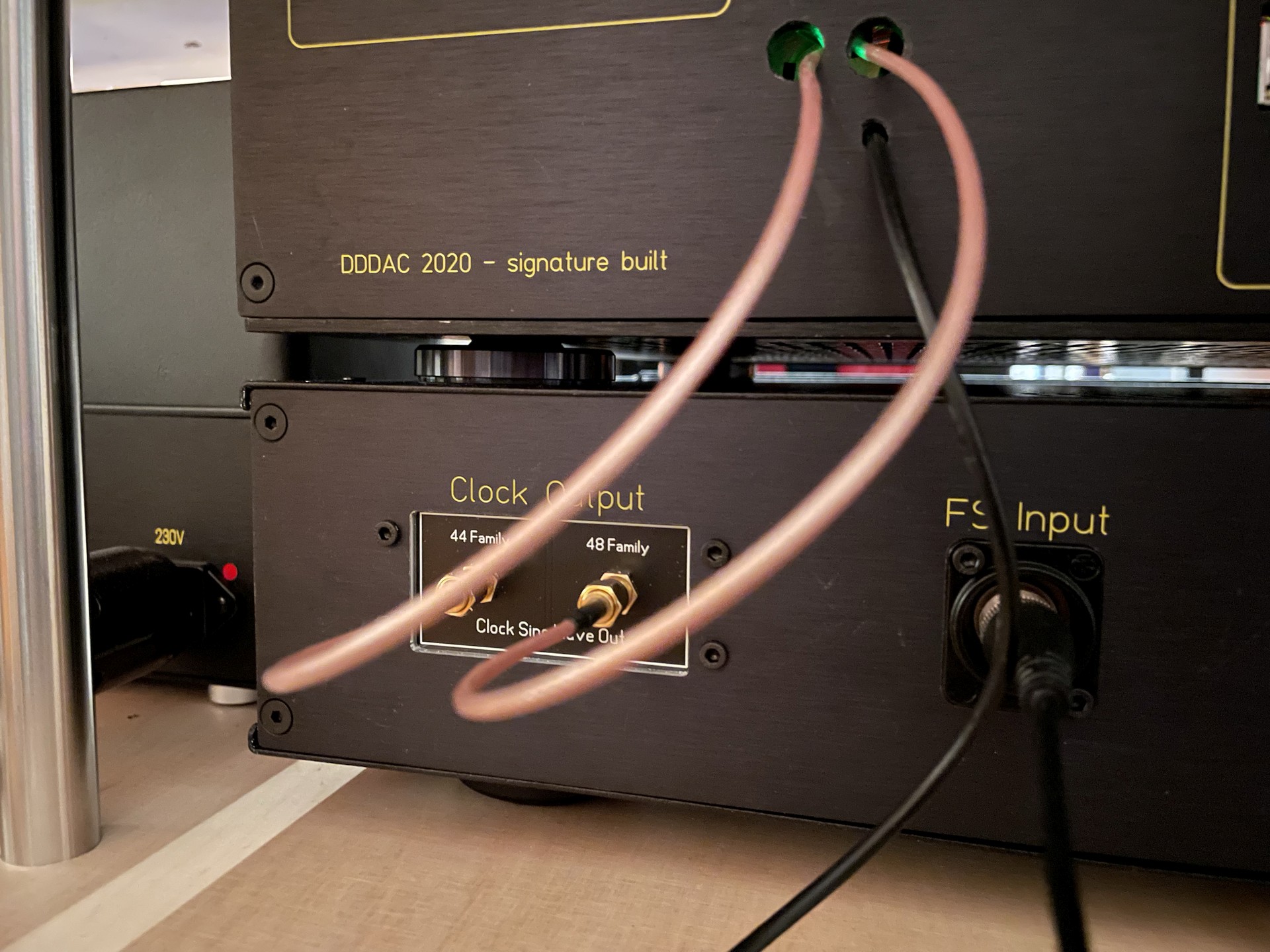

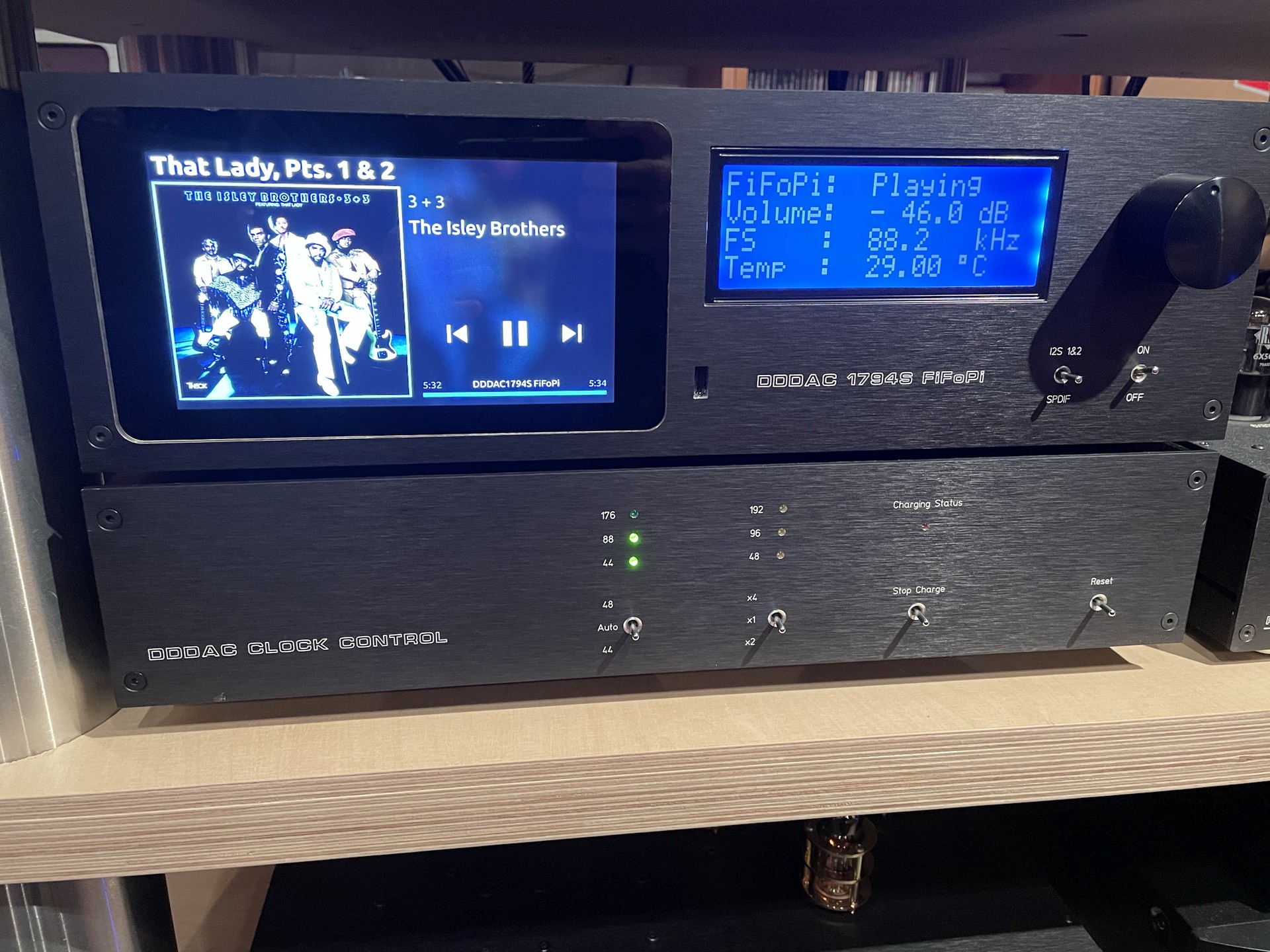

Thanks to Ian for great service - I already received my Bubble envelope today. With a new reclockPI and an UC 3,3V (I took the opportunity to also upgrade the power supply for the reclockPI - at least a good outome of the blow up of the reclockPI )
Just built everything into the existing chassis and (for the time being...) my DAC and external clock system are "Ready" now.
I will report back on the impact or doublers yes/no in the chain on my blog next week or so.
Here are a few pictures and in case you wondered what is inside, also a diagram of all the building blocks. It became a nice blend of DDDAC / Ian / Andrea / Audio Creative....
you can see in the two pictures that the clock automatically adapts to to the track source sample frequency (FS)
