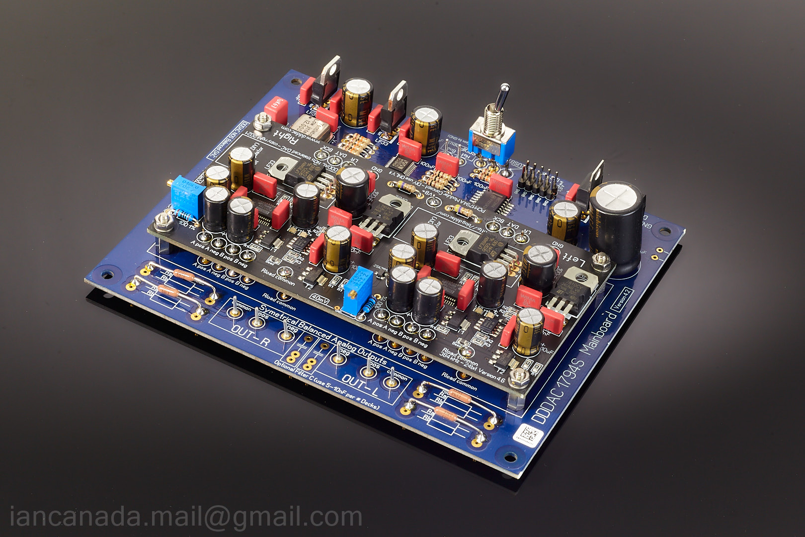

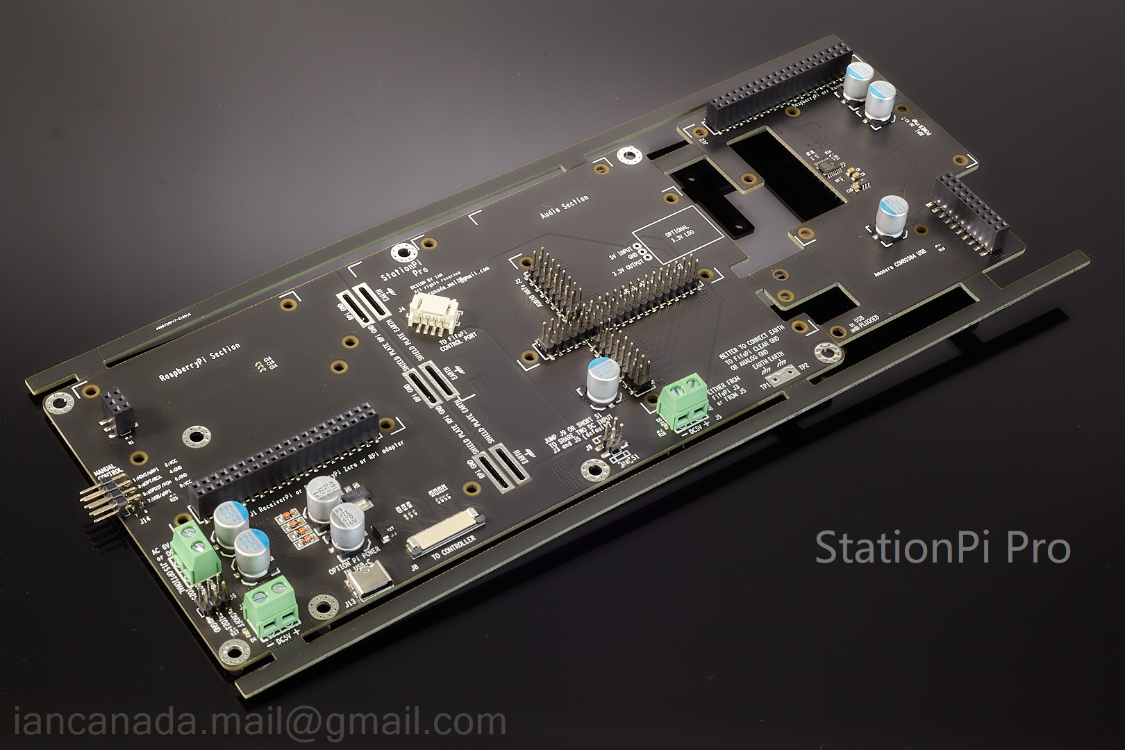

The next I'll build my DDDAC project
Seems I could have some free time recently. I'm gonna build my DDDAC DAC.
The configuration could be:
1. StationPi Pro
2. ReceiverPi Pro
3. FifoPi Q3
4. ReclockPi
5. SinePi
6. DRIXO OCXO
7. DDDAC
Amanero USB streamer can also be included as the USB source. It can be installed directly on to the StationPi Pro.
Different from StationPi, StationPi Pro will be in fully finished this time.
Power supply to be decided, could be
UcPure, two of LifePO4 Mini and LinearPi with UcConditioner
I'm also interested in trying the new Raspberry Pi Zero2. For a processer board, less power consumption means less EMI noise.
Ian
