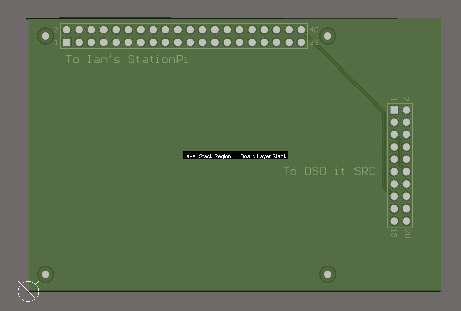

I designed a conversion board between DSDit SRC board and Ian's STATIONPI, so that the I2S output of DSDit SRC board and beaglebone black can be passed DSD signal to Ian's reclock via STATIONPI.
I will share my experience after I finish the test.

Upsampling will be good, you will know after trying an excellent upsampling algorithm.
Using this conversion board, in addition to using DSD Upscaling to obtain better sound quality, you can also use BBB with better I2S design, and the use is limited by the defects of Raspberry Pi.
The upsampling process does not "increase" the original music signal. Even if the sampling frequency reaches 192kHz, the bandwidth of the music signal can still only reach 20kHz.
Since there is no "increased" bandwidth, why does Upsampling sound better than the standard 44.1kHz digital signal? The difference is that the digital filtering will be affected before and after Upsampling. When we use digital upscaling to up to 192kHz, the center point of digital filtering is 96kHz, which is "the frequency that human ears can hear", and then the reference point of analog filtering will be far away from 96kHz.
Upsampled digital signal is by DA conversion, and in the "time range", it can more faithfully approach the original signal. In other words, the phase shift can be greatly reduced after upscaling, which is why the sound quality of digital upscaling is better than that of standard CD signals.
The built-in digital filter of the DAC will of course be upscaled and then processed. However, the limited performance of the DAC makes it impossible for its Upsampling algorithm to be better than the SRC4192 or AK4137, and it is even less likely to be better than the integrated SRC4192 and AK4137.
Although he is an ndk duculon, he should not be a sin clock, so of course not. However, since the conversion board is to be designed, why should it be restricted to be used only for sin clock?
Because, if it isn't a sine clock (and especially in this case, since it specifically says in the image and datasheet that it an drive cmos directly), it doesnt need conversion?
That's correct.
"Bipolar Driver output that can drive CMOS-IC directly"
The output should be square wave based on the datasheet.
However, a SinePi can take both sine input and square input so there will be no any problem.
Square input could have even less additive jitter because of the higher slew rate under the same voltage rail noise. But have to confirm.
