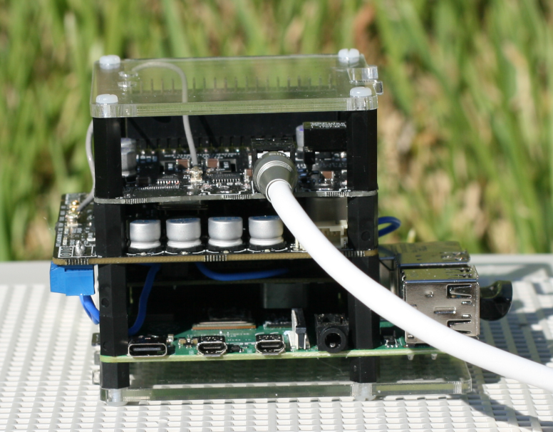

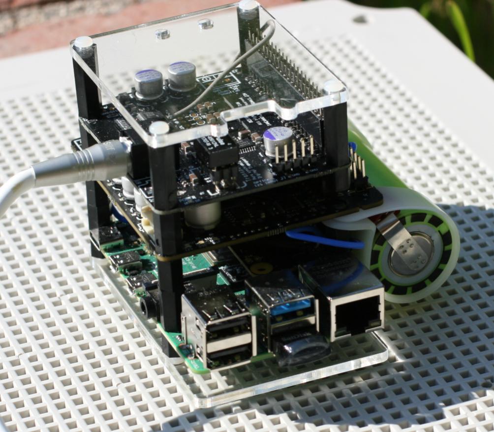

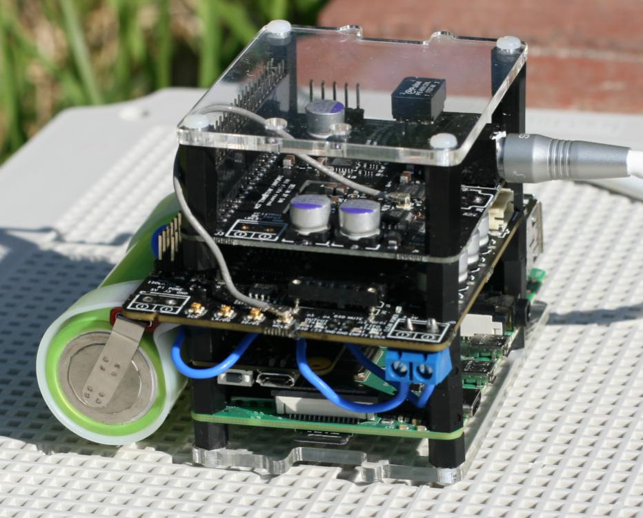

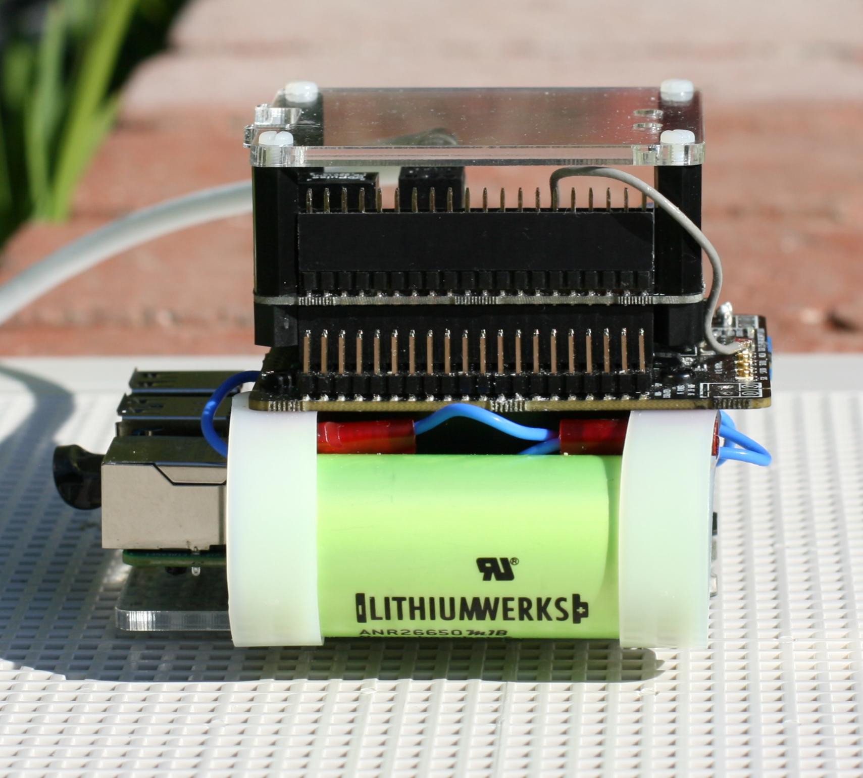

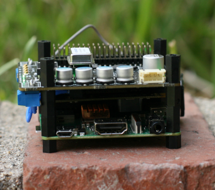

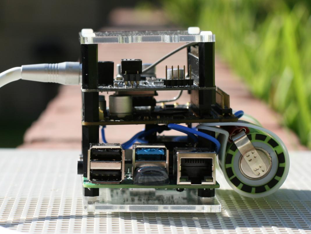

Portable/Transportable Project 95% Complete!
@InspectorGadget, Yay I found a use for the A123 26650 w/ tabs.
@iancanada, Thanks for making my portable/transportable optical transport dreams come true.
My vision was for a pocket-able optical transport powered by an A123 26650 with a audiophile OS.
I still have work to do. I need to wait for an RPi 4A/A+ or RPi 5A/A+ to potentially make this pocketable. With the hardware limitation of just RPi 4, it's just transportable for now.
I don't think a ReClockPi is in the mix since it makes it too tall. Too large a footprint. With a "Pulsar" clock, I may have no choice if I go with a normal sized "Pulsar" or a low-profile "Pulsar". Maybe if a Q4 is a combined Q3 + RCP, I can move that to this project and my current Q3 to the desktop.
I'm running AudioLinux:
EDIT: Eventually, I plan to add black heat shrink around the battery so it looks more stealth. It sound goods without an Audiophile OS, but with an Audiophile OS it's sublime especially with tracks and OS loaded into RAM. With the A123 26650, it seems to give it weight and more punch (oomph). Could also be because it's straight from the battery (tabs) versus battery holder. #Ready4Pulsar
Now that this project is over and I literally just received Andrea's clock, I can focus on the desktop side.

@A123
Amazing project. Looks very nice. You use the LifePO4 battery cell in a very smart way.
Congratulations!
Ian
Congratulations!
Ian
The RPi Compute Module 4 with a custom board could be a way toward minimization in your case. CM4 has an eMMC option too. Kicad files for the official CM4 IO board are available, making a custom board design much easier.

@A123
Congratulations!
Ian

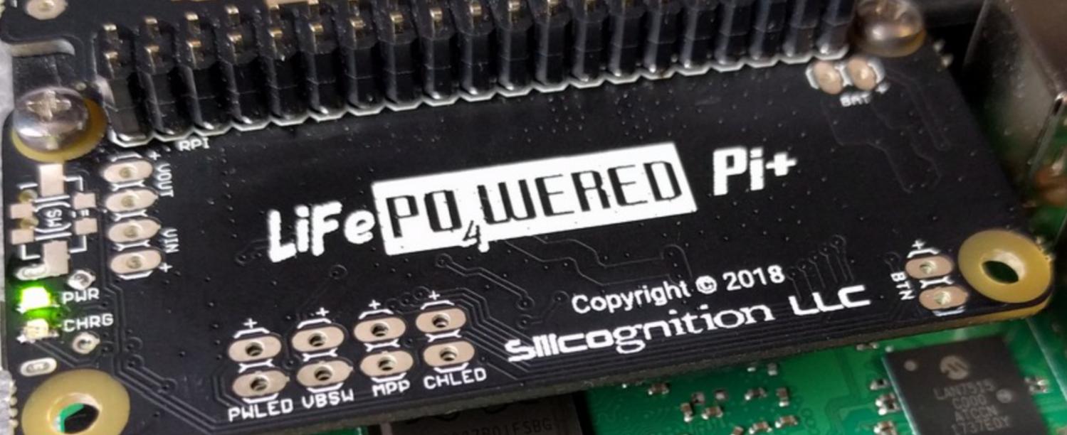

Thanks, it means a lot. Without the flexibility of your products, it would not be possible. I forgot to mention the flexibility of clock / oscillator rolling which is most important as no other products offer this solution. This allows me to be happy with my current setup, but the door is open to upgrade down the road when I'm ready or if new clocks are released. So basically, it's worth pursuing a project as you can scale over time.
@A123 How did you charge the 26650 battery cell?
Ian
It's quite straightforward, the BMS handles all these tasks (See Attachments). On the side there is a micro USB port for charging next to the power switch.
Once I solder the battery wires to BAT, the BMS will handle the charging from there...
Other options include:BAT:
Battery voltage. This is where the user connects their external 1S LiFePO4 battery pack when the “no on-board battery” option was chosen. The “+” mark indicates the positive terminal.
It is recommended to have a high-current connector in the battery leads, so the wires can be soldered to the board without the actual battery connected. If this is not possible, be very careful to not short the battery terminals while soldering the wires to the board.
If the LiFePO4wered/Pi+TM does come with a battery on board, these connections provide direct access to the battery voltage. It is not recommended to connect any load to these pads because they are directly connected to the battery and as such provide no short circuit or over-discharge protection.
I use this to power the clock side:VOUT:
Output voltage. This is the switched 5 V output voltage to the Raspberry Pi. The “+” mark indicates the positive terminal.
A user can power other 5 V loads from these pads and they will be switched on and off together with the Raspberry Pi. For example, a case fan can be connected here.
You can use another power source to charge if you don't want to use micro USB:VBSW:
Switched battery voltage. This is an auxiliary switched output of the battery voltage (3.2 V nominal). The “+” mark indicates the positive terminal.
External 3.3 V circuitry can be powered from these pads and it will be switched on and off together with the Raspberry Pi. Unlike the BAT connections, this output has short circuit and over-discharge protection.
VIN: Input voltage. This is where the user can permanently connect the input power source instead of using the micro USB connector. The “+” mark indicates the positive terminal. Note that these are directly connected to the micro USB connector pins, so the USB input voltage can be measured here if the micro USB is used as power input. You should only ever use one of them at a time: either the micro USB or these pads.
It is recommended to use these pads instead of the micro USB in high power systems, since micro USB connectors were not designed to handle high currents.
I believe this one is for solar charging..BTN: External button. This is where the user can connect an external momentary switch to duplicate the functionality of the on-board push button. The “+” mark indicates the positive terminal (polarity is important if using a transistor instead of mechanical switch).
If the LiFePO4wered/Pi+TM is switched to touch pad mode, a capacitive touch pad can be connected to the pad marked with “+” and the other pad is not used. Keep wiring as short as possible in touch pad mode.
MPP: Maximum Power Point setting. This connection will allow the user to customize the maximum power point (MPP) voltage by adding a resistor across the pads. The charger will reduce the charge current as needed to ensure the input voltage does not drop below the MPP voltage. The “+” mark indicates the positive terminal.
By default the MPP voltage is 4.66 V nominal. This is what limits the input current so a weak USB port does not get overloaded. If the user connects a solar panel as input source, a resistor needs to be added to optimize for the panel’s MPP voltage.
The MPP resistor value can be calculated with the following formula:
RMPP = 51815 / (VMPP – 4.66)
I'm in no rush as this is a pandemic build. Once things are back to normal, then hopefully I can downsize in 2022.
The CM4 would be a great option w/ eMMC since there is a 8GB model too, but I don't want to use a third-party board. It has to be an official RPi. As shown in the attachment the A models fit perfectly, I just need the modern 8GB. But I'll look into the custom board design route when I start giving up hope for new RPi A models. Thanks for the tip. I was following SBC gaming rigs, but haven't kept up with the latest boards so if there is something official out there I would consider.
I boot the RPi with USB so the eMMC would be great. eMMC is suppose to be super quiet with better performance. I have the option to remove the USB drive before I start a listening session after the OS boots into RAM, but that gets tiresome.
