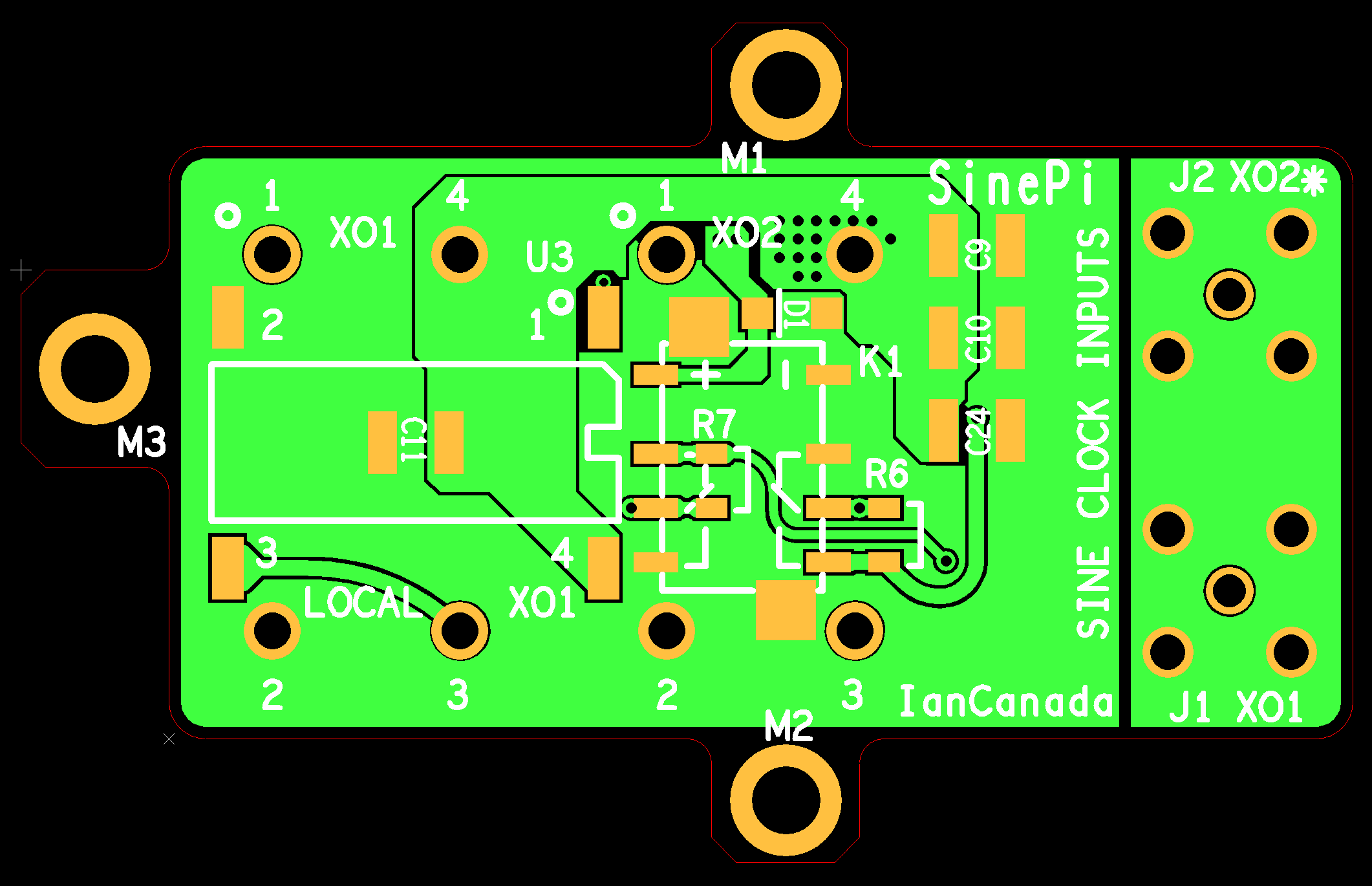

Design SinePi, a possible better sine to square converter for FifoPi
Design ideas:
1. One piece PCB architecture with full 8 pins connecting to the FifoPi XO sockets
2. Discrete sine to square converter to achieve best possible low jitter performance and good low noise signal quality
3. Support both full sine mode with two external sine inputs and half sine mode with one local clock one external sine input
4. Flawlessly works with FifoPi Q1,Q2 and Q3,
5. Disabling the unselected clocks by the on-board relay switches. Can be in three different configurations:
A: No relay for FifoPi Q3
B: Standard relay for FifoPi Q1,Q2 and Q3
C: RF relay for FifoPi Q1,Q2 and Q3
6. Enhanced NP0 and film capacitors decoupling networks to ensure lowest possible power supply noise under mechanical vibration by eliminating piezoelectric effect.
7. Right angle SMA RF sine input connectors for better system integration
8. Three mounting holes for more reliable mechanical supports
9. 50 ohm output impedance with source series termination resistors
10. Input sine clock amplitude range: 0.5V - 5V Vpp in 50 ohm termination
11. Input sine clock frequency range: 1-150MHz
PCB design was finished. Prototype will be ready for testing in two weeks.

Good luck 🙂
somebody should measure it.. 🙂
good luck determining the proper measurement procedure.
The (very interesting) discussion just above ended with a bloom of happy faces, but still the topic is not settled...
We'll see, i love dramas 🙂
"do it yourself at home" procedure #1:
Feed the sine clock into a 2 way splitter
Splitter output 1 -> sine-to-square -> lowpass -> mixer input 1
Splitter output 2 -> lowpass -> mixer input 2
mixer output -> lowpass -> DC voltage -> ADC -> FFT -> math -> phase noise
Gotchas: sine-to-square output feeding back to clock and injecting its own noise
Requirements: phase shift between mixer inputs should not be 0° or 180° because that's the dVout/dPhi null
"do it yourself at home" procedure #2:
Sine clock -> splitter
Splitter output 1 -> sine-to-square -> XOR gate input 1
Splitter output 2 -> coax delay line -> another sine-to-square -> XOR gate input 2
XOR output -> lowpass -> DC -> ADC -> FFT -> math -> phase noise
SinePi is for working with TWTMC sine clocks. It has no business with ReClockPi though you can use them at the same time.

Hi Ian, good job, but if somone want use Just One Andrea's clock, Is possibile put your board and One standard clock dip 14.
Regards
@ilgavro
That's really a great idea.
SinePi has a specially designed half sine mode, which allows you using only one sine clock with another XO at local. SinePi has an XO socket for that local XO1.
"3. Support both full sine mode with two external sine inputs and half sine mode with one local clock one external sine input"
If you don't use SinePi with FifoPi, you also have no problem to put it on any standard dip 14 clock (XO) socket.

Half sine hybrid
This is very cool.
In my case it allows me to use the new SOTA 5MHz clock in sine mode for 99% of my 44.1 Redbook collection, and WTMC v1.0 which puts out a 48MHz square wave for the occasional hires file. Each clock can be in its own chassis away from the system connected by cable. One directly to the SMA pads and the other via the SMA adapter pcb to XO.
This is very cool.
Yes... the only compromise left is doublers. Seemed like too much space, money and power supplies for the few tracks I have. I think I'd give up on some marginal clock performance and use 22MHz clock. Any difference you notice will evaporate after a few days acclimatization.
SinePi input range will be 0.5V - 5V Vpp in 50 ohm termination, so should be no problem working with 1 to 3 doublers. I'll do test to confirm.
