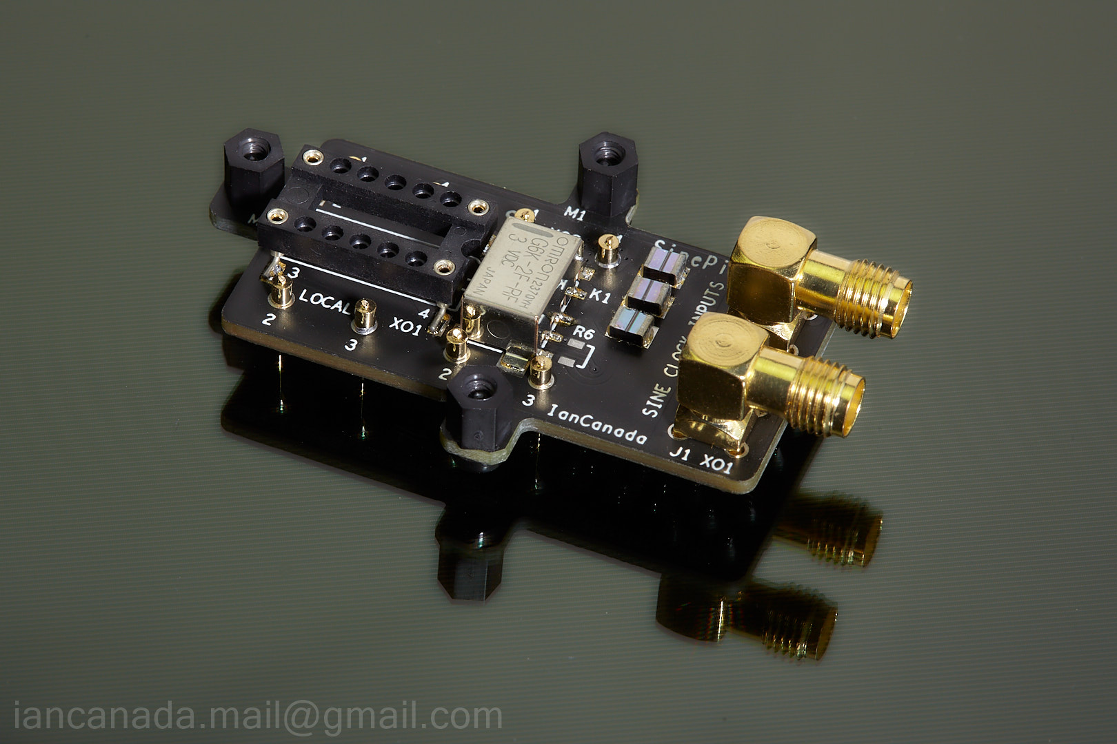

SinePi prototype PCB
Picture1 and picture2
SinePi PCB assembling

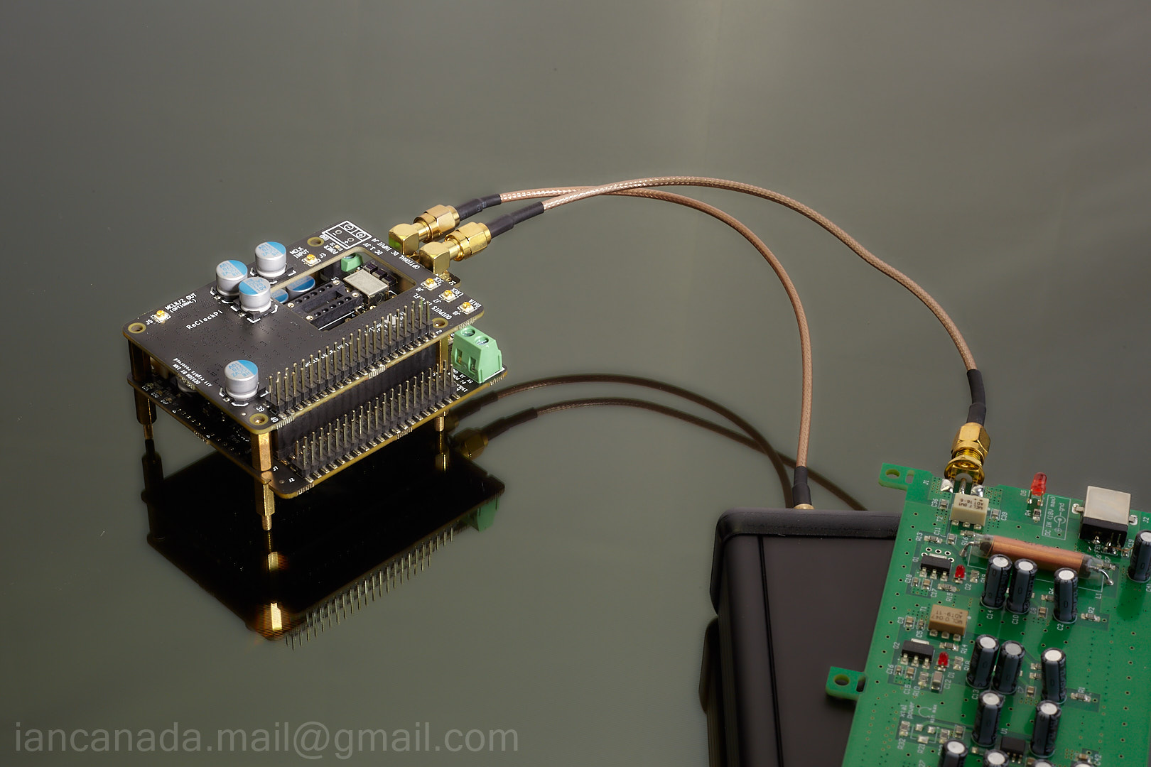

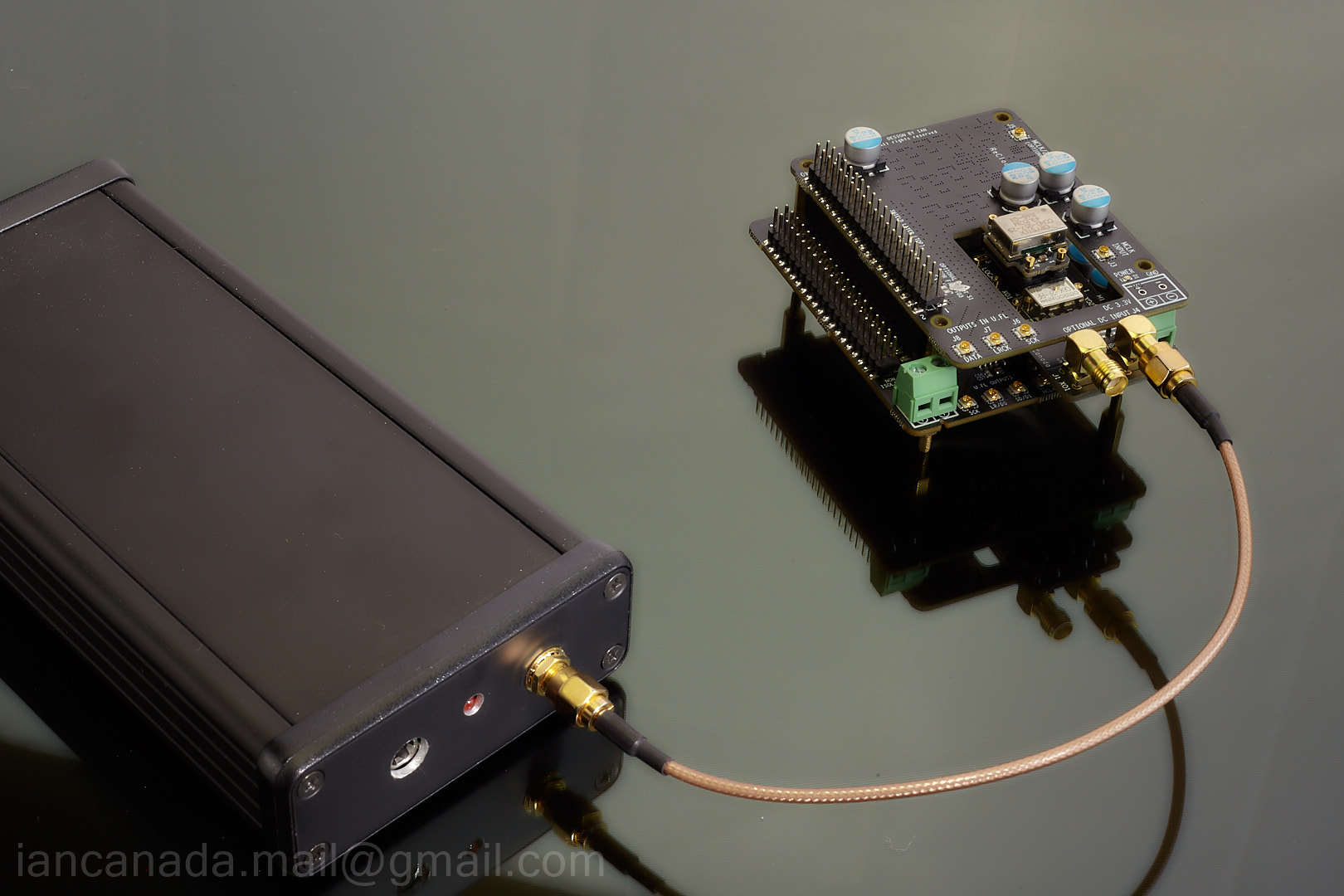

Install a SindPi into a FifoPi. SinePi is a one piece PCB architecture with full 8 PINs connected to the FifoPi XO sockets. Fit very well.
SinePi works with ReClockPi and FifoPi and two TWTMC sine clocks. The right angle SMA RF connectors will connect coaxial cables from the right side of the PCB for a better integration.
SinePi also has three mounting holes for additional nylon standoffs to keep the SinePi very solid at the position without any loose.
SinePi runs at half sine mode with one external sine clock and one local square clock.
Sine to square converter is a very sensitive circuit. AM noise is very easy to be modulated into time jitter of the square wave outputs. To achieve best possible low noise performance, SinePi uses a four-layer double side mounted PCB. It has a very carefully designed PCB layout with all impedance controlled clock traces to optimize signal quality. All resistors are metal film for lowest possible noise. All capacitors are NP0, organic Polymer, film and big size X7R to ensure lowest possible power supply noise under mechanical vibration by reducing the piezoelectric effect. The two inner layers work as whole pieces of ground shield plate to provide a continuous returning path for clock signal to reduce ground bounce noise.
More testing results will be posted soon.
