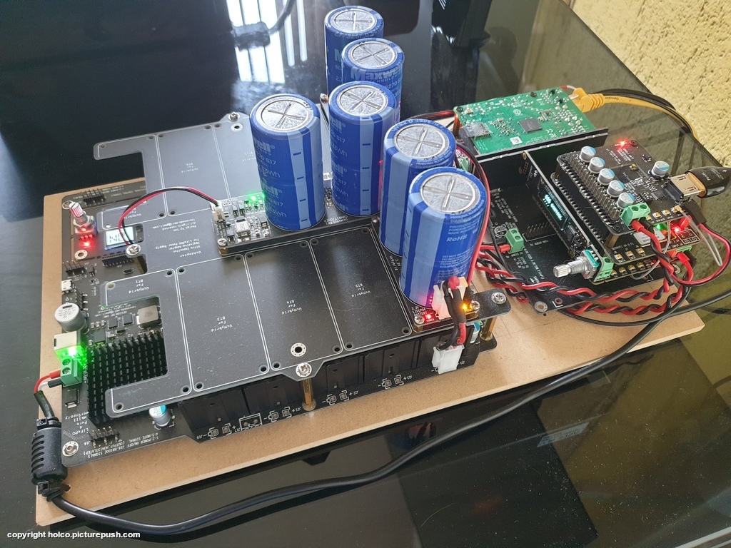

Hello Ian,
Using these 3 stand off surely makes it look more solid
Probably there will be people who would like to give this tiny board its separate 3,3 volt.
Maybe there is something that can be done to make it more easily??
Greetings, eduard
Well, directly underneath is the Fifopi q3, which has a 3,3 volt input.
Otherwise you would have one for the relock logic and also one for the squarer? Not sure if that is necessary ? Ian ?
The standoffs are a great idea.
Seeing it I realized might be able to do the same with the WTMC squarer pcb by gluing some wood or plastic standoffs onto that board to butt up against reclockpi to hold it in place. I might take a look at that as well.
FWIW, I did experiment with separate power to a NDK SDA pcb using low noise reg, blackgate caps and a supercap. It was at least one of those little dots that add up. Power to the clock is shared with the IC that outputs mclk so perhaps some small advantage to individual power supplies. I also popped a blackgate HiQ cap onto Andrea's squarer and to my ear it cleaned up the sound. I don't have a scope so no idea if it cleaned up the squiggly square wave. Not worth talking about as these thing are unavailable but simply mention as it suggests improvement is there to be had which we'll likely see with SinePi.

Hello,
Andrea told us that giving his STS solution a seperate 3,3 volt supply would be a good idea. Just like Ian told us that giving the reclockpi a separate 3,3 volt is also good.
Because of this i have a 4 separate 3,3 volt supplies, so 4 3,3 volt lifepo4 cells and three of them have an UcHybrid board in parallel.
Ian told us somewhere that his new tiny board is complicated because of Rf/Hf related things. So maybe it is good to give it its own supply so possible '' disturbances '' cannot '' skip '' from one circuit to another by means of a joined power supply.
Once you have the lifepo4 board creating an extra 3,3 volt supply is pretty easy and the cost isnt to high.
OF COURSE in the near future people will face the dilemma of going for one pair of 3000F caps, keeping 3 or 4 lifepo4 cells with smaller ultracaps or going for a big volume of 3000F caps.
I THINK that people should focus more on keeping connections between big F caps and the circuits as direct and as short as possible. Of course the currents we are using are very small so we dont need big terminals that can withstand the currents that these F caps can deliver. BUT if you will use a flimsy connector you might as well use a smaller cap.

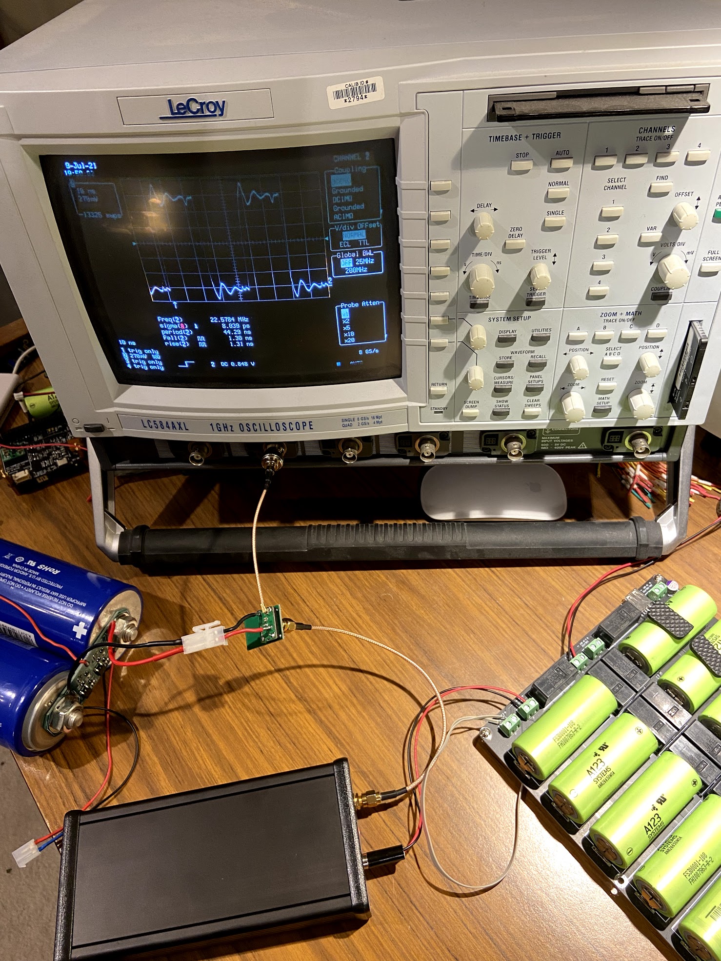

Following are the time domain testing results of my SinePi V6 by comparing with TWTMC-STS under the same conditions and at the same time:
1.Waveform measurements
The left of the first picture shows the waveform of the SinePi output with sine wave input from a TWTMC-DRIXO-22.5792 MHz.
We can see the rising and falling edges are very fast around 0.54ns. No overshoot. There are only very small ringings within 10ns after both rising and falling edges, which were caused by the transmission line (there is no perfect impedance matched cable and connectors in the real world). Both high and low logic levels are very clean. While STS’s rising and falling time are around 1.3ns, and with overshoot, bigger ringings and more noise at both high and low levels. By comparing with the TWTMC-STS output waveform (right side) under the same testing conditions, we can figure out obviously how much improvements have been made by the SinePi.
To recall my previous waveform test:
https://www.diyaudio.com/forums/dig...mate-weapon-fight-jitter-664.html#post6678025
2.Time jitter measurements
The left side of the second picture shows the time jitter plot of the SinePi output with a TWTMC-DRIXO-22.5792 MHz sine clock as input.
The SinePi RMS time jitter was measured at 3.02ps (with LC584AXL timebase noise floor removed). I never expected this number to be better than a CCHD957 because Andrea already confirmed by his phase noise measurement that the CCHD957 has a lower noise floor than DIRXO. However, with SinePi installed, this RMS time jitter number is now very close to the CCHD957 which was measured at 2.71ps. By comparing with the TWTMC-STS time jitter plot (at the right side), we can see that the SinePi improves the RMS time jitter by 2.17ps (5.19ps-3.03ps) for DRIXO. That’s a huge improvement over TWTMC-STS. I believe, with a SinePi installed, it now really represents the true performance of the great TWTMC-DIRXO in the form of square wave for what it should be.
To recall my previous time jitter test:
https://www.diyaudio.com/forums/dig...mate-weapon-fight-jitter-662.html#post6675622
3.Testing conditions:
LC584AXL 1GHz Oscilloscope with jitter measurement package
Time base 10ns/div
Run at 8 GS/s sampling with 1GHz bandwidth fully opened
50 ohm terminated coaxial cable input. Cable length 4 inches.
TWTMC-DIRXO power supply: 13.2V LifePO4
SinePi and TWTMC-STS power supply: pure 3000F ultracapacitor precharged to 3.3V (could be the best PSU in the real world)
TWTMS-DIRXO 22.5792 MHz sine clock as input
Some notes about my measurements.
1.My LC584AXL was officially calibrated 7 years ago. After so many years, I can not guarantee it’s 100% accurate. But the apple to apple comparison testing results will make more sense to figure out the improvements.
2. LC584AXL has 2ps noise floor on jitter measurements according to the specification. But the actual noise floor number could be between 2ps and 3ps because of the aging of the timebase.So I’ll pick 3ps to represent the worst cases.
3. I’m not a qualified testing lab, so the testing on Andrea’s products could be unfair for him. The reason I tested his TWTMC-STS as a comparison reference was because I bought TWTMC clocks and TWTMC-STS boards from him trying to improve my system. But I was not happy with TWTMC-STS’s performance and there was no other solution at the time, so I had no choice but to design the SinePi by myself looking for improvements for both measurements and the sound quality.
4.There is no problem if anybody is questioning my testing results. Feel free to duplicate my test by yourself and let me know if your results are different. For this time domain measurement, please do use a high speed digital oscilloscope with bandwidth higher than 1GHz and simple rate higher than 8GS/s. Otherwise you will miss many details.
5. What I’m doing is exactly as same as the title: trying to get the most out of TWTMC clocks

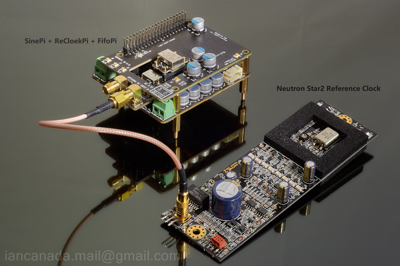

OCXO 45.1584 MHz Neutron Star2 SMB sine output with SinePi, time domain measurement results:
1.Rising/falling time: 0.53 ns
2.RMS time jitter: 2.22ps
3.Real frequency: 45.1585 MHz
Seems Neutron Star2 has lower RMS time jitter

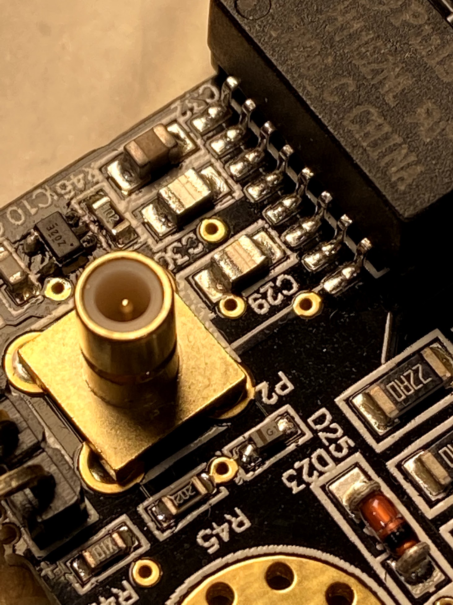

To make Neutron SMB coaxial cable output work better with SinePi, I removed the clamp diode D25. This diode was used to cut the negative voltage of the output. But can change the duty cycle less than 50%.
BTW, Neutron Star2 has an on-board oven.
To recall DRIXO with SinePi testing result
https://www.diyaudio.com/forums/dig...mate-weapon-fight-jitter-687.html#post6718041
NeutronStar2SinePi
by Ian, on Flickr
