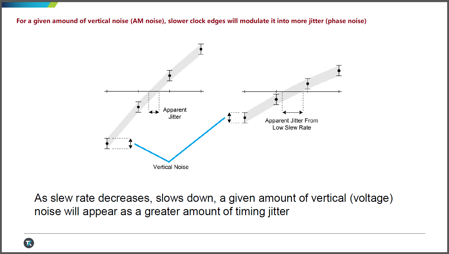

Hi Andrea,
I’m sorry but I really can not agree on that.
Slower clock edges will result in more jitter which is a well known principle.
The first picture shows that principle. Basically vertical noise (AM noise, such as power supply noise, EMI noise and so on) can be modulated into jitter ( PM or FM noise). Because the threshold window time is wider, for a given amount of vertical noise, slower clock edges will result in more modulated jitter. And all this kind of additive jitter is more likely to be close-in phase noise because the additive jitter is mainly in decades of fs range corresponding to the original clock signal.
The second picture shows the relationship between clock signal slew rate and additive jitter. You can see higher slew rate (faster rising/falling edges) generates less additive jitter.
Rather than the clock side, this issue most likely happens at the receiver side such as a DAC.The time domain measurement equipment will see the same case, for example a high speed digital scope.
But I have never seen this kind of additive phase noise shown in your Timepod phase domain measurement results. Maybe you should think of why this kind of issue can not be detected in your measurement. This also explains why you even worry about the mechanical vibration but choose to ignore the time domain clock signal quality.

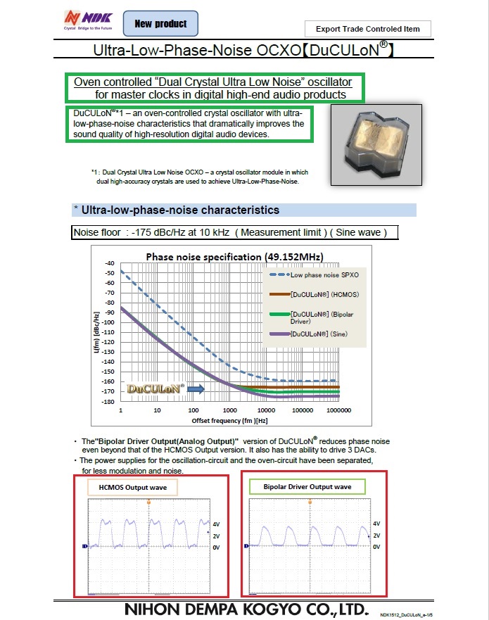

Hi Ian,
so do you think a lot of engineers at Nihon Dempa Kogyo Co., Ltd. (or NDK), one of the world's largest quartz crystal companies, who have designed the DuCuLon oscillator specifically for audio, don't know the effect of rising/falling edges of the clock on jitter?
By your reasoning, if you look at both HCMOS and Bipolar Driver output wave, the DuCULoN OCXO it's a poor device because its rising and falling edges are slow to very slow.
Although it was designed specifically for audio use.
Jitter is dominated by the close in phase noise and not by the noise floor.
This is clearly demonstrated by the plots I have published in post #6616
Asynchronous I2S FIFO project, an ultimate weapon to fight the jitter
Every time you move the integration bandwidth to higher frequencies (far from the carrier) the jitter improves.
When the integration bandwidth is 1Hz-100kHz, the RMS jitter of the Crystek is 2.4ps.
Moving the integration bandwidth to 1KHz-100kHz the RMS jitter of the Crystek becomes 27fs, almost 100 times better (40 dB)!

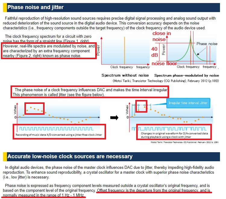

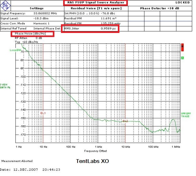

Please, take a look at the attached picture.
"The phase noise of a clock frequency makes the time interval irregular.
This phenomenon is called jitter".
As you can see at the top-right of the picture the phase noise is far higher close to the carrier.
It's this noise that makes the time interval irregular causing jitter.
The noise floor doesn't matter much because its level is usually far lower than the close in noise , 40 dB and more.
Finally, "Offset frequency is the departure from the original frequency, and is normally measured in the range of 1 Hz - 1 MHz.", that's exactly the measurement performed using a phase noise analyzer tool.
The result is the spectrum of the noise, necessary to identify the components of noise itself.
While the jitter measured as a standalone number does not say anything about the spectrum of the noise, and it's heavily influenced by the arbitrary integration bandwidth chosen for the measurement.

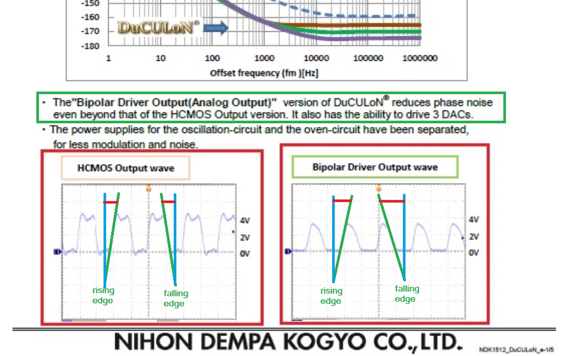

Agreed that it is a well-known effect. However, that model neglects other possible coexistent effects which may be improved by somewhat reduced slew rate. The composite effects may vary according specifics of dac design and PCB layout. Thus, it may be possible to search the sound reproduction variable space for optimal slew rate on a case by case basis. This has been known for many years, at least by some dac designers.
...DuCULoN OCXO it's a poor device because its rising and falling edges are slow to very slow.

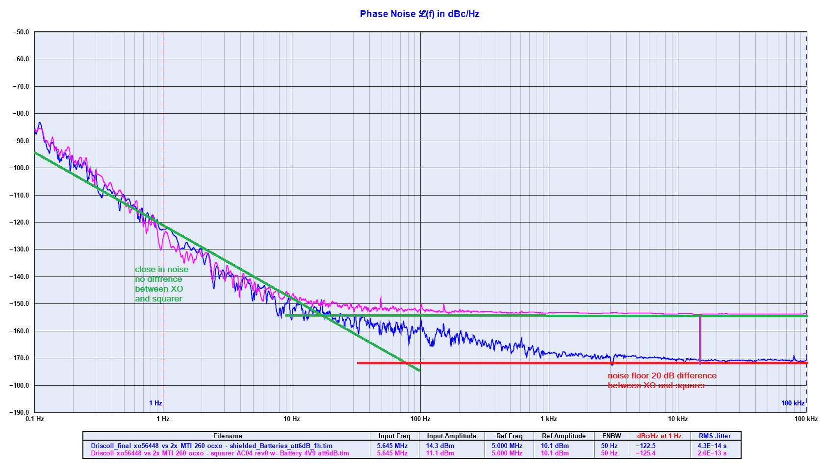

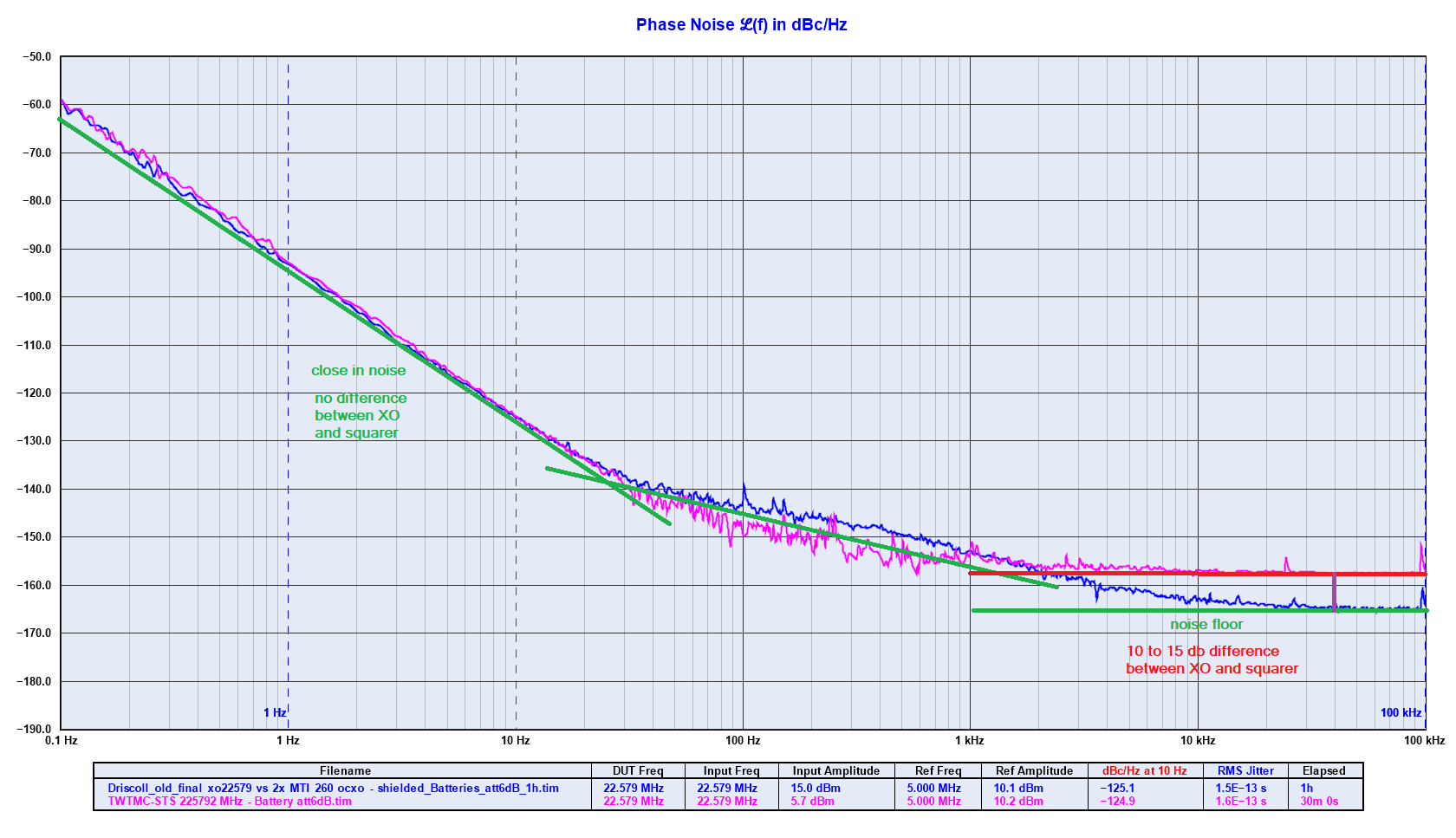

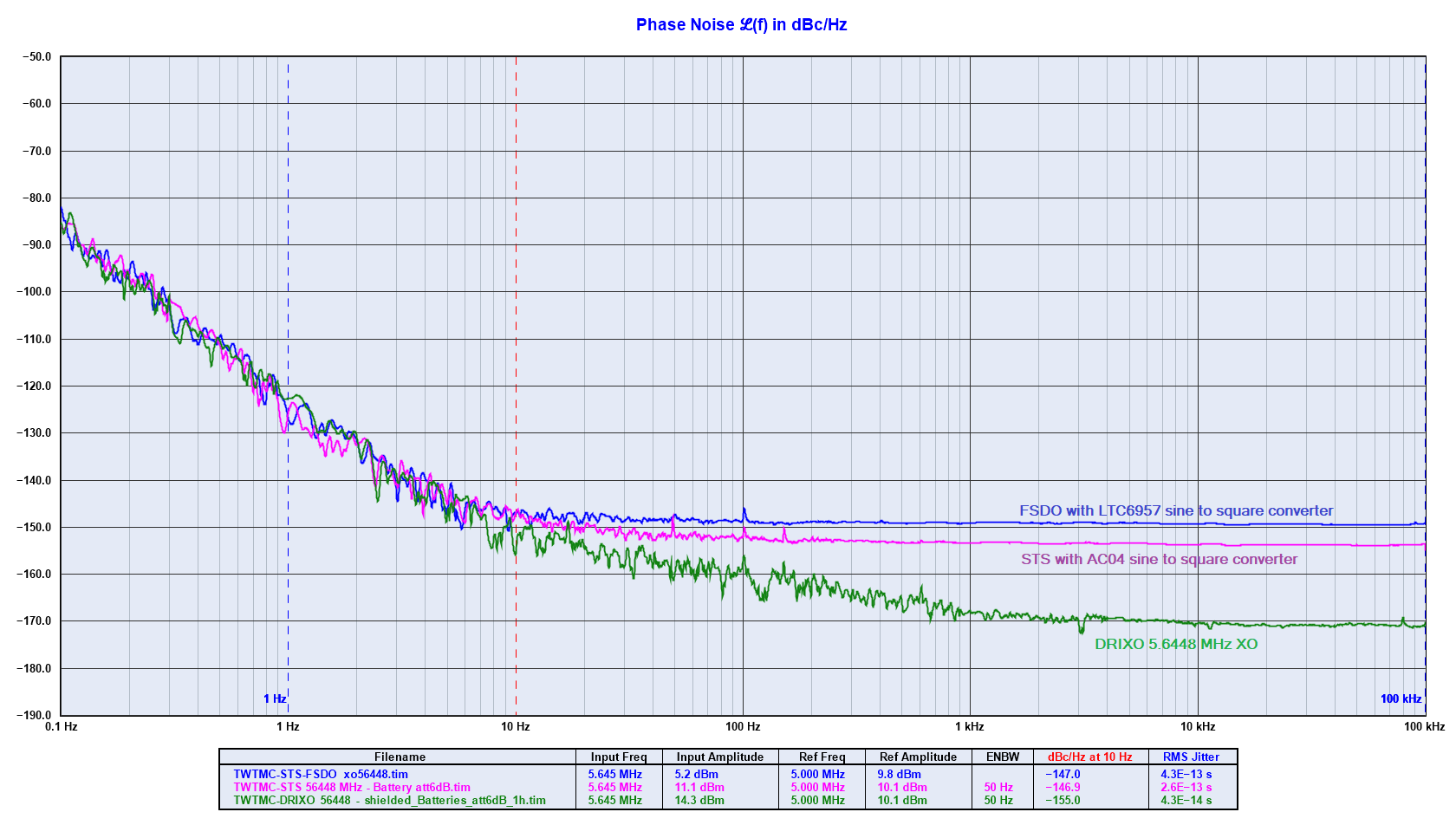

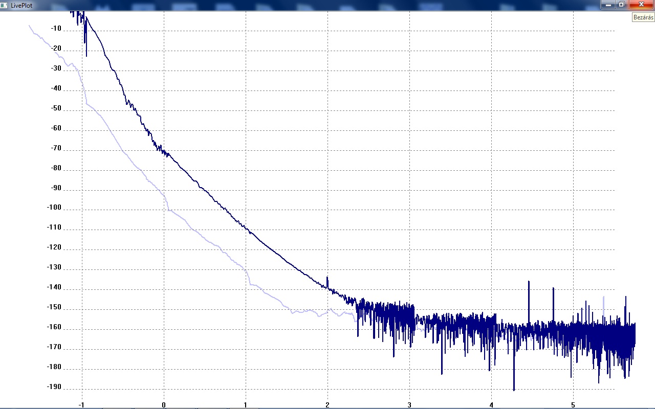

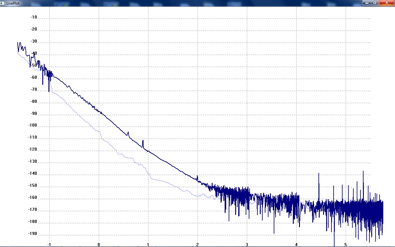

Hi Ian,
your reasoning makes sense, but i'm sorry to say you have drawn wrong conclusions.
This kind of additive jitter affects the noise floor only and not the close-in phase noise.
Exactly the opposite of your conclusions.
Please, take a look at the attached plots, they show the comparison between the measured phase noise of the Driscoll oscillators at 5 and 22 MHz in respect to the measured phase noise of the same oscillators followed by the AC04 sine to square converter.
As you can see the close-in phase noise is exactly the same, while the noise floor increases.
Even with the 5.6448 MHz DRIXO oscillator (which has a spectacular close in phase noise) the close in phase noise after the squarer is the same of the sine wave oscillator, around -150dBc at 10 Hz from the carrier.
This means that the additive jitter you are pointing out does not affect the close-in phase noise at all.
Moreover your digital oscilloscope is not able to measure such phase noise (at 10 Hz or lower from the carrier), or such low jitter if you want (fs).
Andrea

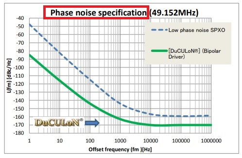

It is interesting to note that the unobtainable $2k DUCALON is -120dBc vs WTMC 5MHz -150dBc at 10 Hz from the carrier.
And let's not loose site of the fact that the vast majority of us using WTMC with its squarer are enjoying a substantial improvement in sound quality over Crystek and NDK. I recently installed the 48MHz NDK SDA and compared it to the 5MHz WTMC. Same track, one at 96kHz the other at 44kHz. Same DAC, same system. One high end the other run of the mill. No contest.

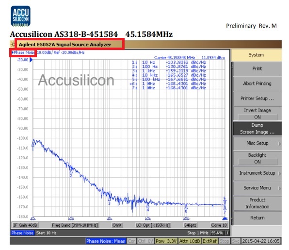

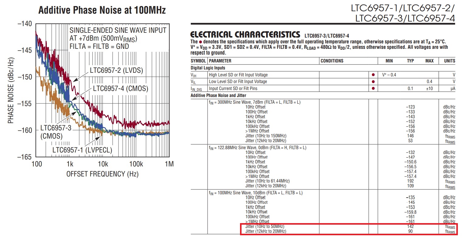

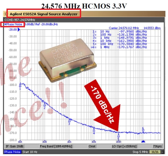

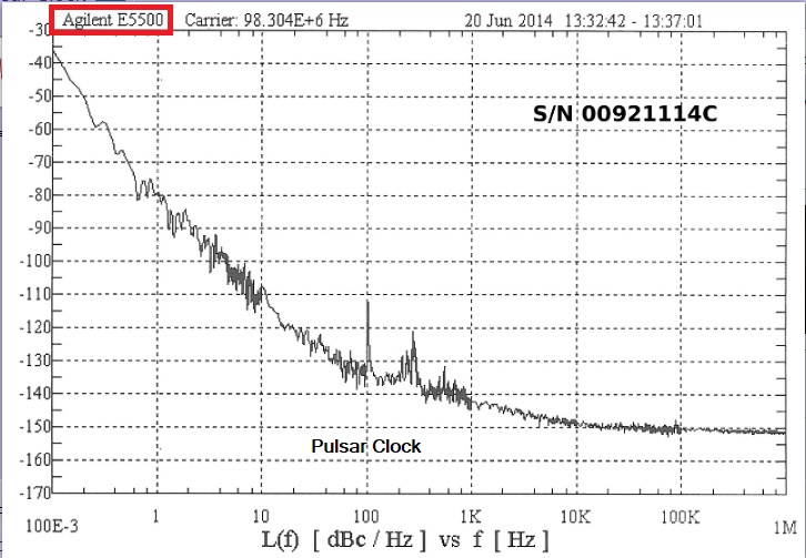

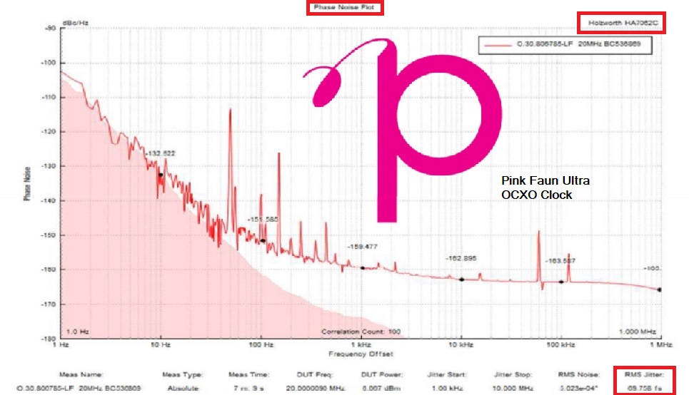

Ian,
I'm sorry to repeat myself, but your digital oscilloscope is not enough accurate to measure the close in phase noise (and so the jitter) of real low noise oscillators.
Please, take a look at the attached plots, they represent the way in which the major manufacturers characterize their oscillators for audio use, all are square wave output.
Why do you think they all have used a Phase Noise Analyzer tool rather than a digital oscilloscope?
They would have saved a lot of money, but they didn't.
The reason is simple, a digital oscilloscope is suitable to measure the jitter of oscillators designed for telecommunication, using an integration bandwidth suitable for such applications (such 12kHz to some MHz), but not to measure low phase noise oscillators.
Your LC584AXL 1GHz Oscilloscope with jitter measurement package has the same jitter of the Crystek CCHD-957 or maybe worse.
And the Crystek CCHD-957 is not certainly a low phase noise oscillator.
Please take note and buy a suitable tool like a Phase noise analyzer to make such measurements.
Hi Ian,
Andrea
Hi Andrea,
Actually your Timepod can not see the additive phase noise of the sine to square wave converter, because Timepod converts the square wave into sine wave by a LPF before make the measurement.
That's why you got similar close-in phase noise results after the STS. However what you see the increment on the phase noise plot noise floor could be the leakage of high frequency square wave harmonic components from that LPF.
Ian
Hi Ian,
please take a look at the following plot extracted from the datasheet of the LTC6957.
They used an Agilent E5505, which is a Phase Noise Measurement System, to measure the additive jitter of the LTC6957, and not a digital oscilloscope.
The Timepod measure phase noise and jitter in the same way of the Agilent E5052 and the RS FSWP, with 4 ADCs and cross correlation software.
Your digital oscilloscope cannot measure 90 or 142 fs of additive jitter, ther is no way, please take note.
Without the spectrum of the noise your assumptions are just assumptions, since your jitter measurement (although wthout an accurate tool) does not provide the spectrum of the noise.
Andrea
Andrea
This is a Crystek CCHD 957 45,184MHz unit.. It looks a bit better than on the datasheet
Without DIL socket and powersupply filtered for both crystal by a close 1 uF FCPA Cornel Dublier smd, it sounds nice: I did that 6 years ago. It improves things a lot in synergy of the caps seen inside the Crysteck metal casing...
