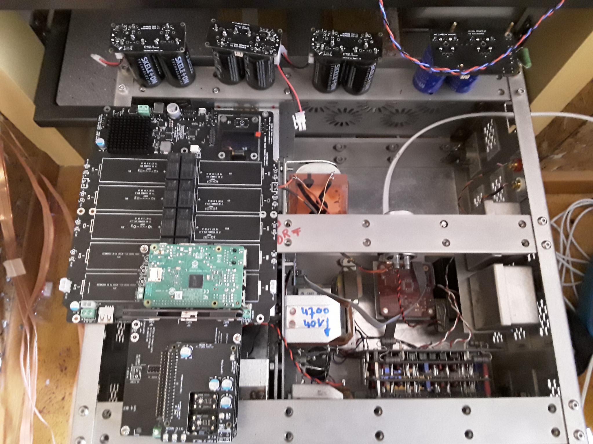

Hello,
Yesterday i removed the top plate because i received the transformer from Hammond to make the supply for the lifepo4 board.. There is an Ll2733 that can be removed now being used in the LCLCLC supply for the 12 volt. One them just installed to get a bit more voltage drop! There is the wave IO board and two tiny chokes used to offer a cleaner voltage to the 3,3 V regulators on the mainboard. Removing this elements will allow me to move all the parts( now on top of the chassis) inside and CLOSE to the mainboard.
It will require some patience and brainstorming but once this two or three level " construction " is done everything now pictured outside can be moved outside ( moving to the backside of the chassis, after removing the backplate which doesnt hold a single part and of course after removing the 4 bolts that are used to fix the construction to the bars that are located in the top of the chassis)
After interconnecting all the boards in the construction. There will be two RG400 cables going to the clocks from Andrea, the DC input for the lifepo4 that will come from a supply made by Doede which will be inside the chassis and the I2S cables going to the DDDAC. These 3 connections will be accessible by removing bottom, top and blackplate because none of these are used for mounting anything regarding electronics.

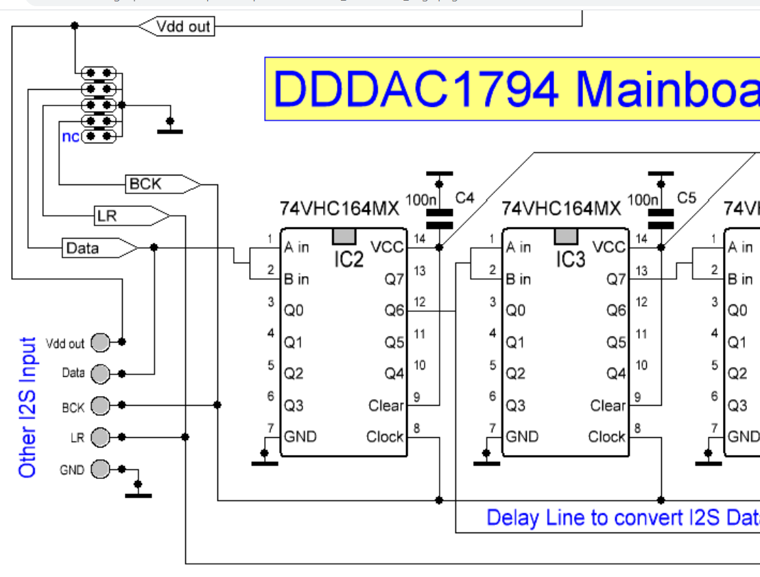

Hello,
I already ordered some UFL cables. On the Fifopi board there is a UFL connector . On the DDDAC mainboard i will just have to connect the 3 central conductor and leave the screen floating.
Also connected the shield at the 10 pin connector ground side… do not let it float Ed
These are paste and copy about UFL connection.
I think i already wrote it before that to me it is strange to use UFL chassis part and plug on the Fifopi side that will '' create '' a 50 ohm impedance and on the DDDAC mainboard side you will just use the central conductor and connect in a very '' basic way '' I dont think here there is a 50 ohm impedance.
The screens of all 3 UFL tiny cables should be connected to the GND as illustrated on the left bottom side of the screen.

that is by design Ed. If the DDDAC would have a 50 Ohm input and the logic is 5 Volt, there would be a 100mA current needed. No typical logic driver will do that without collapsing (20mA is more typical as maximum)
But there is more. Assuming the source would have exactly 50 Ohm impedance to drive the UFL cable AND the input would be 50 Ohm at the DDDAC Side, you would end up with half the voltage i.e. 2,5 or 1,65 Volt logic,
that would not work. This whole 50 Ohm thing is for analog HF signal and test and measurement setups to avoid excessive noise (scopes etc). Not for digital logic circuits...

Problem solved !
I took a closer look at the distance between the gpio header on reclockpi and fifopi. To make a long story short, the standoffs between were a little bit to long and after I replaced them with shorter ones, everything is ok. Anyway, thx for your tips.
I can measure later. I think it may seem strange, but change of standoffs was the only thing i did. The pins on gpio is very long and one should think that as long as the pins going almost all the way in, it will be ok.

@smooth dancer
How long were the standoffs with problem?
Ian
15mm
@smooth dancer
15mm standoffs could be too long to have a good contact.
I use 11mm or 13mm. I recommend 13mm standoffs for more space to avoid any possible short circuits between HATs. That's the maximal you can use.
Ian

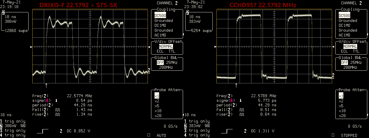

Trying to get the most out of TWTMC clocks for FifoPi system (4)
STS sine to square converter board signal quality measurement
DACs take the clocks in square waves, not in sine waves. So the sine to square wave converter is also very significant. DACs are a kind of digital logic. Clock Jitter for a DAC is decided by the edges of the clocks, not the phase of the sine wave. The DAC performance can be degraded if the quality of the square wave is not good enough, even if it is already with very good close-in phase noise.

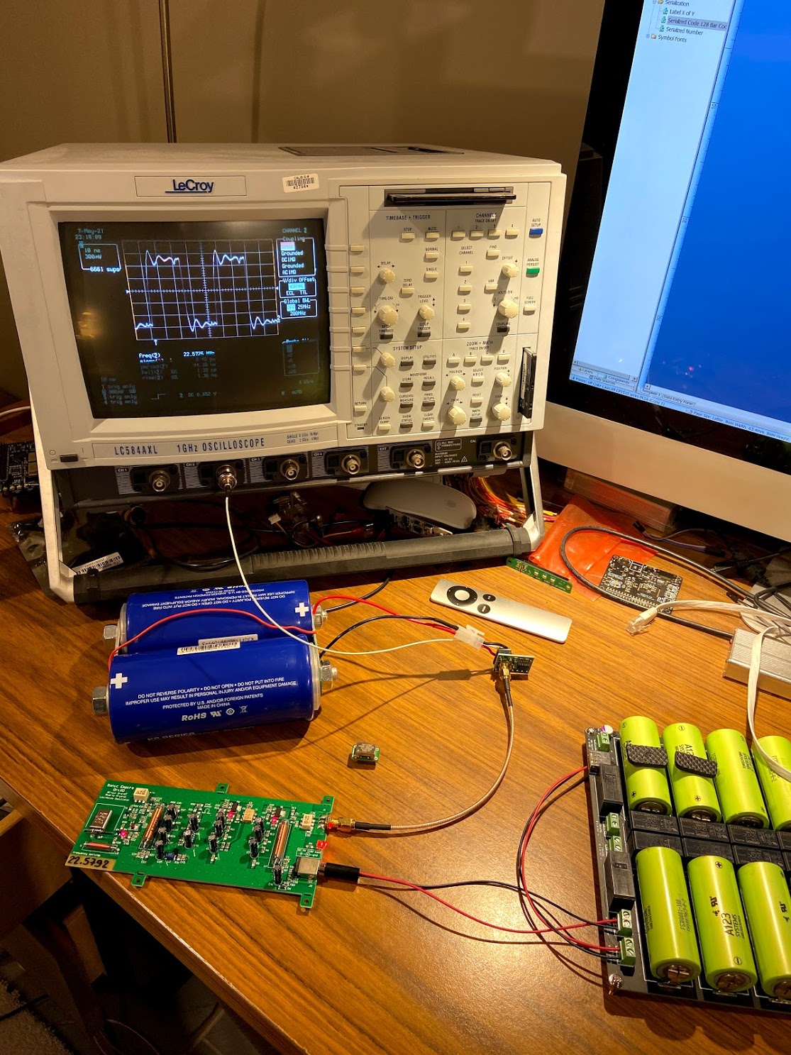

I had big hopes for TWTMC-DIRXO with SC-cut crystal because the sine wave phase noise measurement results were very good. However the square wave jitter measurement result was not as good as I expected. So I did more tests to the STS square wave outputs in the time domain. Please find the waveform results attached. Left is STS output waveform, and the right is the CCHD957 output as reference.
Testing conditions were:
LC584AXL 1GHz Oscilloscope with jitter measurement package
Time base 10ns/div
Run at 8 GS/s sampling with 1GHz bandwidth fully opened
50 ohm terminated coaxial cable input
TWTMC-DIRXO power supply: 13.2V LifePO4
TWTMC-STS and CCHD957 power supply: pure 3000F ultracapacitor precharged to 3.3V (could be the best PSU in the real world)
Frequency 22.5792 MHz
I saw issues on the STS output:
1. DIRXO+STS has big overshoot and ringing at both rising and falling edges. CCHD957 output looks much better
2. Rising and falling time were around 1.4ns. Under the same condition CCHD957 was just 0.6ns
3. Noise and ripples can be seen at both high and low logic levels. CCHD957 logic levels are more clean.
4. DIRXO +STS frequency was 22.5774MHz, while CCHD957 was 22.5789 MHz (more closed to 22.7592MHz with higher accuracy)
These issues could result in:
1. Overshoot and ringing is a kind of AM noise which can be coupled into the power supply thus modulating the FM phase noise.
2. Slower clock rising and falling edges will introduce more noise into time jitter
3. Noise over logic levels can be transferred into DAC through both GND and signal.
So I sent an email to Andrea again asking for help. His answers were:
1. STS is good enough. It was measured with perfect phase noise by Timepod
2. The waveform shape does not affect the phase noise or the jitter performance since they are measured at zero crossing
3. raising/falling time does not matter, the only important thing is that the transaction happened always at the same time interval
4. absolute frequency and long term stability (Allan deviation) don't matter in digital audio
While...I don’t think all his points are reasonable. If waveform shape doesn’t affect the jitter performance, why don’t we use the sine wave directly for a DAC? Actually besides the close-in phase noise, time domain clock signal quality can also affect the jitter of the DAC internal clocks and then the final sound quality. The improvements made by ReClockPi could be a good example. Now I think I know the reason why Andrea can not measure STS issues in phase domain by his Timepod.

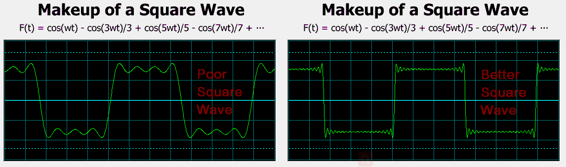

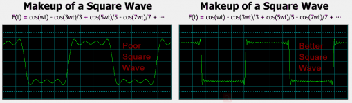

Please find the third picture attached. Basically any square wave contains components of both fundamental frequency and infinite harmonic frequencies. There are two square waves in the picture. DAC will see the two square waves in totally different quality levels. However, using a phase noise analyzer such as a Timepod, the close-in phase noise measurement results will be exactly the same. The reason is that the Timepod can only see the fundamental frequency component (which is cos(wt) in the picture) due to the limitation of bandwidth (30MHz for Timepod). That means it can not tell what’s the quality of a square wave except the close-in phase noise of the fundamental frequency.
This test is very easy. Everybody can duplicate this test. But please use a 1GHz or higher digital oscilloscopes. Otherwise waveform details will be missing.
What I’m looking for is a way of improvement. But Andrea told me that he doesn’t have any solutions so far.
In this case I’m afraid I have to design a sine to square wave converter board for my FifoPi to adapt TWTMC sine clocks by myself. I’ll see if I can make any improvement and get better results.
Ian

Sounds good. FWIW, a couple of suggestions should you make this available to your base.
1. Use all six pins to install it. We all are having issues with RG400 cable displacing the little squarer pcb from FIFOPi. 6 pins might make a stronger connection.
2. provide a working sense pin to enable FIFO to turn off the squarer. FIFOPi versions prior to Q3 can only run one clock that does not support the sense pin. It would be appreciated by many of your earlier FIFO customers to be able to run 2 clocks.
I think some people would buy your version of the squarer if you show it has a sound improvement. More would buy it just to get the two features I mentioned with the sound being a bonus.
+1
