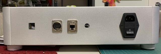

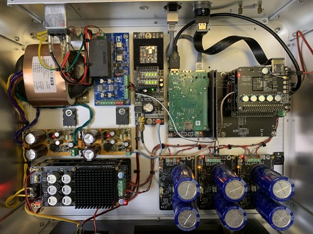

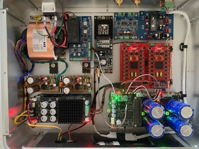

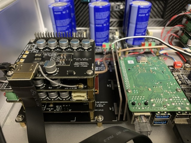

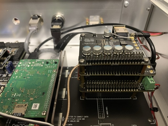

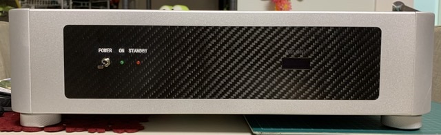

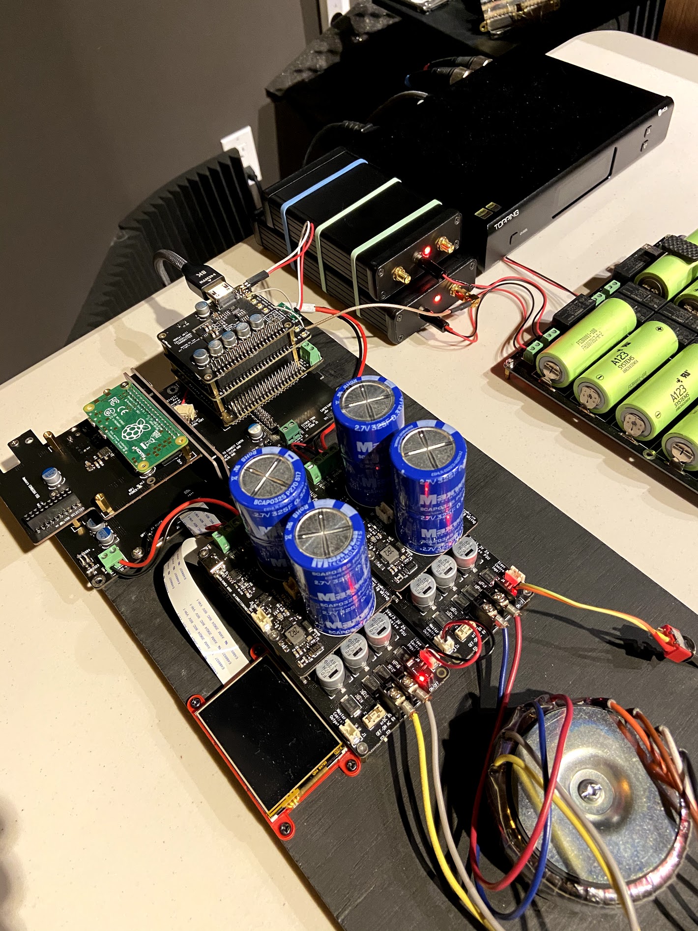

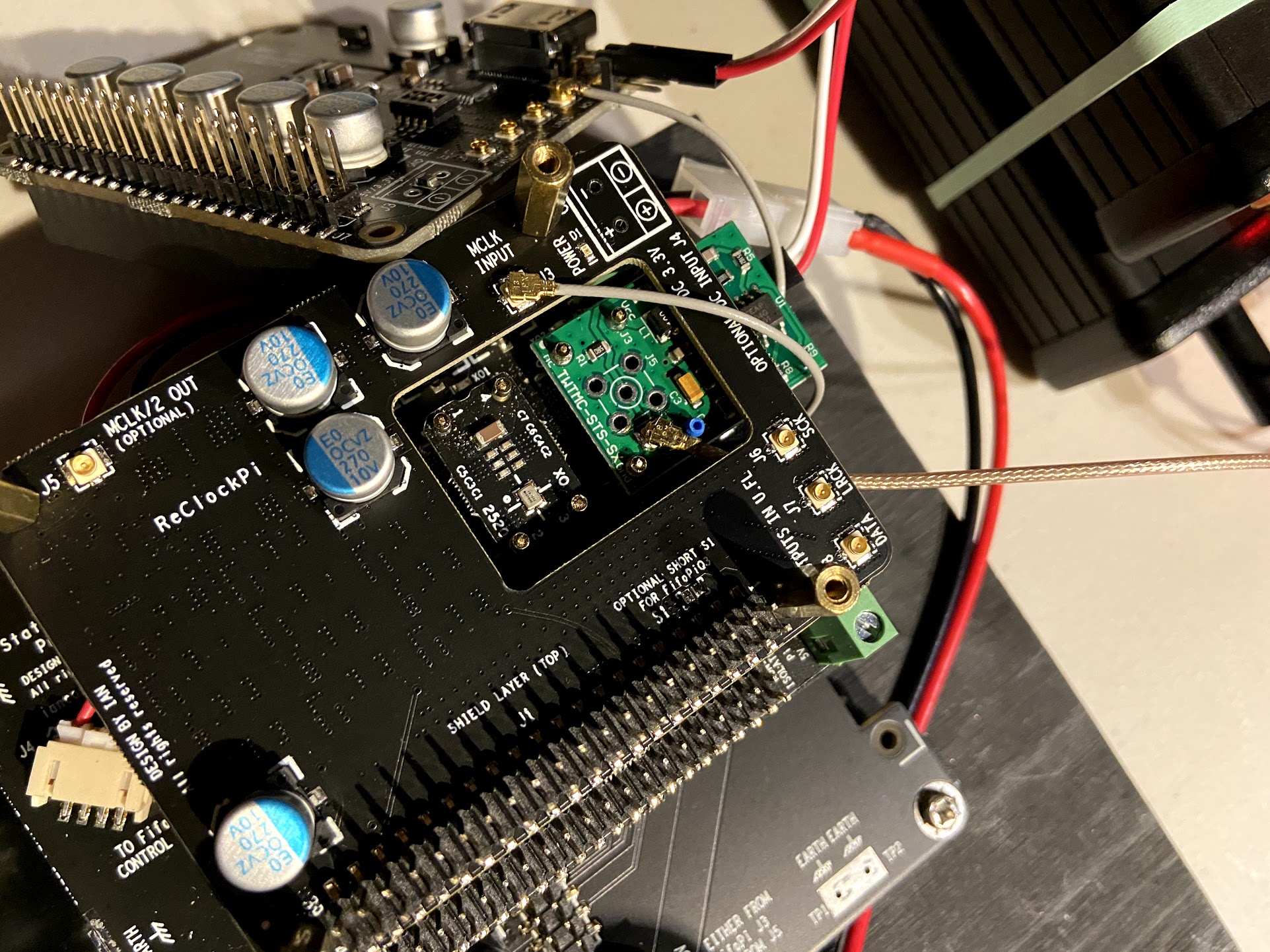

Just finished to mod my all-in-one player to become a pure transporter. By Ian’ s latest ReclockPi and StationPi, sound quality is amazing good I never heard before! Thanks Ian 🙂

@casshan
Very nice implement. Congratulations!
What R-2R DAC you are using? How do you like the sound quality? And what's the case?
I still haven't fixed the Class D clock. I'll give another try soon. Just want to get it compared with the TWTMC clocks.
Ian

The red PCB board is R2R DAC from China, it claims it accept PCM 384K and DSD 512 but I always hear some high frequency noise when I play music with HQP + Roon, very annoying... Eventually I decided to make the player to become a pure transporter so I bought some components from you before. I am using Holo Spring 2 DAC with I2S input. The sound is very very good, as Stereophile said: it may be the end-game of DAC, and all music sound non-digital. The DAC is borrowed from my friend. I may buy the latest Holo MAY DAC which is the current flagship DAC of Holo audio, sound is no doubt very good too.

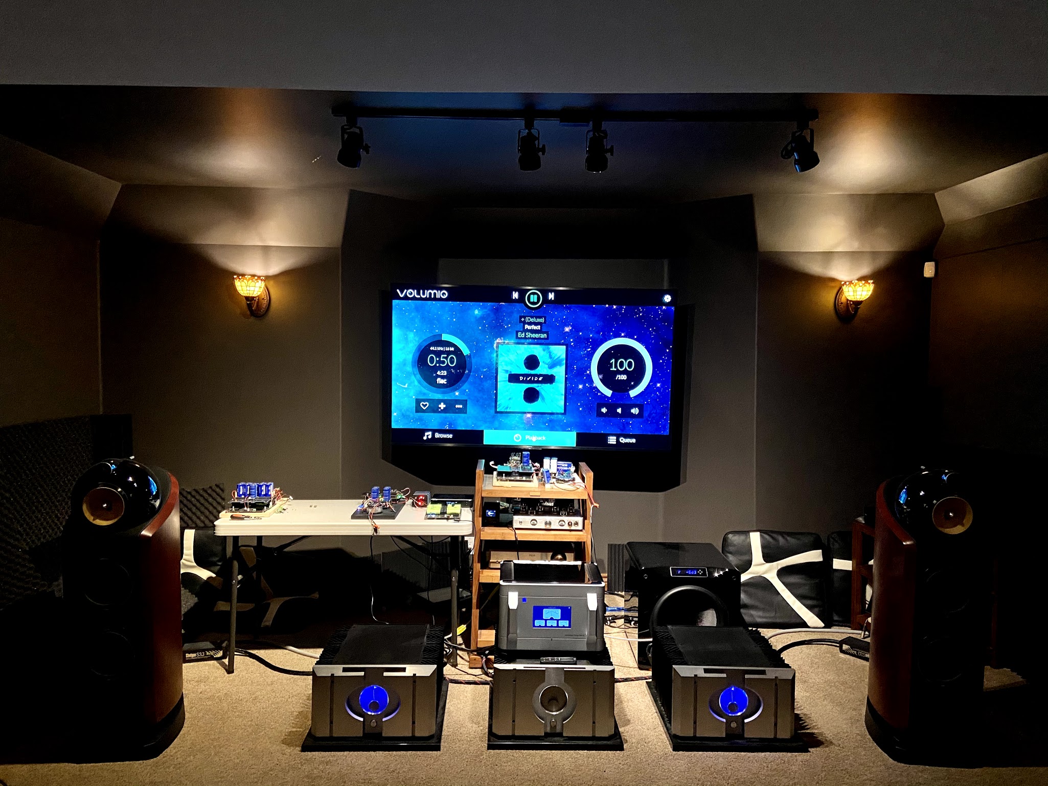

Unless you know the sound '' preferences '', the gear and the room of the '' reviewing '' person you should use the information give more like a kind of guidance to what to expect if you make a similar change in your system.
AND it could well be that if you would use Ian's systems to find out where to go( because your are living in the same hood), copy the complete digital daisy chain to connected to your headphone only set using a single ended 2A3 Will it be perfect?
Of course Ian's set has a big reflecting screen between his loudspeakers and it looks like he needs powerful amps. A direct coupled 2A3 amp will have two tubes , a few resistors, some iron, some caps much easier to create a nice sound i think.
