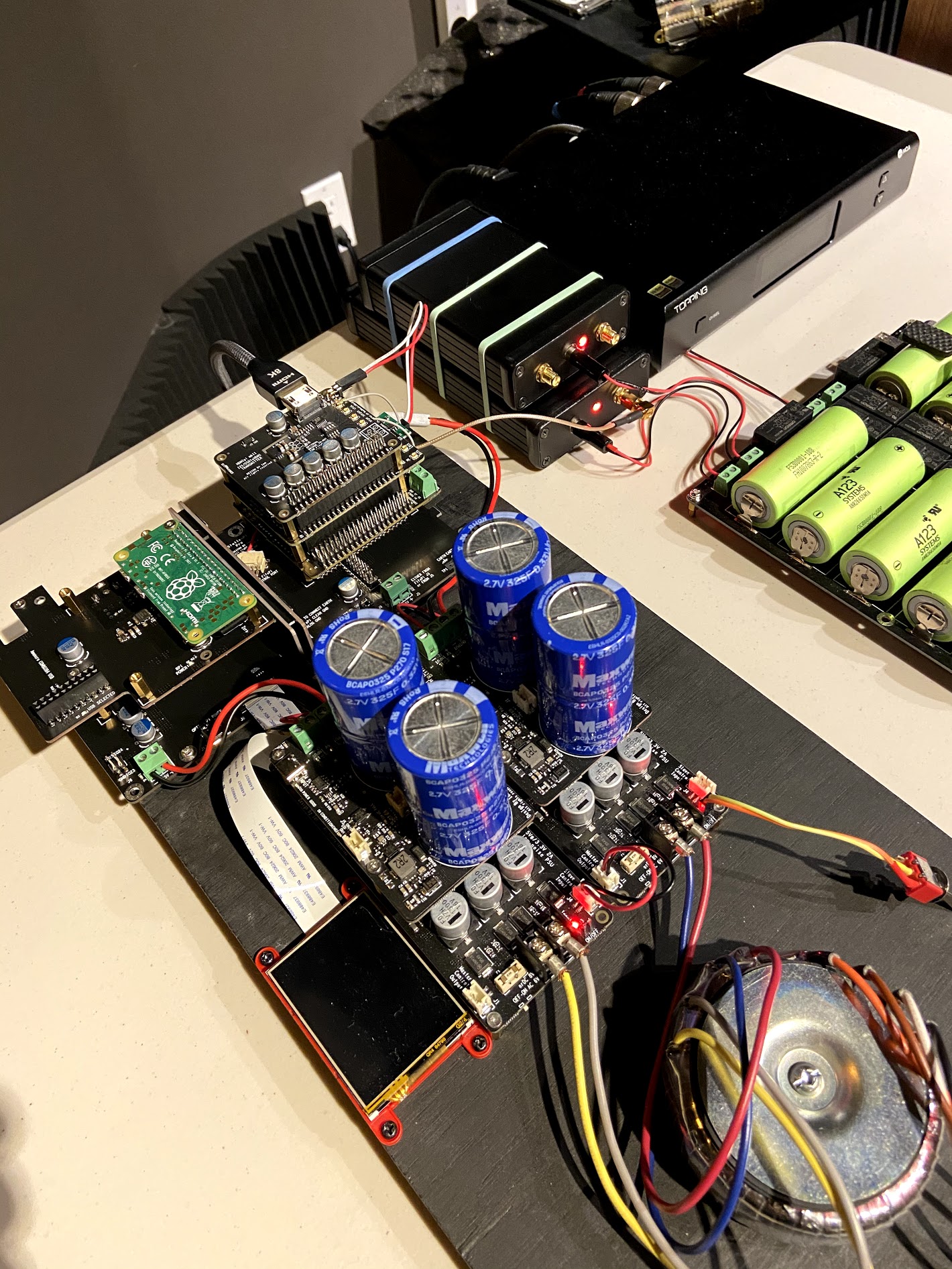

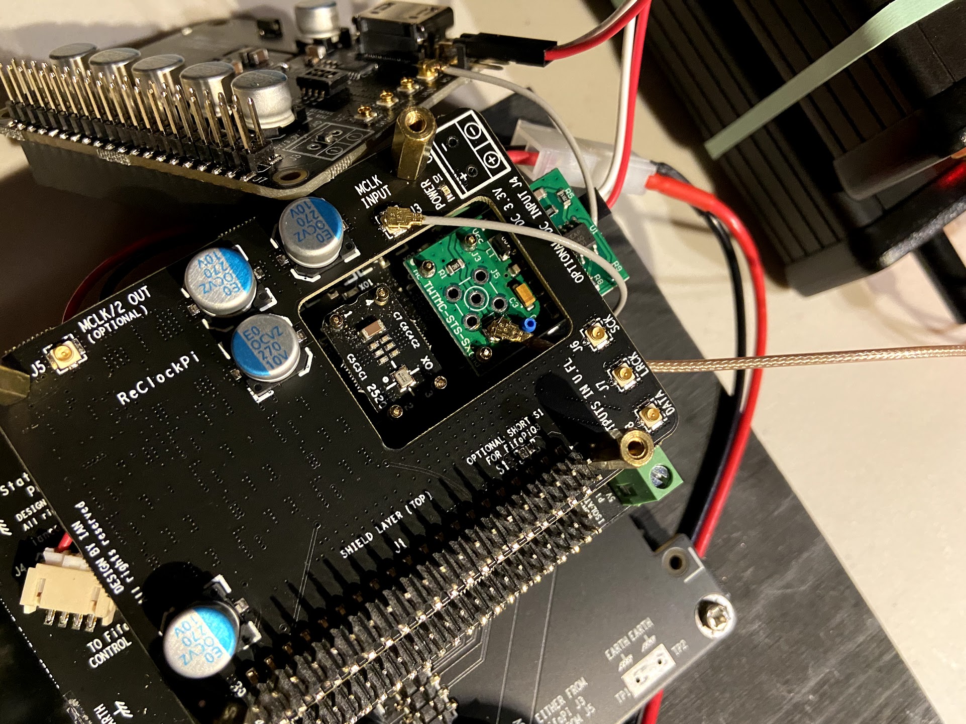

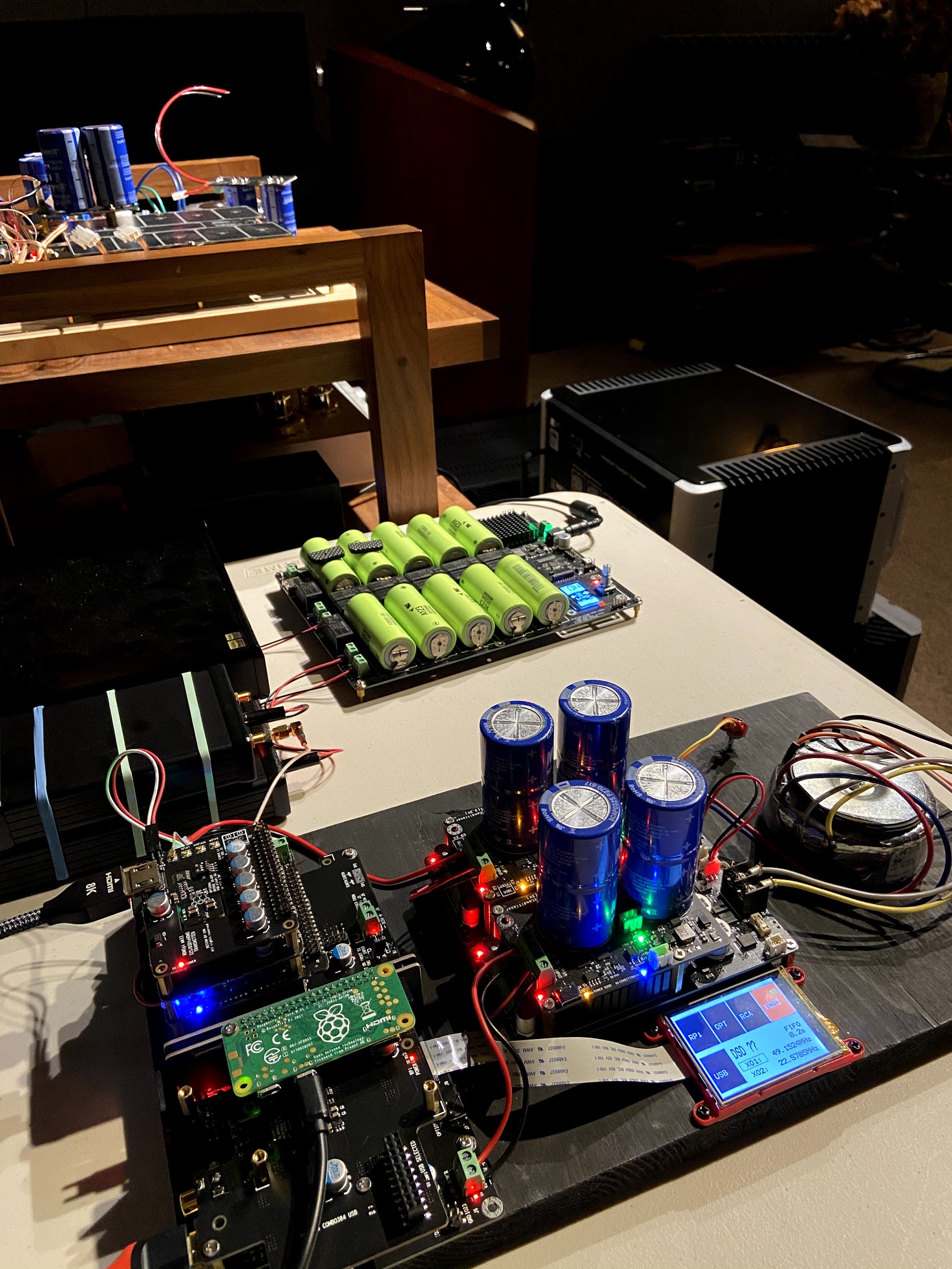

Trying to get the most out of TWTMC clocks for FifoPi system (1)
Just to get round to start testing the TWTMC clocks
My setups
Clock section:
1. TWTMC DIRXO 22.5792MHz
2. LifePO4 13.2V pure battery power supply
Fifo Section:
1. FifoPi Q3
2. TWTMC-STS- SX sine to square convertor
3. ReClockPi
4. HDMIpi II
Source section:
1. StationPi Pro
2. ReceiverPi MKII
3. RaspberryPi Z/W
Power supply section:
1. LinearPi Dual 5V+3.3V
2. UcConditioner 5V
3. UcConditioner 3.3V
All power supplies are controlled under the same ON/OFF signal by connecting isolated control cables in between
DAC section:
Topping D90 AK4499 DAC with HDMI I2S/DSD input
D90 setups:
1. Change setting 8 to REV
2. Chang setting 9 to DSDR/DATA
3. Also have to enable FifoPi’s 16 to 32 lossless converter function by setting SW2 to On because D90 doesn’t support true 16 bit format.
To make things easier, I use a signal TWTMC DIRXO setup just for test for now.
