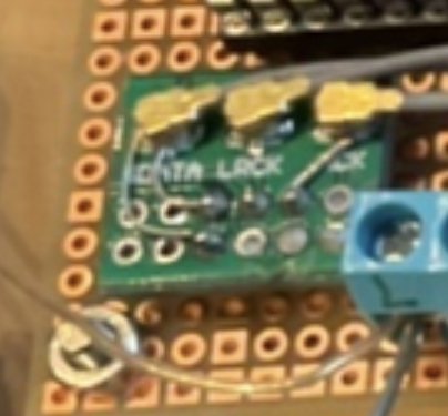

Where did you get this? [emoji4]View attachment 950823
I destroyed a gpio to i2s header for a raspberry pi. If anyone has a source for conversion pcb’s of U.FL. I am interested 😉
just looking at the photos i reckon you can improve by a lot by properly doing a pcb for the tda...
that chip deserves far better layout 🙂
Yes it does. This is my first attempt for a TDA dac, so please be gentle on me 🥴, however this layout is not too bad, all dem smd capacitors are below the chip attached to a ground plane copper strip.
But you can relax; today my Pcb’s of distinction 3 dac and i2s-simultanous conversion boards have arrived. So next week I can probably report how bad my perfboard is in comparison😉

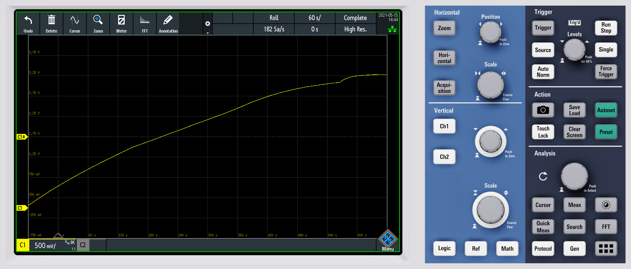

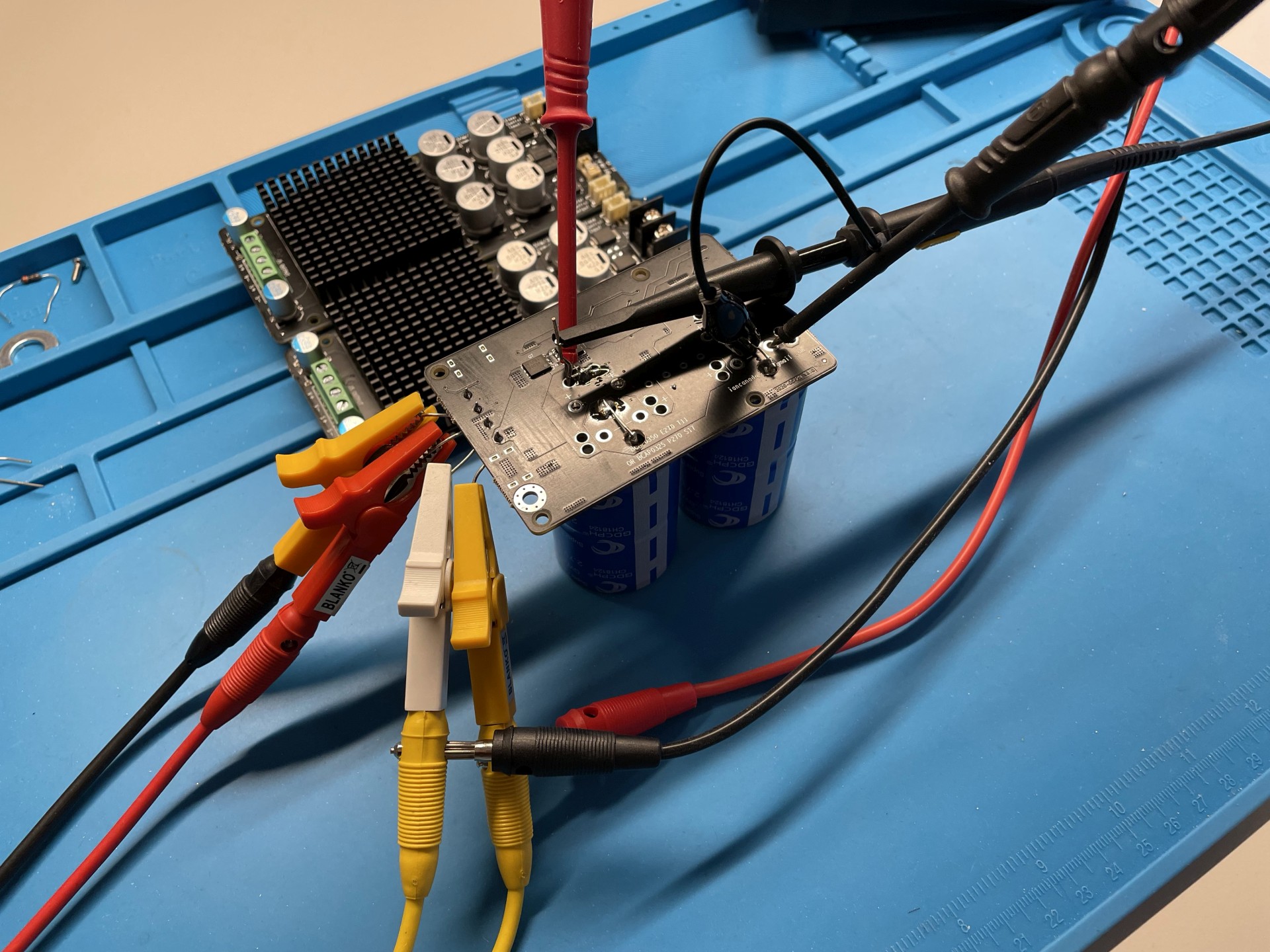

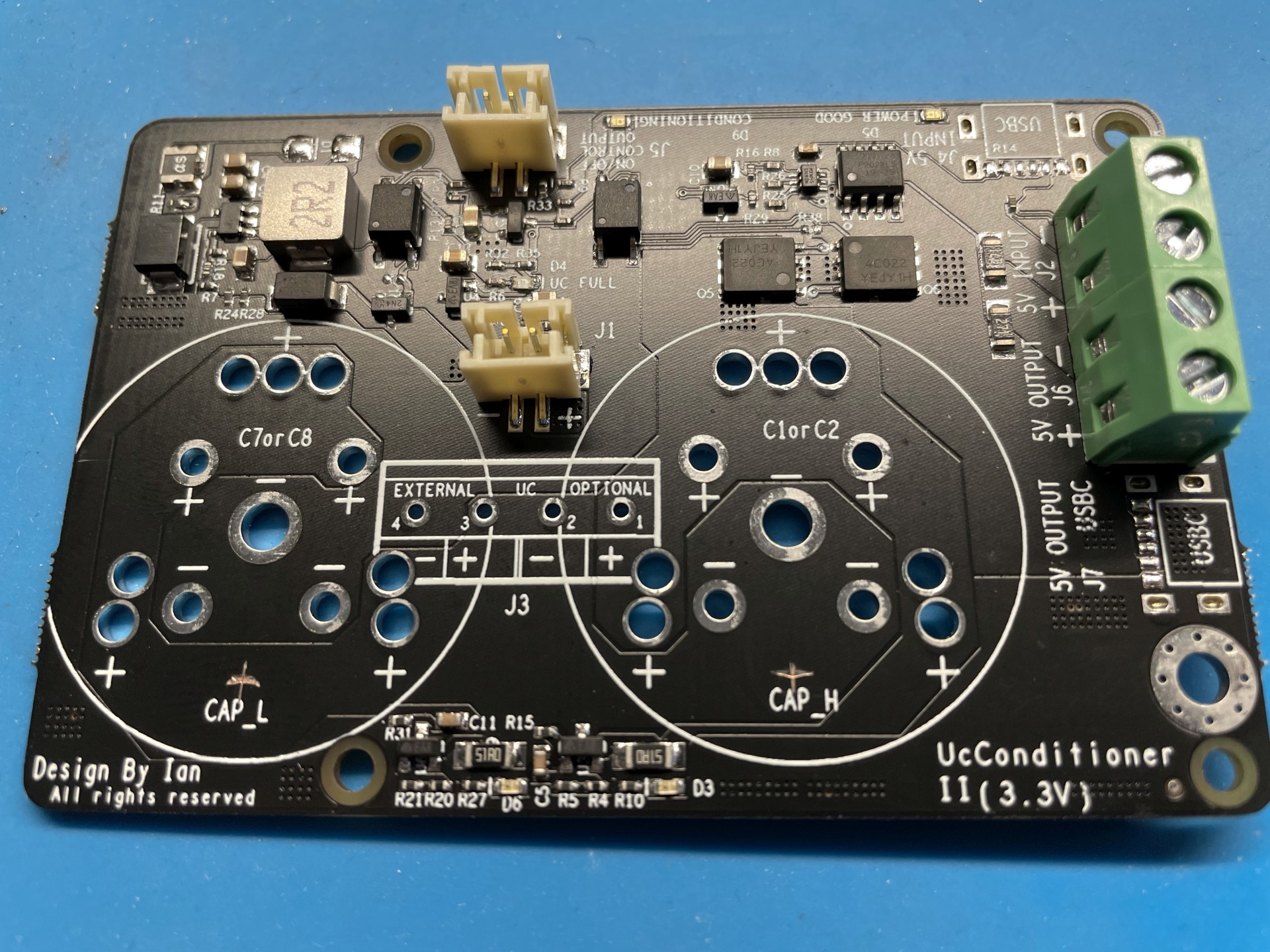

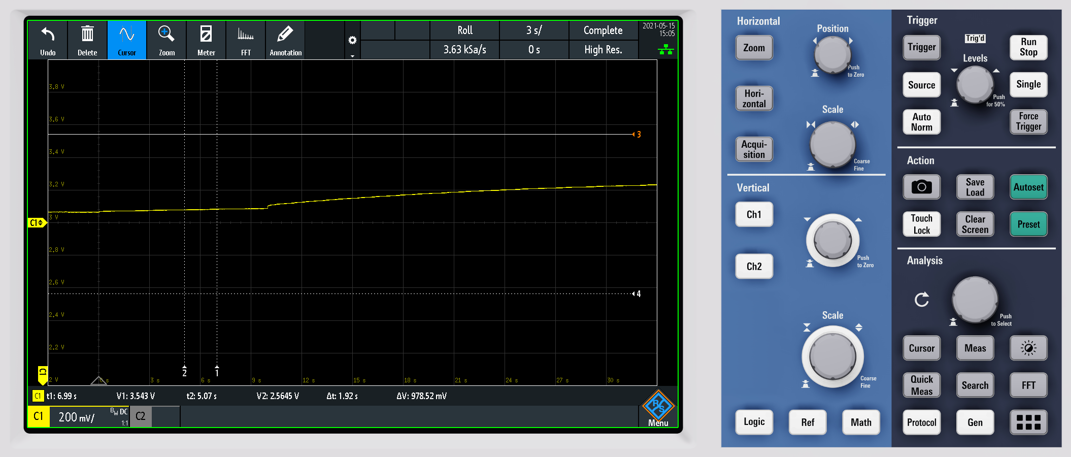

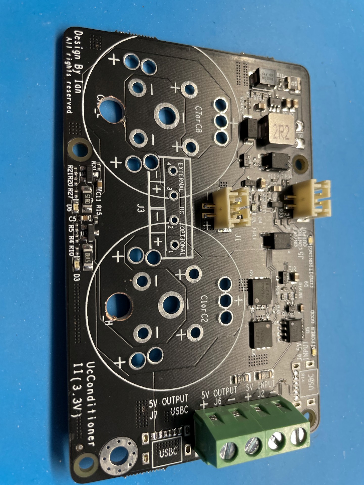

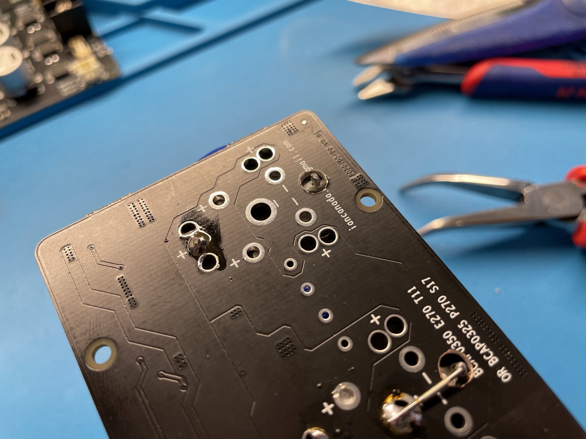

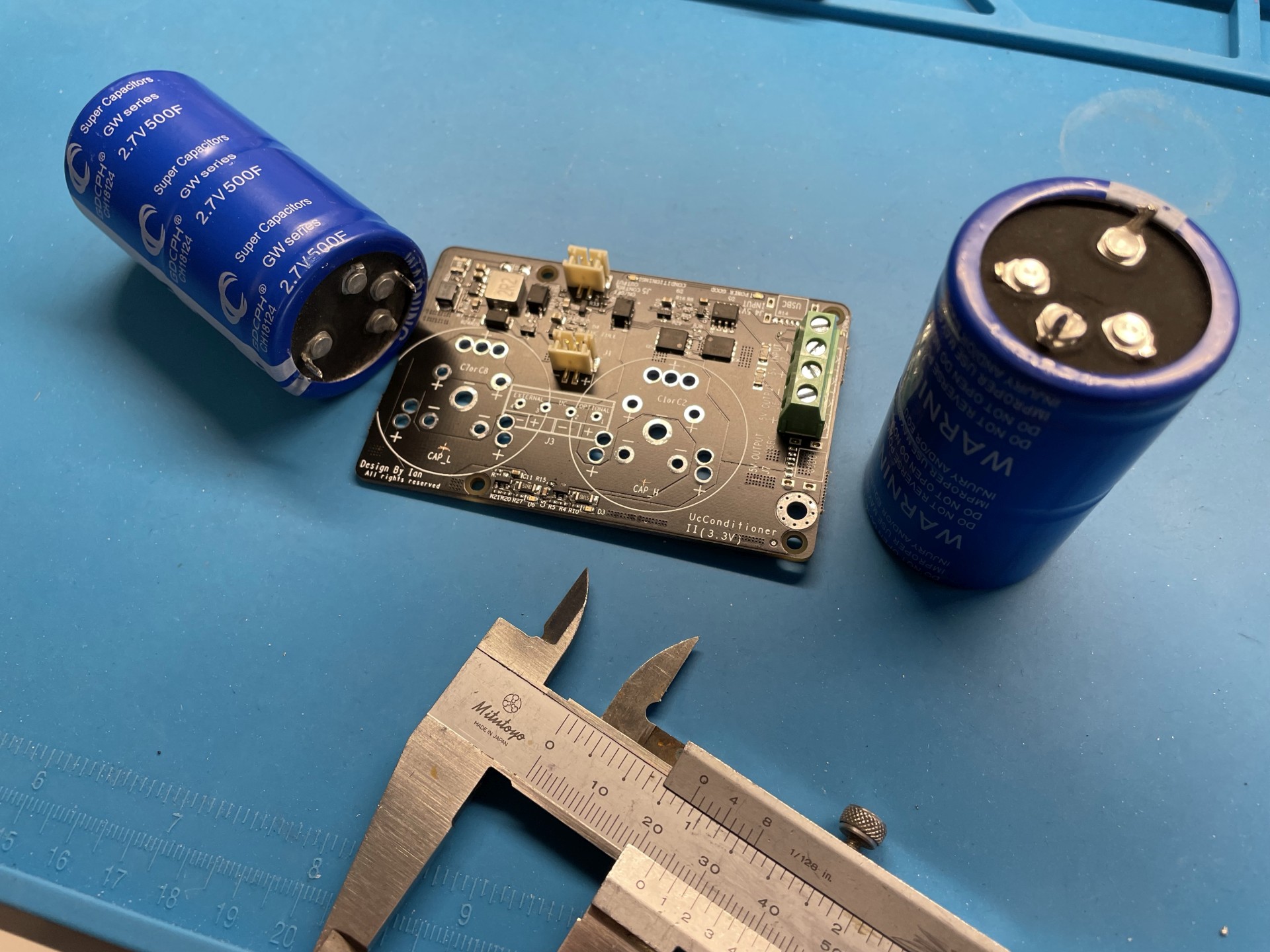

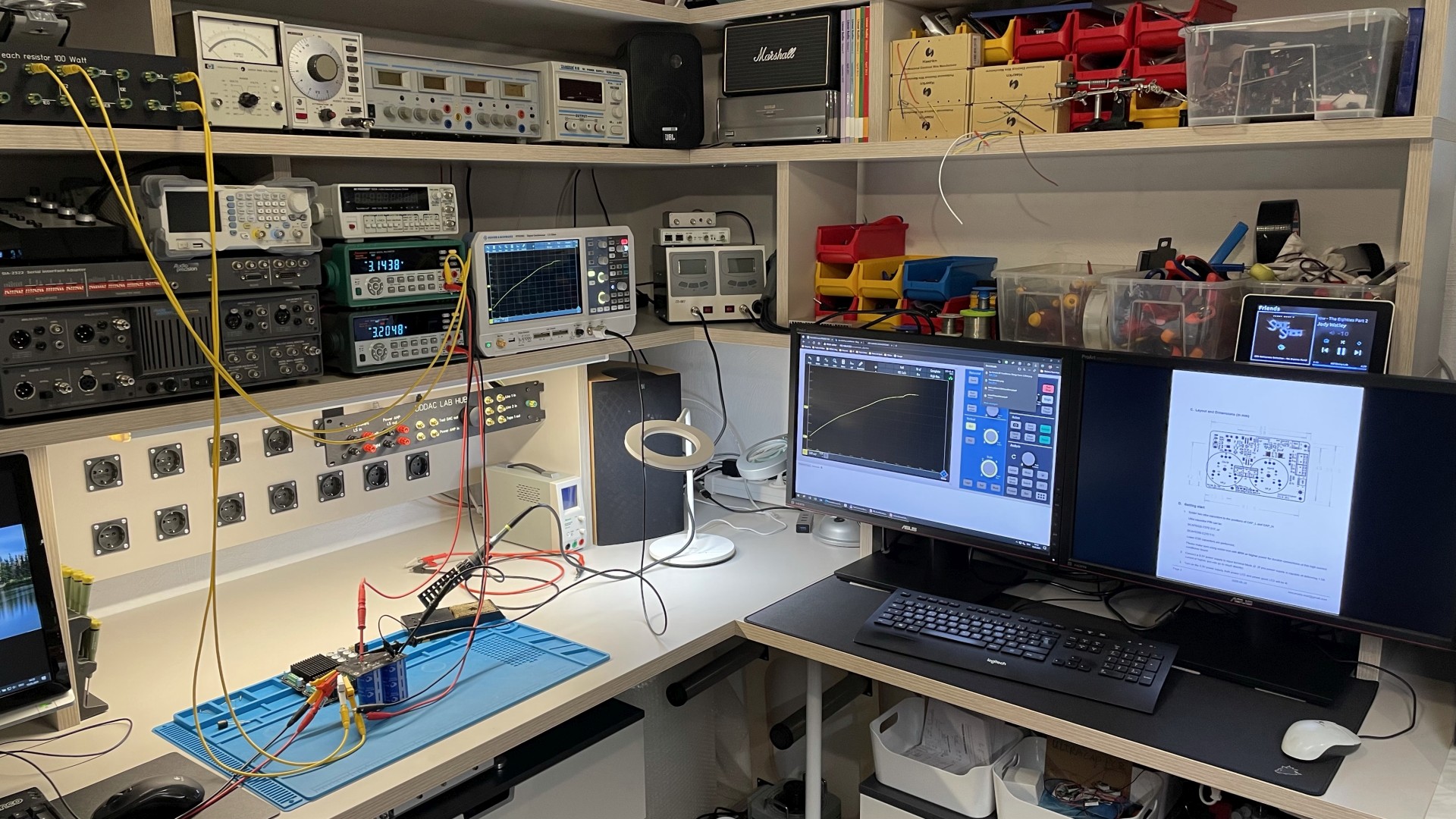

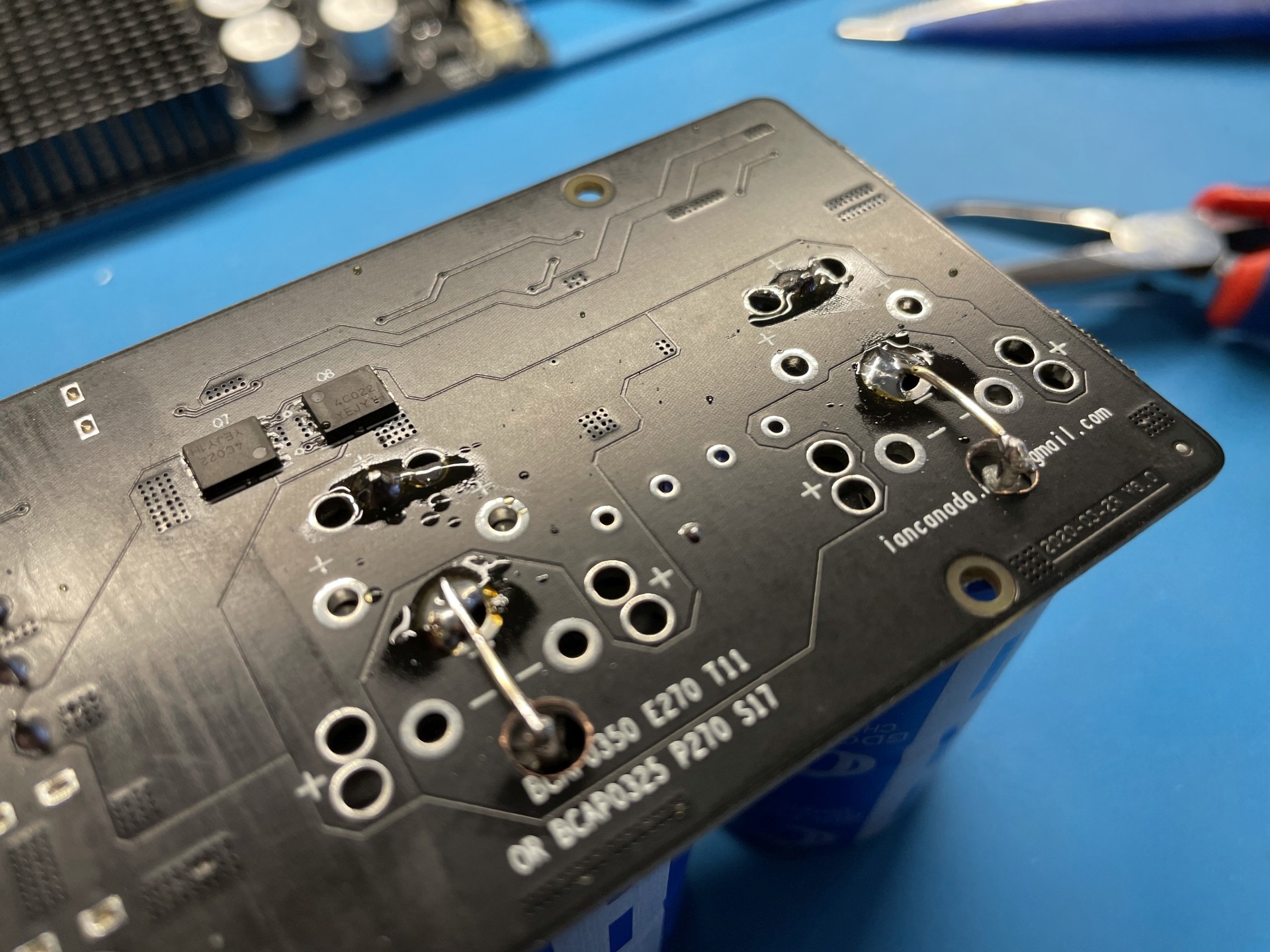

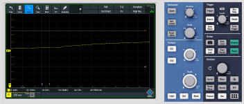

I ordered some stuff from Ian to add to my DDDAC/Andrea clock test setup with the FiFoPi. Also his linearPi with the UC Conditioner boards. I had some Ultracaps from AliExpress lying around. 😱 Pity they did not fit 🙄
So we had to fix this ! see images. speak for them self I guess. Please if doing this be VERY careful, the plus and minus are opposite board sides with one UC cap 😱

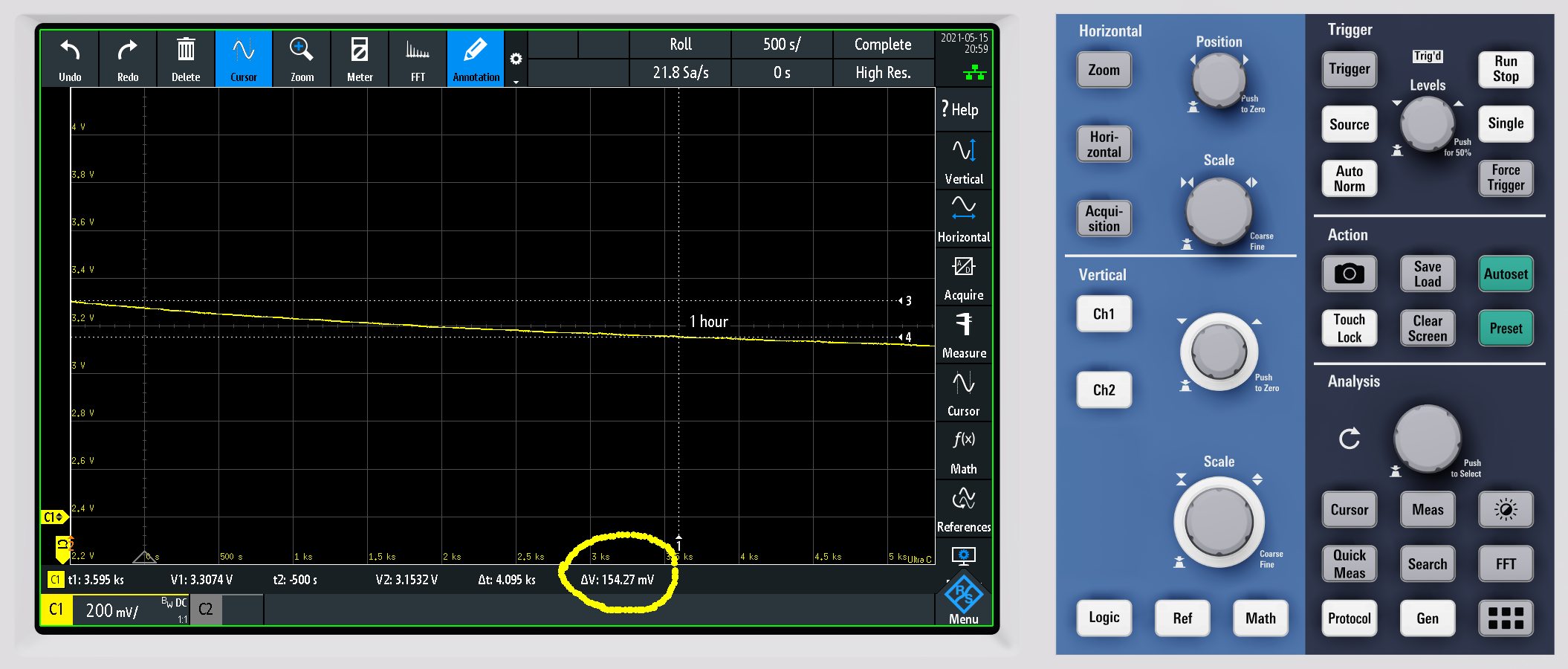

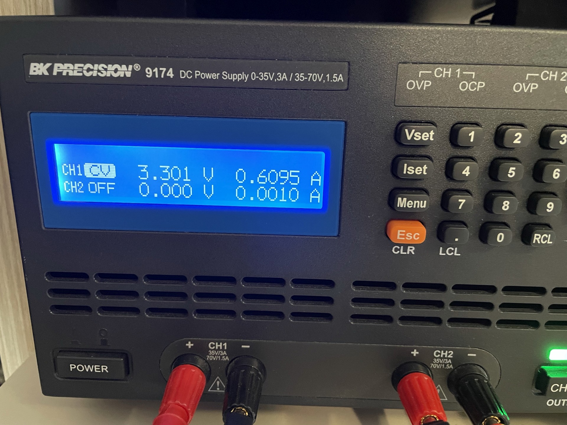

Other pics show the charging of the Ultracaps it self: It takes roughly 10 minutes as you can see and charge current is roughly between 0.5 and 1 Ampere. Slowly getting more and more as voltage rises.
You can also see clearly the jump in the plot at a level of 3.1 Volt: the UltraCap is just switched onto the power supply just like that. This causes a short moment current charge peak. My LAB supply blocked it in CC of course. Most power supplies will be able to deliver a short peak. Unless they have a fuse or electronic shut down. Just saying...

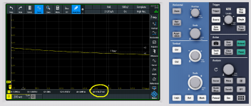

When the UC is switched off, the UltraCap is disconnected and self-discharges - see other picture. in one hour 150mV or so. After 12 hours 2,75V was left. So when switching back like "the next day" or so it probably will be a bit round 2,5 Volts and the charge time will be only 3-4 minutes
just wanted to share this - not sure if the right thread, but hopefully close enough as this Ian Canada's stuff 😎

I could not post > 10 pictures so here are the plots of the charging :

@DDDAC
Very nice laboratory, you did a good job on testing the UcConditioner.
UcConditioner has a pretty complicated analog logic. Seems it's working properly.
Ultra capacitors are very special. It behavers like short circuit when it's empty or at low voltage. When it's fully charged, it will become a shunt element. That's reason I design the UcConditioner.
Using a high current ultra capacitors directly in the circuit would be very very dangerous.
When I use a pair of Maxwell 325F UCs, it normally takes 20 minutes to get a fully charge from empty. And after powering off for 24 hours, it takes less than 10 seconds going to conditioning mode at power on. The 24 hours standby voltage drop normally less than 150mV.
I have never used the ultra capacitors in your test. But I see some possible issues:
1. I think it could have higher leakage current.
2. The capacitance could not reach 500F.
2. The actual working voltage could be less then 2.7V.
If it is possible, I would suggest to test the ultra capacitors themselves. Please let me know if you have a update.
Thanks again for good job on testing the UcConditioner.
BTW, what's the AP your are using?
Good weekend.
Ian

@IAN
Thanks for the reply. Your observation is correct, these are mega cheap things, but interestingly enough, their impedance is low as a shunt up to a few 100kHz and the great thing of ultra cap is of course that that is the case at low frequencies, where common 4.700 uF is far away from a shunt function.
Yes, their capacity I measured as max 300F and their leakage is indeed high. Still they sounded ok. So mission completed for first test.
I like to experiment a lot and just cannot or will afford always top the bill components with over the top prices. When it sounds great, I normally open the wallet and buy the better stuff and put that inside my own gear….
Let’s put it this way, if it works with “poor quality” components it will for sure with top of the bill.
The AP is a 2223 system two with the SIA extension…. So I can do Bode plot sweeps with a signal generator outputting I2S signal… 😎

Will report back next day what the leakage of the Nichicons is
The Nichicons balance much better then the AliExpress ones....
after fully charging the UC 5 Volt :
2,49V
2,43V
To be honest I would not like to try the 5 Volt UCC with the chinese ones if balance:
After fully charged again to 3.3 Volt this was left after half an hour so
1,77V
1,44V
Not sure if this can be extrapolated, but assuming so, in the 5 volt unit this would be
2,76V
2,24V
on the 2,76V one that is a bit over the spec of 2.7 V. This will make lifetime shorter and leakage will increase.
As said would not feel too safe about this

I have to ask: Do you have any suggestions if I wanted to add this reclock stage to a McFIFO / McDualXO ... or do you have plans for a separate add-on board for the McFIFO series?
PS Just noticed that sibilance reduced on a tricky track - thank you again!!
@Crom,
Thank for the update.
I'm glad ReClockPi works for you. Congratulations!
I don't have a plan making a McReClockPi for McFifo/McDualXO, but I believe you can use current stereo ReClockPi.
You just need an GPIO I2S/DSD input adapter with u.fl connectors for ReClockPi to connect to the McDualXO outputs. That's all you need to do.
Ian
I2S_ipunt_adapter_GPIO1.1 by Ian, on Flickr
Ian
