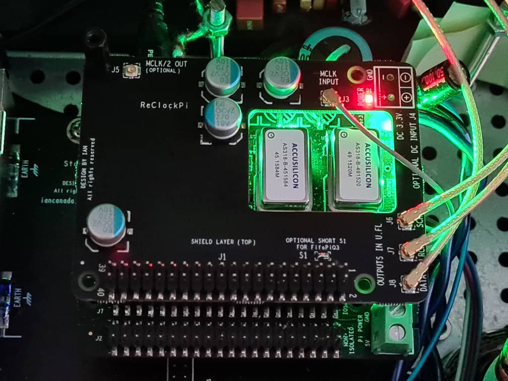

Asynchronous I2S FIFO project, an ultimate weapon to fight the jitter
It's werking perfectly.
Difference immediately noticeable.
Now with clean 3.3v of the fifopi q2.
Later on it will get separate power.
Thanks Ian for the good work.
Sitting on stationpi, recriverpi, fifopi q2, reclockpi feeding tda2541a s1
All separate power supplies.
Ad.View attachment 950751
@advr
You are welcome.
Your implement looks awesome. Very well built system.
Good luck to your project.
Ian

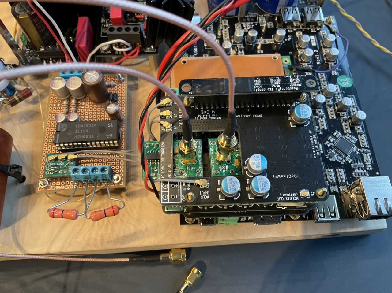

It may be as simple as mixing up some U.FL cables. Every PCB uses a different label for each signal.
That could be, as I also had to rearrange the u.fl cables from fifopi to the reclockpi.
Take one step at the time. Think logical. Follow the path.

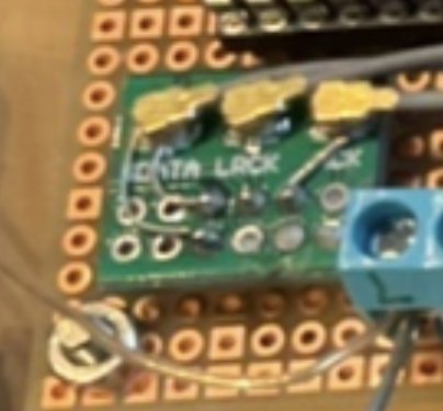

Thanks advr. Those are words of wisdom to live by. And I appreciate the encouragement. At times like this it takes discipline. It was working perfectly. Put in Reclock Pi and nothing... silence.
Ian's I2StoPCM is helpful in that it will indicate when it has a valid I2S datastream. With every one of 50 tests the software and the I2StoPCM looks like it is working properly and playing music. But no sound...
So far I have:
Replaced all U.FL cables
Double checked all voltages at all test points right out to 1541a pins
Checked for shorts and dem cap values across the 1541a pcb
replaced all U.FL cables
Replaced the 1541a chip
replaced the WTMC with the original test clock
Removed ReclockPi and went back to FIFO-I2StoPCM-TDA1541a. Here I got finally got music but highly distorted. It plays at the correct speed, but it is just really badly garbled. I have stepped away from it to get a fresh start.
This one is a head scratcher. My current thinking is one of two issues:
I have fairly long U.FL cables from I2StoPCM at 6.3". Perhaps it cannot drive that distance?, or
Perhaps I briefly misaligned the pins when installing Reclockpi and pooched FIFO.
