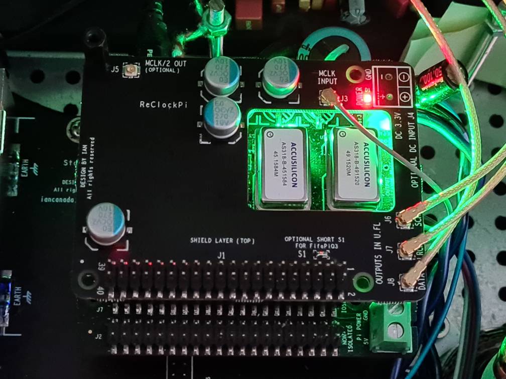

I bought the new FifoPi Q3 board and I am using AS318B Femto Clocks (90M & 98M) with it. As a Dac board I use the
ES9038Q2 as Dac. And on top of it I installed the GPIO terminator KIT. I put the DAC in sync mode as described in the manual:
1. Installing a FifoPi between the RaspberryPi and the 9038Q2MPi DAC (see FifoPi user’s manual for installation and configuration details).
2. Installing a pair of really nice clocks into the FifoPi according to your personal preference. The quality of these clocks is very important to the sound quality and sonic signature.
3. Connecting the MCLK signal from the FifoPi to J6 on the 9038Q2MPi using a u.fl coaxial cable. Cable length should be as short as possible.
4. Setting pin1 of jumper switch S2 to ‘ON’ position.
5. Setting DPLL bandwidth to lowest level 1 for both PCM and DSD in the ESS Controller, at the "DPLL Bandwidth' setting panel (see ESS Controller manual for configuration details).
6. Power up and enjoy the music.
But now whenever I play a DSD source after a short while the right channel gets distorted. Only when setting the bandwith to 5 instead of 1 there is no distortion. With the 'old' FifoPi v1 board DSD sources played fine with the GPIO terminator kit. What has changed in the FifoPi Q3 board so that I no longer can play DSD files with the DPLL Bandwith for DSD set to 1?

Q3 uses higher speed drivers for lower jitter with faster rising edges. The signal strength and driving current could be higher then Q1. Maybe you need to change the Terminator board resistor values to match.
Please try ReClockPi for a much better I2S/DSD signal quality.
I myself use the FifoPi Q3 + ReClockPi combination with 90/98 MHz XOs everyday. I have no any problem playing DSD at bandwidth 1.
Regsards,
Ian

ReClockPi has yielded a very nice improvement in my system Ian. I’m using Pi >> FifoPi (Pulsar clock) >> ReClockPi into a 4-board DDDAC. It has exceeded my expectations and there’s a clear difference going back to just FifoPi.

That's a great news.
ReClockPi improves the I2S/DSD signal quality. That was clearly shown in the measurement result in the user's manual.
DocumentDownload/ReClockPi at master * iancanada/DocumentDownload * GitHub
DAC's like DDDAC that are very sensitive the the I2S signal quality will be benefited a lot from ReClockPi.
My ES9038Q2M Dual Mono DAC even got better sound quality after RCP was installed. I believe it was because of the lower I2S/DSD signal noise.
Good luck to your project.
Ian
