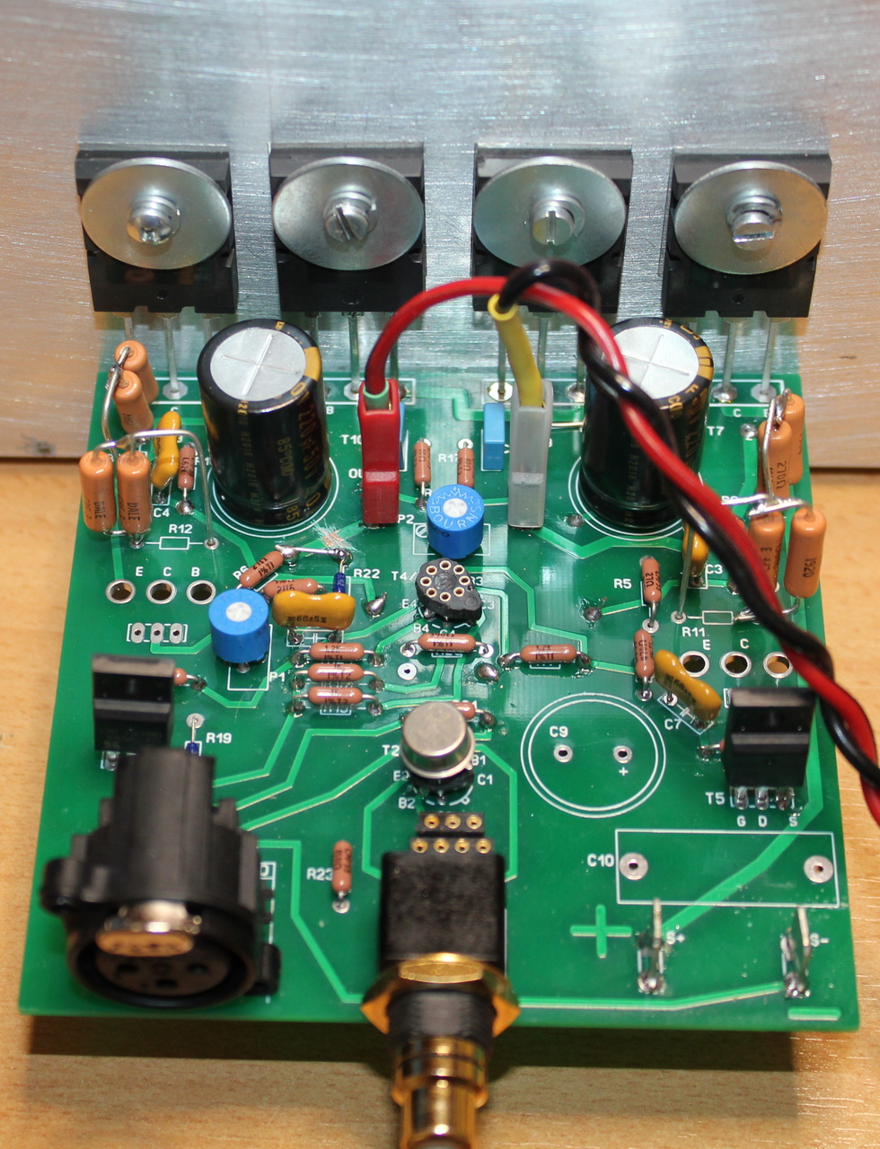

Hello!
I have RPi4 + FifoPi + ES9038Q2MDualMono + LL1544A TransformerIV with 510 Ohm
It works well with the my current amplifier with RCA input.
The problem:
I finished a test version of a new symmetrical DIY A class amp and it has both RCA and XLR input also.
If using the RCA input, the volume is normal and acceptable but from XLR is very-very quiet.
Any idea?
Maybe necessary the schematic of amp:
and looks like:
Thank you in anticipation
Gyuri

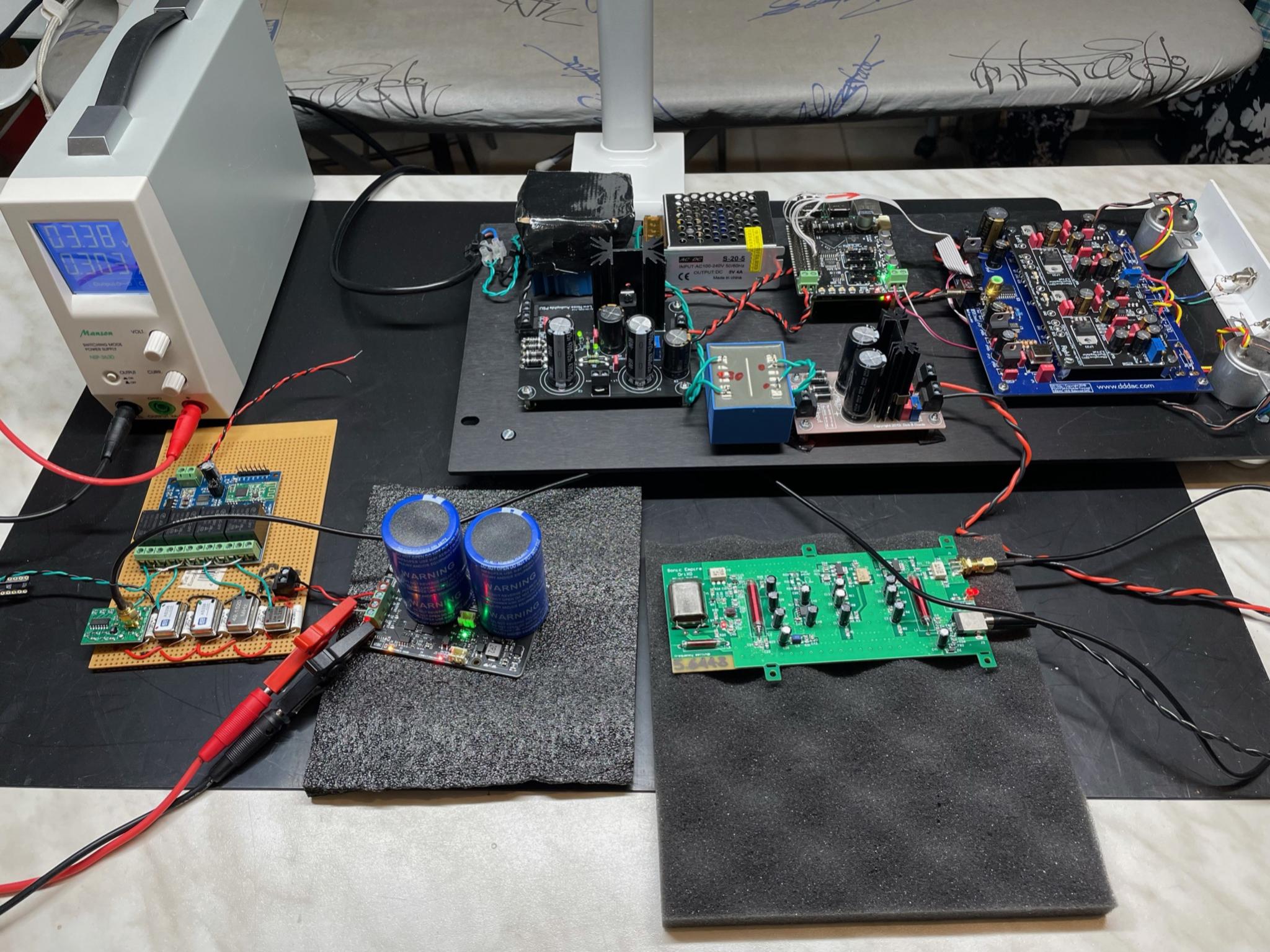

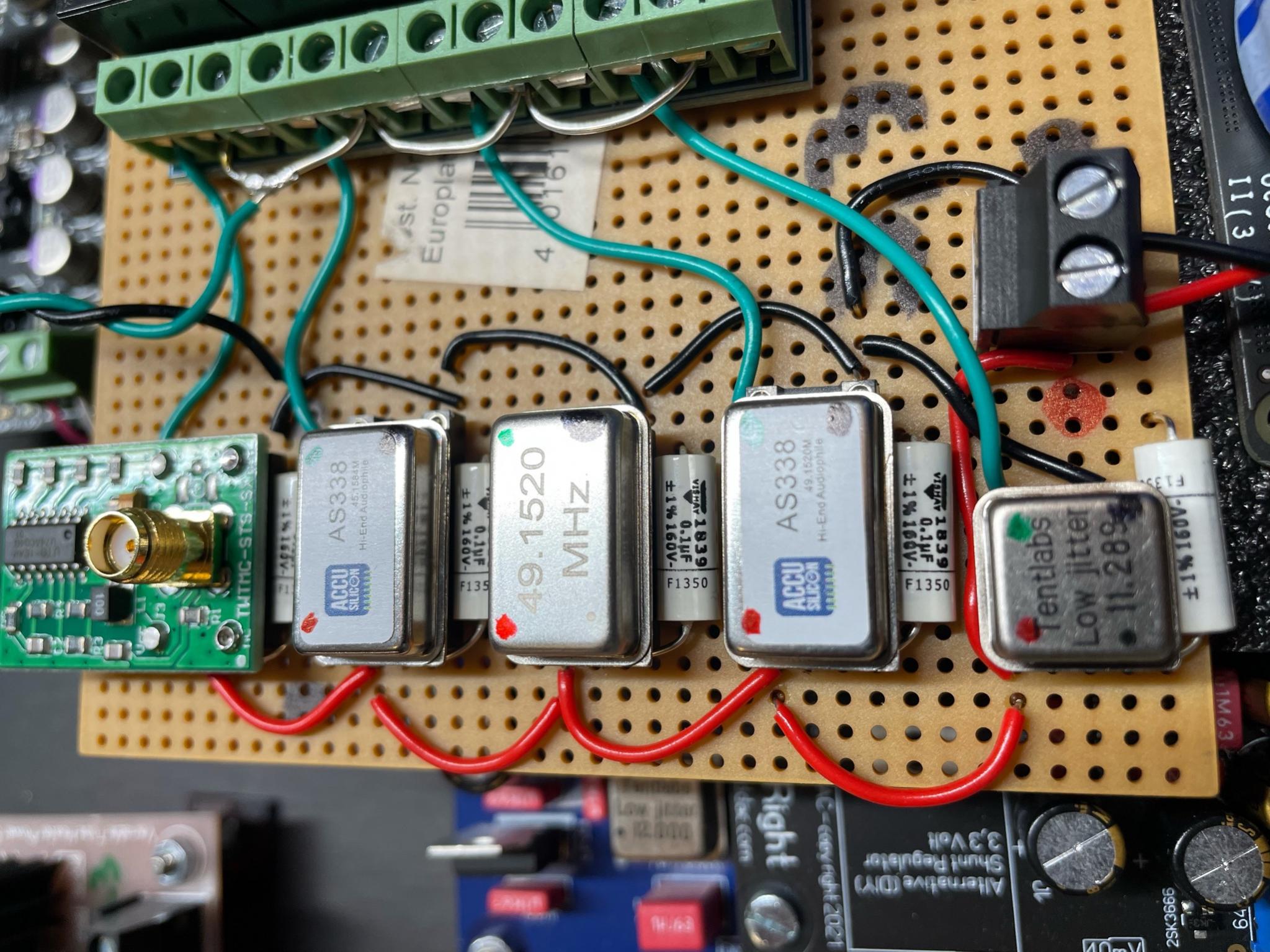

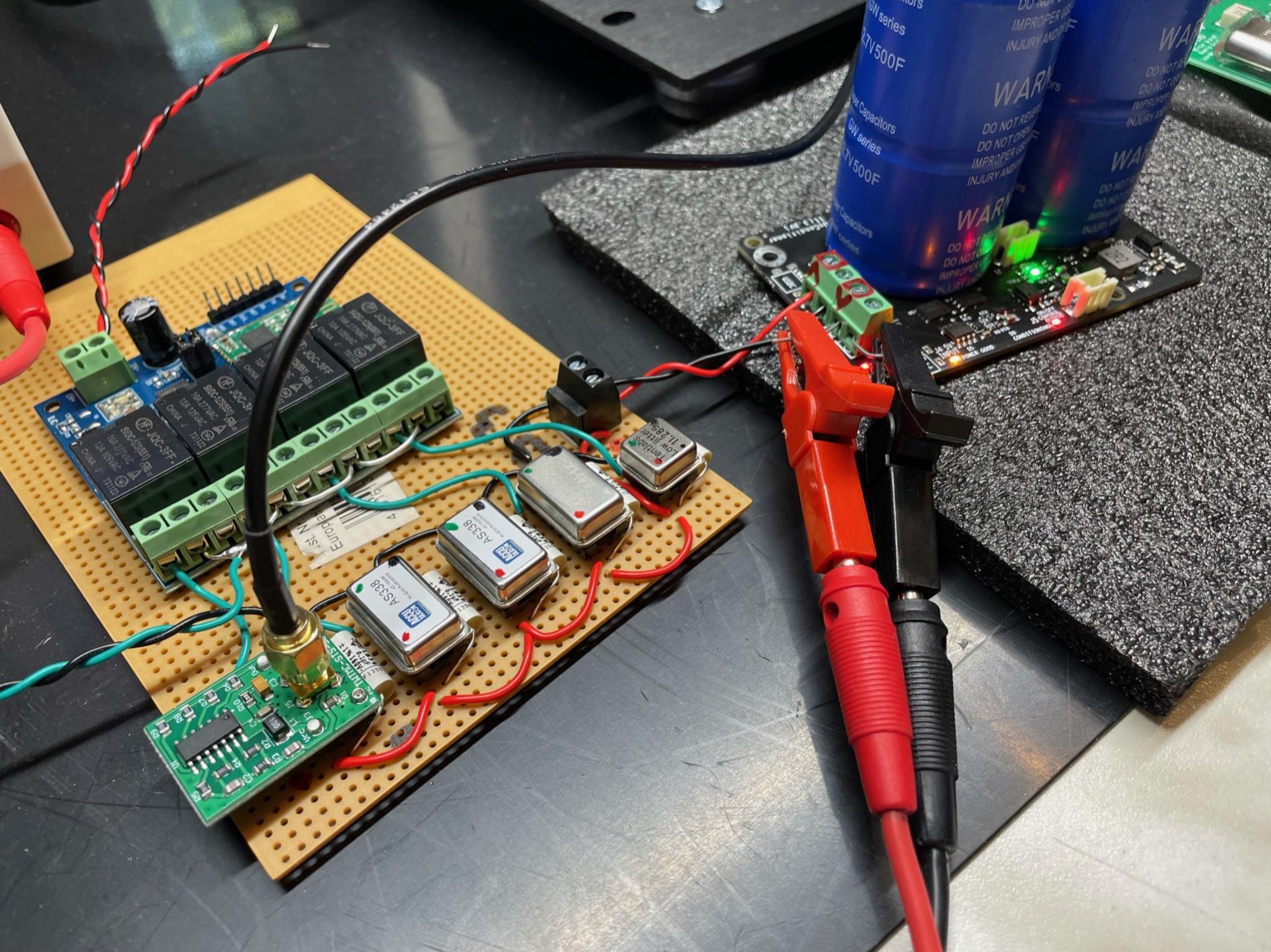

Thanks Ian, for continued investigation on how to get the best clock solution for the FiFoPi. Looking forward to your ideas and observations.
In the meantime, I got my Accusilicon 338 series. I will do testing soon after they are a few days on power….
To make sure, when comparing clocks, all clocks are „warm“, I needed to make a small solution. See the pics…. It is like a clock warm keeper and the Bluetooth selector will enable real A_B switching from the listening position (smartphone app controls the 4 relays) - so 4 clocks can be compared all at once without any clock being unpowered ….
I am using your UC-conditioner and linear pi for the testing….
Will report back my view of things
Any idea?
Just a thought:
Is the XLR signal ground referenced at the source end? Is the source a transformer? If so, is secondary winding center tap grounded?
Also, do you have a scope?

Wow, that's a cool setup !
i´m looking to your testing....

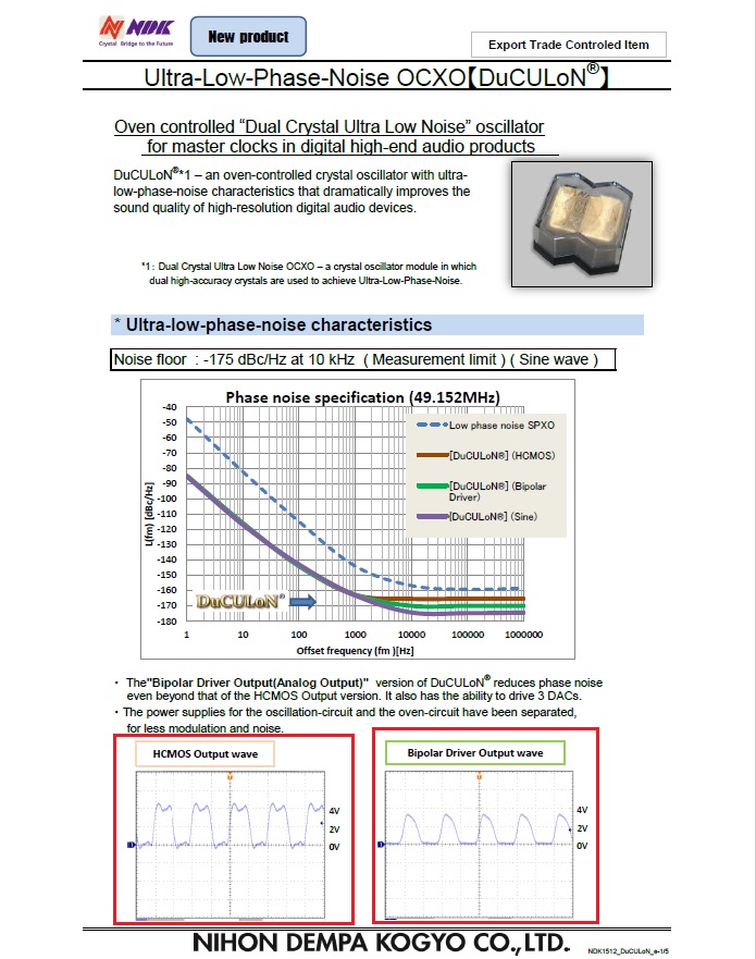

Hi Ian,
every kind of DAC (R2R or delta-sigma) switches on the edges of the clock and not on the upper or lower steady state of the square wave.
So the ringing does not matter unless it creates meta-stability, that's not the case.
Unless they are too slow the rising and falling time of the clock don't affect the digital to analog conversion.
As I already said what really matters is the fluctuation of the time interval between the edges, which creates the jitter.
Unfortunately the beauty of the wave form does not improve jitter.
Just to confirm that beauty of the waveform and crazy speed rising and falling edge don't matter I attach the first page of the NDK DuCuLon OCXO datasheet.
The picture at the bottom-left of the page is the HCMOS Output wave of the OCXO, the same output type of the STS.
It has ringing and bounce and looks very similar to the one of the STS.
The picture at the bottom-right of the page is the Bipolar Driver Output wave of the OCXO wich performs a little better in the phase noise plot published by NDK.
The slope of the edges are very inclined therefore rising and falling time are very long.
This OCXO was especially design for audio by one of the most important company of the market and it's priced around USD 1600.
As you can see they didn't care much about the beauty and the edge speed of the waveform although the oscillator was designed specifically for audio applications.
Sorry to repeat again but you are using a tool suitable for measuring the jitter with an integration bandwidth useful for telecommunication applications, with a time base probably worse than the DUT you are measuring.
There is no way to overcome this limitation in software because your digital oscilloscope does not use cross correlation to do the math.
So, as I have said several times, likely you are measuring the noise floor affected from the noise of your tool.
That's the reason why even NDK has published the phase noise plot measured by a suitable tool like a phase noise analyzer, rather than the jitter captured by a digital oscilloscope..
If you would perform accurate measurements I would suggest to buy a phase noise analyzer like the Microsemi 5120A or the Aeroflex PN9000 which there are the cheapest tools for this, although I believe they are priced 25-30000 USD for a new one.
You could look for a used one, or maybe you could build yourself the Holme project to save thousands USD, I believe you can build it with less than 2000 USD.
Andrea
