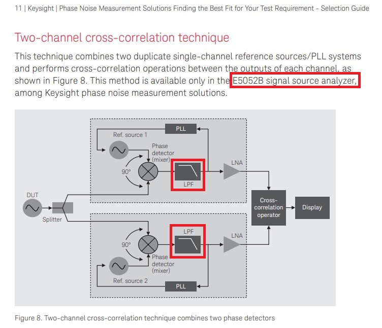

the Timepod has a 27 MHz low pass filter wich does not affects phase noise/jitter measurements.
Just like the Agilent E5052B phase noise analysis tool as you can see in the block diagram of the instrument.
It has LPF at its inputs and use the cross correlation to measure the phase noise.

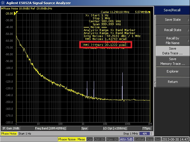

Then please take a look at the plot I have attached, the Agilent E5052 is able to measure the jitter of a square wave oscillator without any problem.
It has a low noise internal reference and it uses cross correlation to do the math.
And now please take a look at the Keysight E5052 Technical Overview: "Precision Clock Jitter Analysis with
Femto-second Resolution".
The Timepod works in the same way, although it costs 1/4 of the E5052B.

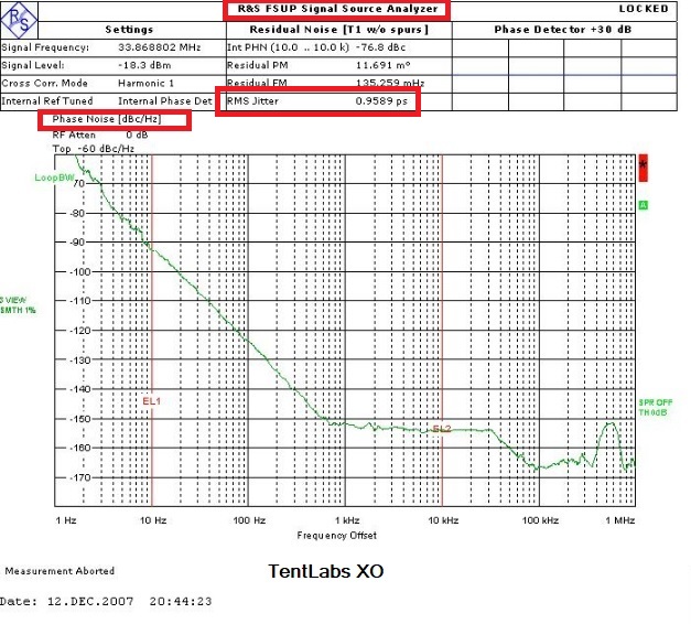

Just a curiousity, how you would think you can measure a DUT which has lower jitter than your digital oscilloscope
(for example the Tentlabs XO - jitter 0.9589 ps)?
Sorry, but you can't.

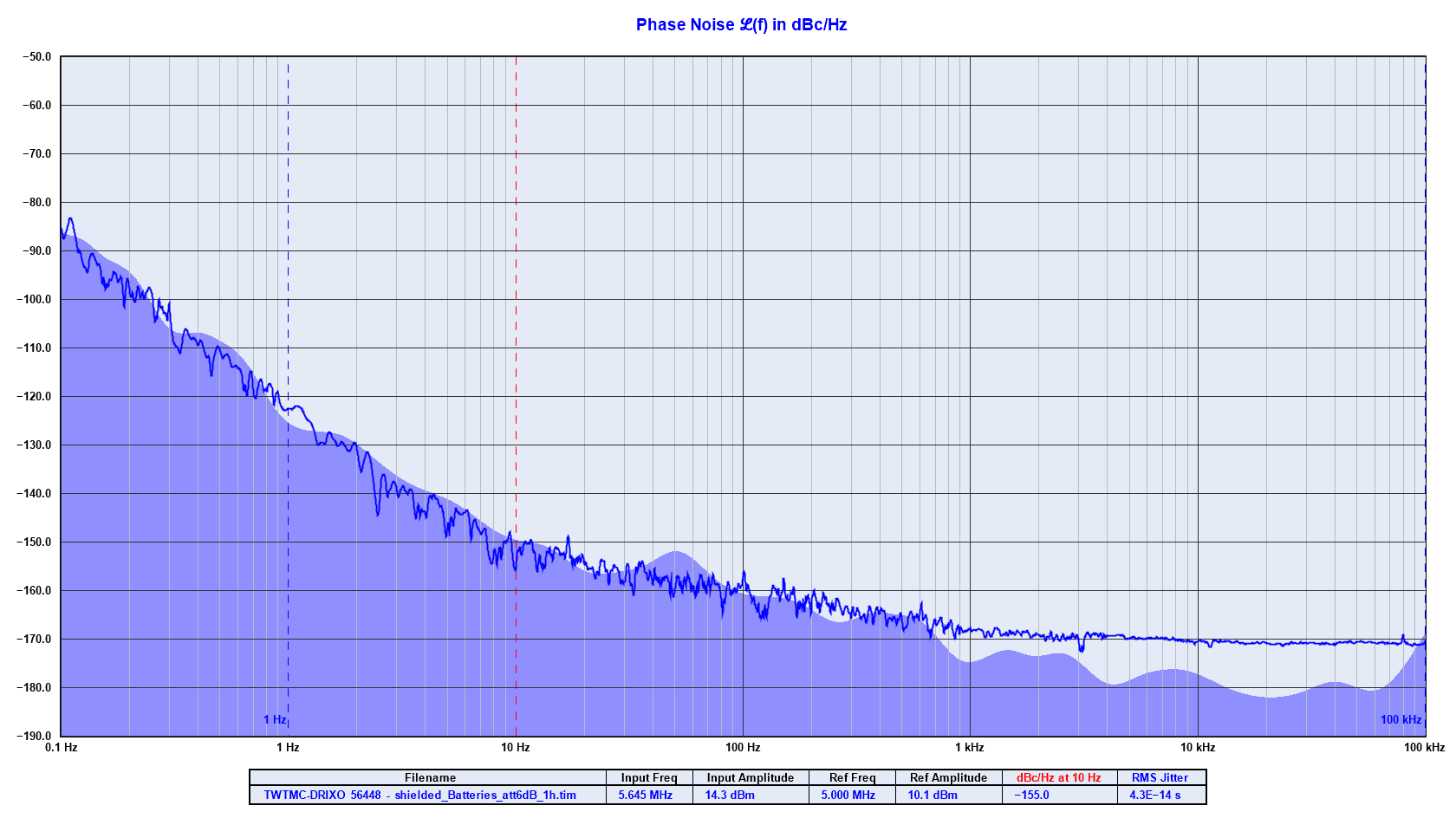

The Timepod measure phase noise and jitter in the same way of the Agilent E5052

Although the measurement capability of the Timepod is limited to 30 MHz the way it makes the measurement is the same of the E5052.
Like the E5052 when the Timepod measure the phase noise in 3-cornered hat configuration it use a splitter, 2 reference sources, 2 mixers, 2 LPFs and 4 ADCs (LTC2216).
Then the cross correlation software does the math and displays the FFT spectrum.
Please, take a look at the E5052 Technical Overview, you can read the following:

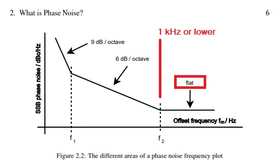

it looks like you are confused about the phase noise measurement.
The measurement is based on the phase and not on the frequency.
The low pass filter blocks the RF frequencies which are out of the frequency offset range to be converted into an FFT spectrum.
The analyzer is set to measure the signal level out from the carrier (often this may from the carrier out to a frequency of 1 MHz or possibly more). Ideally to a point where the noise has reached the noise floor.
The bandwidth of analyzer must be set so that a good balance is achieved between the resolution of the scan and the time taken for the scan to be taken. The noise level can then be converted to that found in a 1Hz bandwidth or lower.
The high frequency content of the signal after the mixer must be removed. The interesting part of the signal is between 0 Hz and about 1 MHz.
Usually above 1kHz from the carrier the noise floor is reached so the phase noise becomes flat.
Consequently the low pass filter does not affect the measurement in the frequency offset range of interest.
