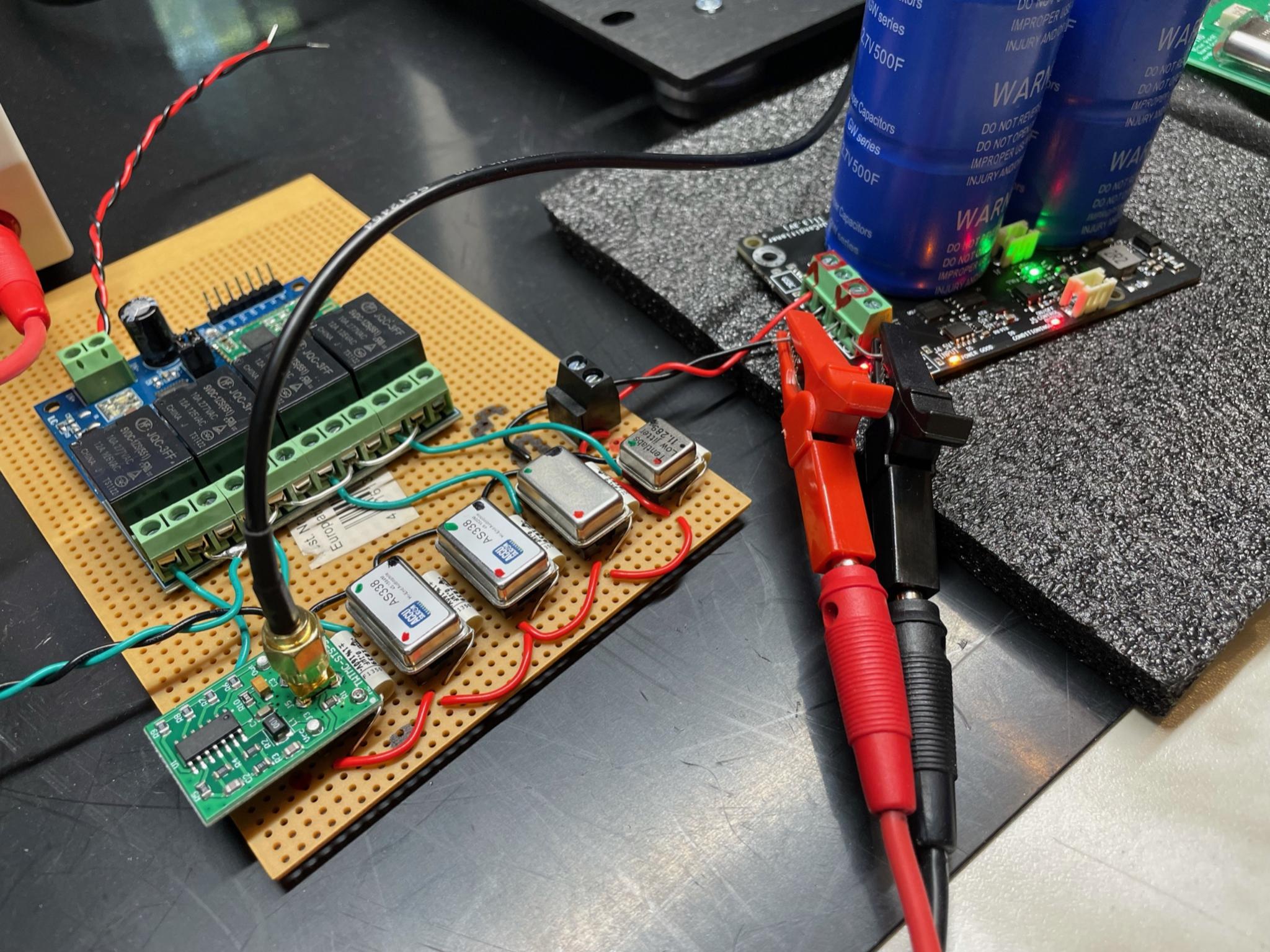

Hi peufeu,
no need of medieval duel, as I said I would be happy to try another sine to square converter better than our.
But when it comes to measurements it's pretty clear that you can't measure a device that has a jitter of 1ps with a tool that has a jitter floor of 2ps.
The time will come when we will also measure the DAC output, as soon as the front end and DAC are ready.
It's a bit premature now.
Andrea
Andrea

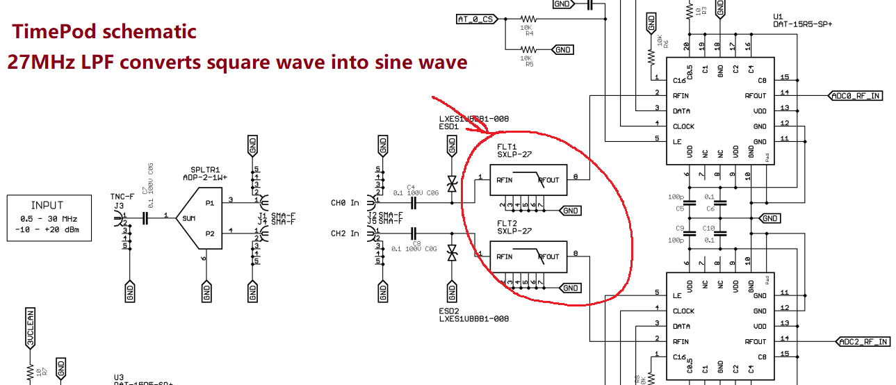

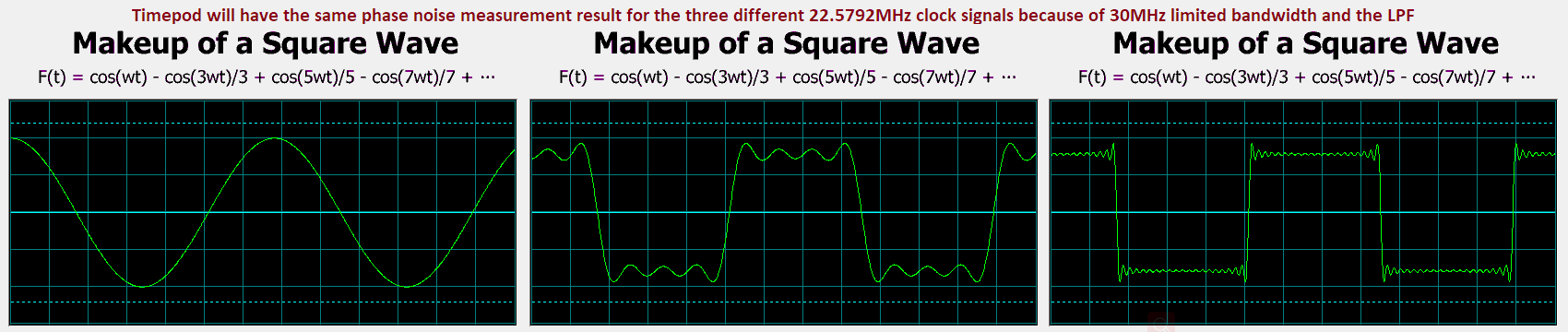

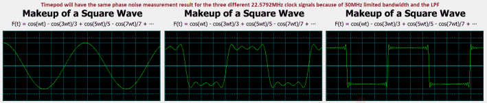

Hi Andrea,
I have neve questioned your phase noise measurement on the sine clock signals. What I’m questioning is your phase noise measurement on square waves. If you take a look at the TimePod schematic (please see the first picture) you will know that all input signals will go through the 27MHz low pass filters first before being fed into the ADC. That means a 22.5792MHz square wave clock signal will be converted into a fundamental frequency sine wave by TimePod before taking the measurement. Because all other square wave related information was lost when converting square wave into sine wave, your TimePod will have the same phase noise result for all the three different signals in the second picture attached.
The first signal is the fundamental frequency pure sine wave clock. The second signal is a poor quality square wave clock with slower slew rate, and ringing and noise over logic levels. The third one is a better square wave clock that we can find in the real world. Those three clock signals will run a DAC at totally different quality levels, but your TimePod will never tell the difference in between.
I also attached the SXLP-27 LPF data sheet. Seems the performance is not perfect. There are a lot of leakages above the cut-off frequency. 36-41MHz has 20dB loss, above 41 MHz has 40 dB loss. For the TimePod 16bit 81.5dB ADC, the leakages will become aliasing noise which will result in worse noise floor.
Based on this issue, if your point is that the square wave quality doesn’t matter for phase noise, then why don’t you use the sine wave clock directly for a DAC without converting it into square wave?
Actually, the final output square signal quality is the most significant thing of a sine to square converter. That’s all the purpose it works for. But the quality of the square wave signal will need time domain measurement to figure out. That’s what I’m working on. My LeCroy LC584AXL is the correct equipment to use for this kind of time domain test, that’s not a question.
What I’m suspecting is that the performance of the STS sine to square board may limit the sound quality of your great DIRXO sine clock. My LC584AXL testing results also support this point, please visit the link below for more details:

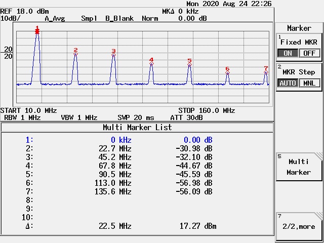

Hi Ian,
you keep with the wrong reasoning, you are still confusing phase with frequency.
Where the noise has reached the noise floor the phase noise becomes flat.
For input frequency below 30 MHz this happens below 1 kHz.
That's the reason why the Timepod measures the phase noise with an offsets from 0.01 Hz to 100 kHz from the carrier.
Therefore an LPF with a corner frequency at 27MHz does not affect the measurement with the above offset range, and then the integrated jitter is computed correctly.
Even a sine wave oscillators has harmonics and you claim the Timepod can measure sine wave signal but not square wave signals.
So there is something wrong with your reasoning.

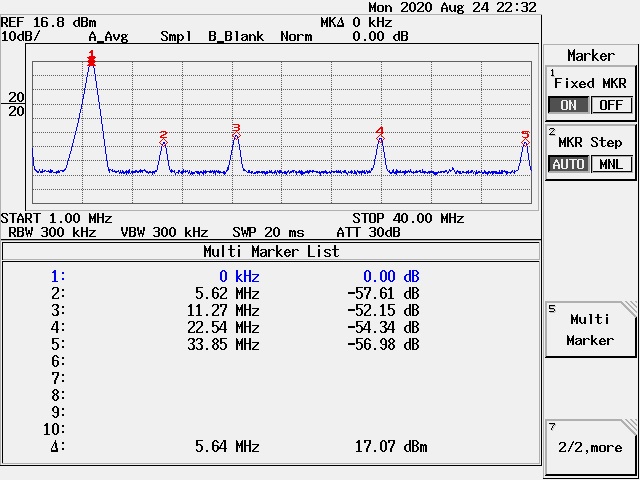

Please, take a look at the harmonics spectrum of the DRIXO oscillators at 22.5792 MHz and 5.6448 MHz.
There are a lot of harmonics, the 2nd harmonic of the 22.5792 MHz XO is -31dB and it's filtered by the LPF since it lies at 45MHz. The third harmonic is -32 dB and lies at 67 MHz.
While the first 5 harmonics of the 5.6448MHz XO are not attenuated by the LPF because they lie below the 27MHz corner frequency.

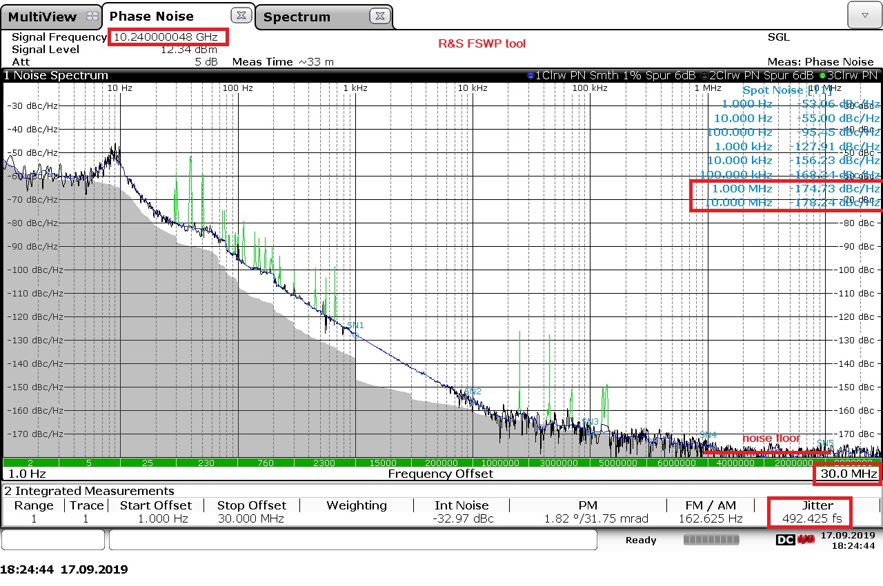

So in your opinion the Timepod correctly measures a 5MHz XO but not a 22MHz XO?
Do you think the state of the art R&S FSWP tool digitizes the harmonics when measuring a 1GHz XO?
This tool is capable of measurements up to 50 GHz, do you think it uses the second harmonic at 100GHz to measure phase noise and jitter?
It looks like you have not understood how the tool works.
The R&S FSWP uses direct down-conversion of the DUT signal with a low phase noise local oscillator and an analog IQ mixer. The signal is then captured with AD converters with 16 bit resolution running with 100 MSamples/s.
Do you know how a down converter works?
The analog mixer create itself a lot of harmonics, so the combined signal coming out from the mixer has to be filtered with a LPF to reject the unwanted harmonics.
After the LPF the signal is captured with AD converter.
As I already said the measurement approach is the same, the only difference is the input frequency limit.
Since the FSWP accept input frequency up to 50GHz the offset frequency range from the carrier is wider, 30MHz vs 100kHz of the Timepod.
The reason is simple, at such high frequencies the noise floor is reachead at much higher frequency than 1kHz, so the FFT have to use a wider offset range.
Is that clear now?
The Timepod can measure a square wave just like a sine wave, the only limit is the input frequency up to 30MHz, while the FSWP accepts input frequencies up to 50GHz.
Please, try to understand how these tool work, then all will be clear.

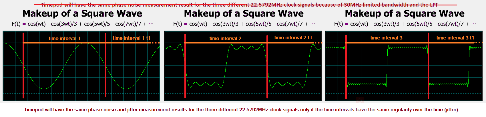

Why?
Because oscilloscopes have a jitter floor they can't measure below, which is typically in the range of picoseconds for general scopes. There are very high-end oscilloscopes that can measure down to 100 femtoseconds of jitter. They can be very expensive, hundreds of thousands of dollars. Due to their high cost access is often limited if at all.
Fortunately, phase noise techniques can measure jitter with excellent sensitivity. Jitter measurements well below 10 femtoseconds (1 fs = 10-15 s) are possible, which is much more sensitive than a typical oscilloscope. To get this level of sensitivity the cost of a phase noise analyzer is almost two orders of magnitude lower. It is relatively easy to measure jitter under 10 femtoseconds with a phase noise analyzer.
Another advantage is that phase noise plots make it easy to distinguish random and deterministic jitter, which is difficult using an oscilloscope.
Your oscilloscope has a jitter floor of 2ps or maybe more, so you can't measure below, there is no way.
Andrea
Is that clear now?

Continuing to think about the issue, square waves minimize the chances of amplitude noise affecting the time at which a switching threshold is crossed. If a phase noise measurement system can ignore amplitude noise, then square waves should be no different from sine waves for the purposes of phase noise measurement. That's because amplitude noise and phase noise are conceptually orthogonal to each other.
OK, stop me if I'm wrong
The Timepod measures phase noise embedded in the clock signal, that's pretty much the jitter you'd get at the DAC if the sine was turned into a square by a perfect noiseless comparator that doesn't care about slew rate.
And Ian says (misquoting but you get the idea) "it's not a perfect noiseless comparator, so slew rate matters, the DAC clock input gate will add its own noise, so you want high slew rate (low risetime) to minimize that"...
I think you're both right, but since you're talking about different stuff, chaos ensues 😀
Example:
All three different signals would have the same phase noise (except HF noise that was removed by the LPF). I think the TimePod would correctly give the same measurements for the three.
The scope should measure the same jitter on all three signals also (again, except HF noise removed by the LPF), but it won't, because due to its own noise slew rate will matter.
For the same reason they would result in different jitter at the DAC due to different slew rate. That depends on the internal circuitry of the DAC and how much noise there is on the power supply that controls the logic level threshold.
You could use a logic gate after the sine-to-square as an approximation for the DAC clock input, and measure that with the TimePod, and you'd probably notice a rise in noise floor depending on output slew rate of the sine to square converter.
Example:
