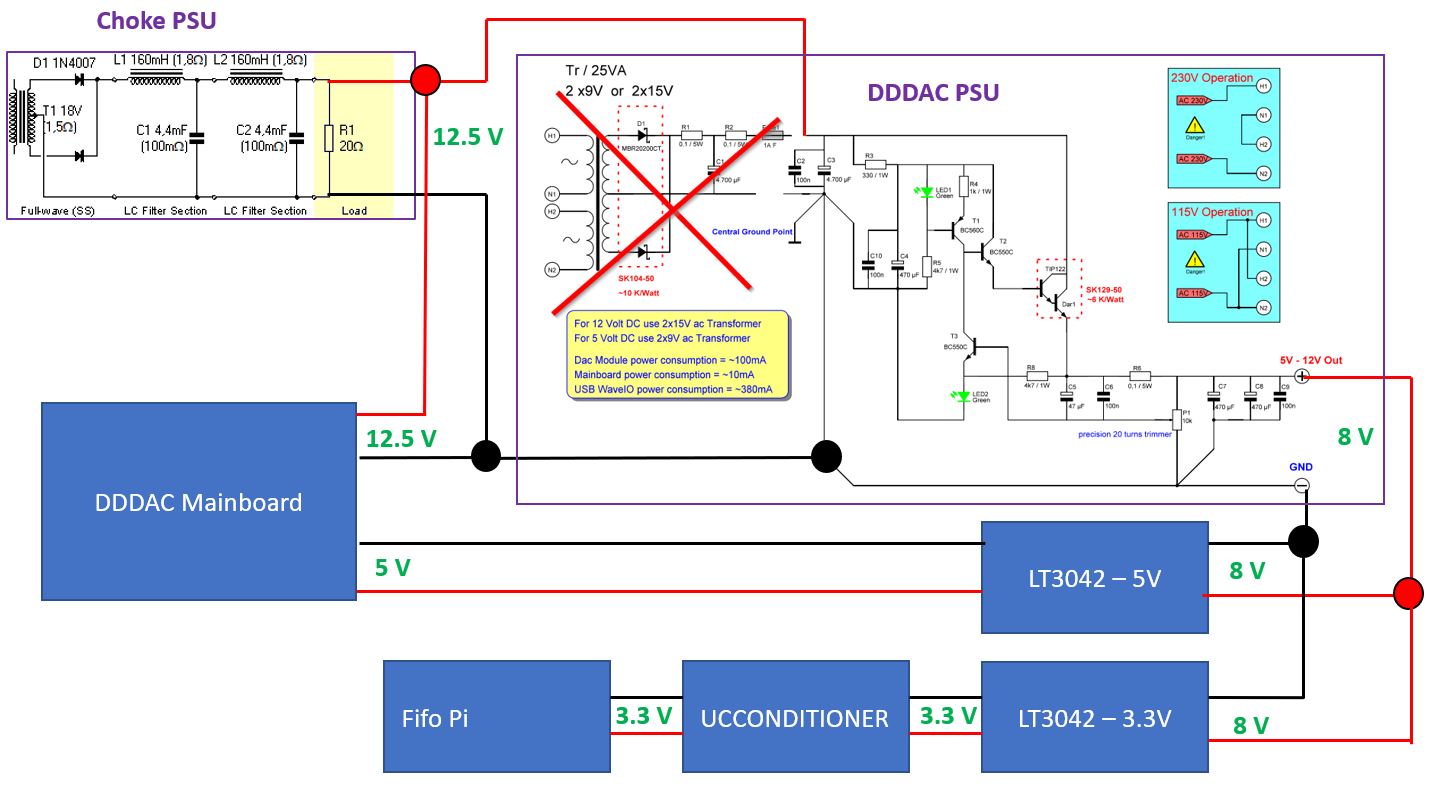

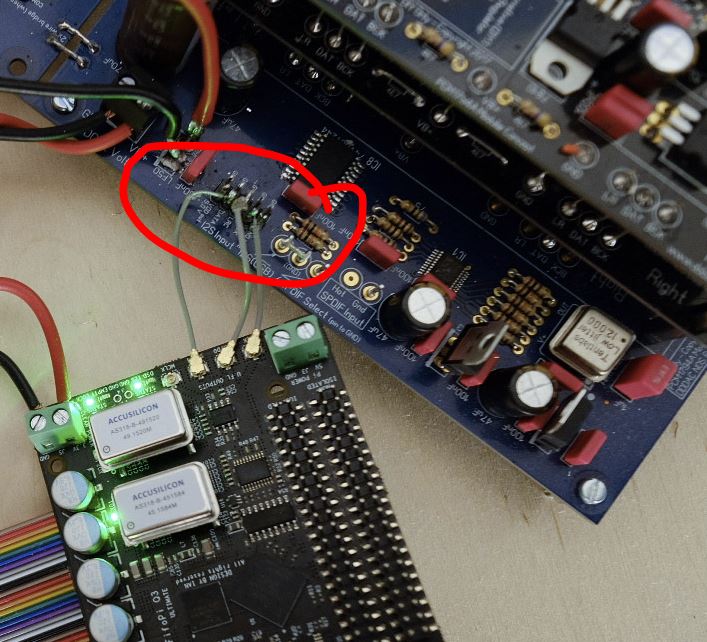

quick check, is there also a GND connection between UFL wiring and the 10 pin header on the mainboard? Or is the "only GND connection through the black power supply wires? I had some instances where not having an extra ground wire between FiFoPi (through UFL shield) and dddac mainboard where this caused issues
your picture is not so clear on this point...
Thank you for your support.
I have connected the shield of the middle ufl connector to one of the ground pins at the i2s input connector of the mainboard. It is hard to see on the picture.

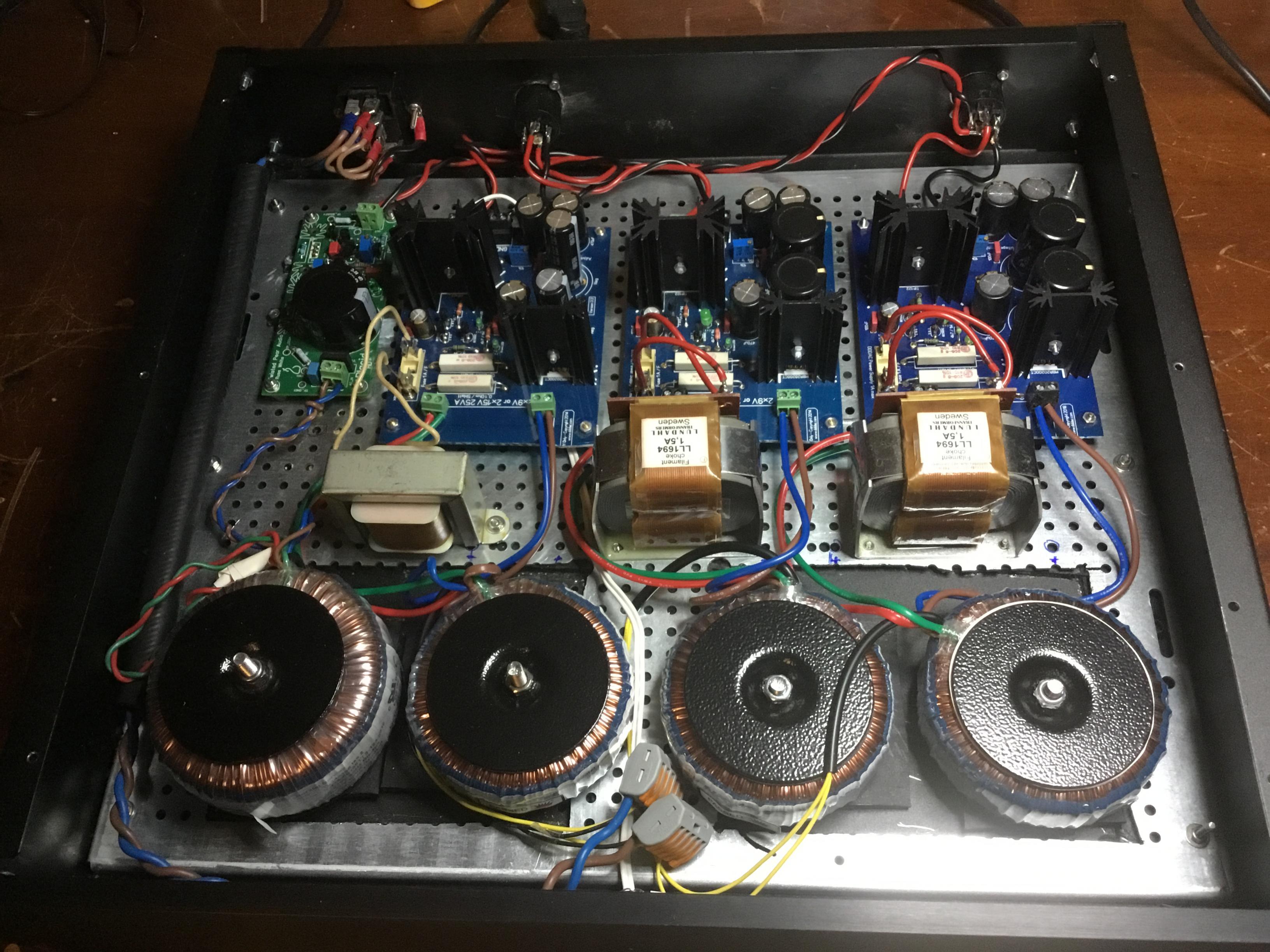

Hello Michael,
Because you are still a bit in the trial and error fase can you try connecting the input choke as suggested at the bottom of the Lundahl LL1694 pdf. So one coil in the LL 1694 will start at the center tap of the transformer and end at the first capacitor.
The GND coming from the circuit/caps will not end anymore at the center tap BUT at the first cap terminal.
The number of mH will remain the same but the filtering should improve. Of course you take care of the termination numbers.
