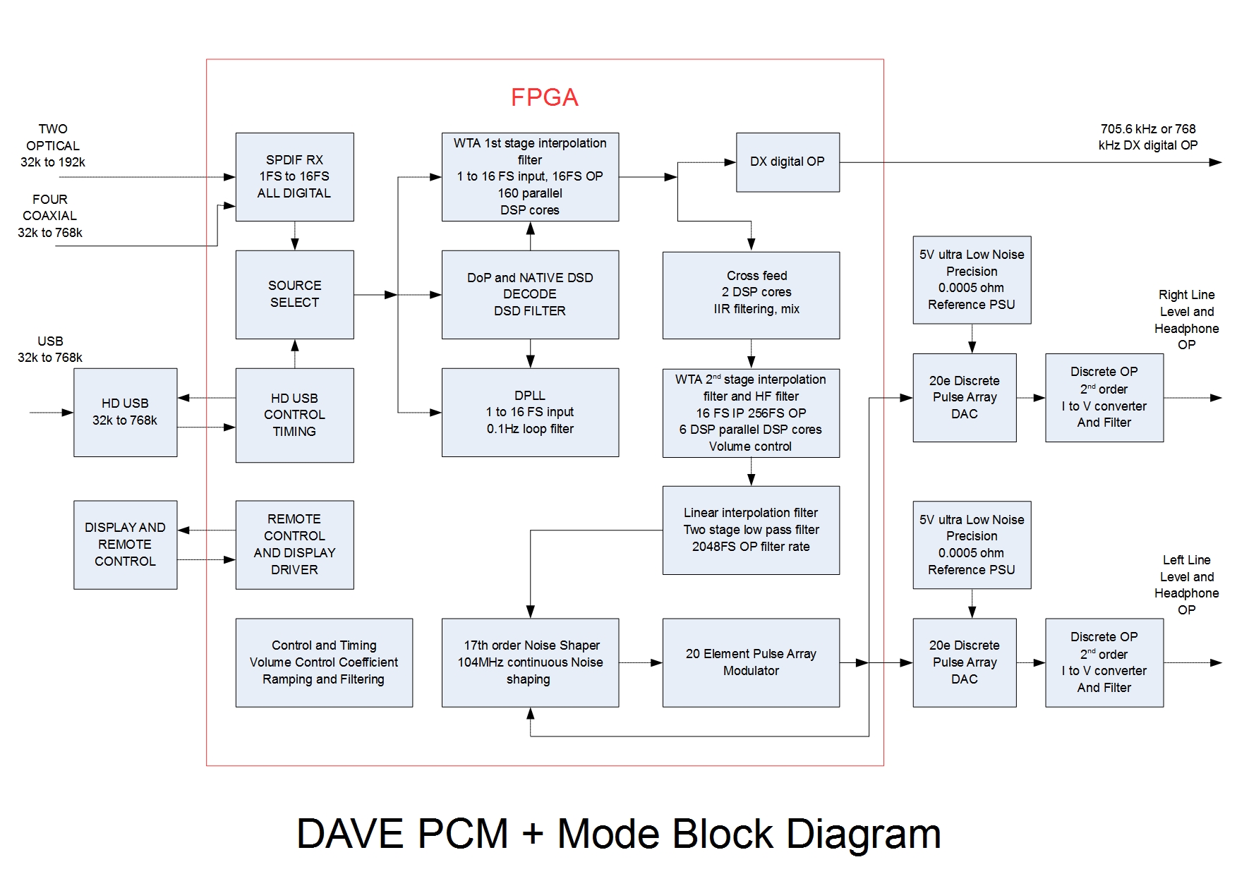

Have you ever considered the development of FPGA-based DAC? Chord develops a series of FPGA-based DAC, especially Chord DAVE is the pinnacle of work, surpassing many dac based on ess9038pro. I certainly understand that it is very difficult for the sound quality of FPGA-based DAC to surpass ess9038pro DAC, and the required investment cost is very high. However, if Ian can approach the level of Chord DAC through the evolution of several versions, you will also become one of the DAC brand developers. That will be the glory of sponsoring Diyaudio members. In addition, your reclock technology is already very mature. If you can further integrate the DAC function, you can even surpass Chord DAVE.
What advantage would FPGA bring?
In general use, additional jitter will be generated in the path between the RECLOCK and the dac chip. Assuming that the functions of RECLOCK and dac are implemented in the same FPGA, the jitter generated by the path between them can be so small that they can be ignored. The only premise is that FPGA-based DAC and ess9038pro are at a comparable level.
This is the reason why chord DAVE has such an excellent level.
ummm....
Let's be clear: there is no such thing as an "FPGA DAC". FPGAs are digital chips, and only have a digital output. Commercial DACs which use FPGAs use the FPGA for the DSP/oversampling section of the DAC, and not for the actual digital to analog conversion.
For example, in Chord DACs, the FPGA runs the oversampling operations, and then outputs a very high rate digital signal, which is then converted to analog via the "Pulse Array DAC", which consists of discrete parts (flip flops and resistors in Chords case, I believe).
I cringe every time I hear "FPGA DAC", because it is misleading way to characterize how those DACs actually work.

Have you noticed that the word I used is DAC function? Did I mention that FPGA DAC is the so-called DAC chip?
If you are interested in chord DAVE, you can take a closer look at the explanation of Rob Watts below.
Chord DAVE, Part 2: The Interview With Rob Watts - Positive Feedback
