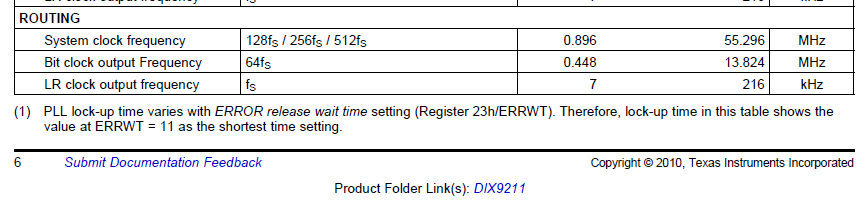

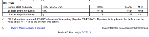

Thanks for doing those tests Ian, interesting result!
I was going off the datasheet spec for 'routing'
attachment.php
So assumed that 216kHz was the limit for i2s signals also. It may be that different batches are built on different processes so all ICs may not come out exactly equal after fab tolerances perhaps?
Chris
Hi Chris,
Thank you for highlighting the datasheet. Yes, They listed 216KHz for DIR, DIT and routing. For DIR or DIT, the physical limitation was the max MCLK. But for routing, things are different, I couldn't think of what was the physical limitation (it just a MUX logic), I think they just make them as same number to avoid any trouble if their customer wants go higher 🙂
But any way, my result was just based on real testing.
Have a good night
Ian

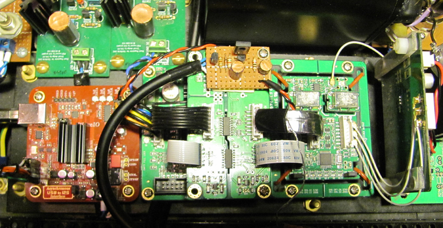

Thanks, Ian.
I've kept the WaveIO to FIFO cables as short as possible and set up with tight GSGSGSG. Hopefully bypassing the WaveIO's isolator will do the trick.
Shane

Hi Shane,
According to your picture, you are using two isolators.
In my setup I can do 384 by taking the WaveIO U.fl outputs connected to U.fl Fifo. So NO WaveIO isolator used!
Everything should be fine than...
Ed

Why 384 KHz I2S works for S/PDIF board backdoor without limitated to 216 KHz
attachment.php
Chris
Hi Chris,
Have a good night
Ian
Hi Chris,
I was wondering how the numbre 216 KHz came from. So I reviewed the DIX9211 datasheet again after you posted the highlighted section. Now I think I found a possibles reason.
For routing I2S signals, on page 6, it states that the max system clock (MCLK) frequency is 55.296 MHz. That I believe is the physical limition of the chip. So, under their default test conditon, which was MCLK=256Fs and BCK=64Fs, the max BCK will be 13.824MHz and max LRCK will be 216 KHz. That is where the number 216 KHz came from. It was calculated but tested. However, at same section, it says that MCLK can be 128/256/512Fs. So, with test condition of MCLK=128Fs (which is our case running 384 KHz with 45/49 XO), the max BCK becomes 27.648 MHz and max LRCK becomes 432 KHz! That explains why we don’t have problem running 384 KHz with the S/PDIF board backdoor.
In addition, when the datasheet talks about routing I2S signals, it means there are four signals, which are MCLK, BCK, LRCK and DATA. But for our system with FIFO included, we don’t need the MCLK to route, therefore that limitation of max system clock frequency will not apply to applications without MCLK feeding into DIX9211.
Just hope I got the right answer.
Ian

Hi Shane,
Ed
Thanks, Ed.
And so this is the confusing part.. bypass the WaveIO isolator and direct to FIFO is ok with either 352k or 384k, or both. Using the WaveIO isolator limits to 192kHz. How can the WaveIO isolator be good above 192k if this is the case?.
In any event, probably easiest to just try it and find out.. without WaveIO isolator as you suggest.. yes. And if everything is then fine, great !!.
As you'd know its all pretty good as it is, but I'm interested to see what happens playing back 352k etc properly with 1541A and how it sounds.
Shane
