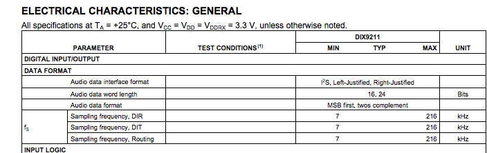

Just checked, with my tidier cabling, again my playing of 352Khz files, using or not the Dix9211 in the input board. Seems to play rather nice during a second listening..
Isn't playing 352Khz in stead of 215Khz(max for 9211) not a too big margin?

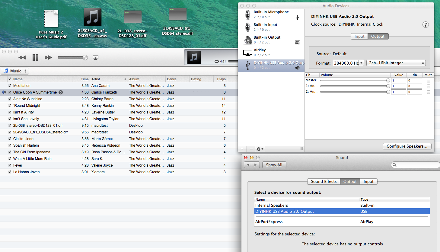

Update the new XMOS USB running at 384KHz with isolator
I received the new XMOS USB on weekend and did a quick test.The result was quite promising.
It runs perfect at 384KHz with isolator and 45/49 MHz clock board!
The new XMOS chip is in BGA package with 48Mhz system XO, the old version was in QFP package with 13MHz system XO.
The reason could be that the XMOS USB is running Async mode, therefore CPU clock is different from audio clock, but the I2S timing is generated by CPU. If it is true, higher CPU clock or CPU clock with less jitter result in higher quality on timing, especially for high audio Fs like 384Khz.
I would suggest try this new XMOS USB or Amanero 384 (which has an external CPLD dealing with I2S timing issue by hardware).

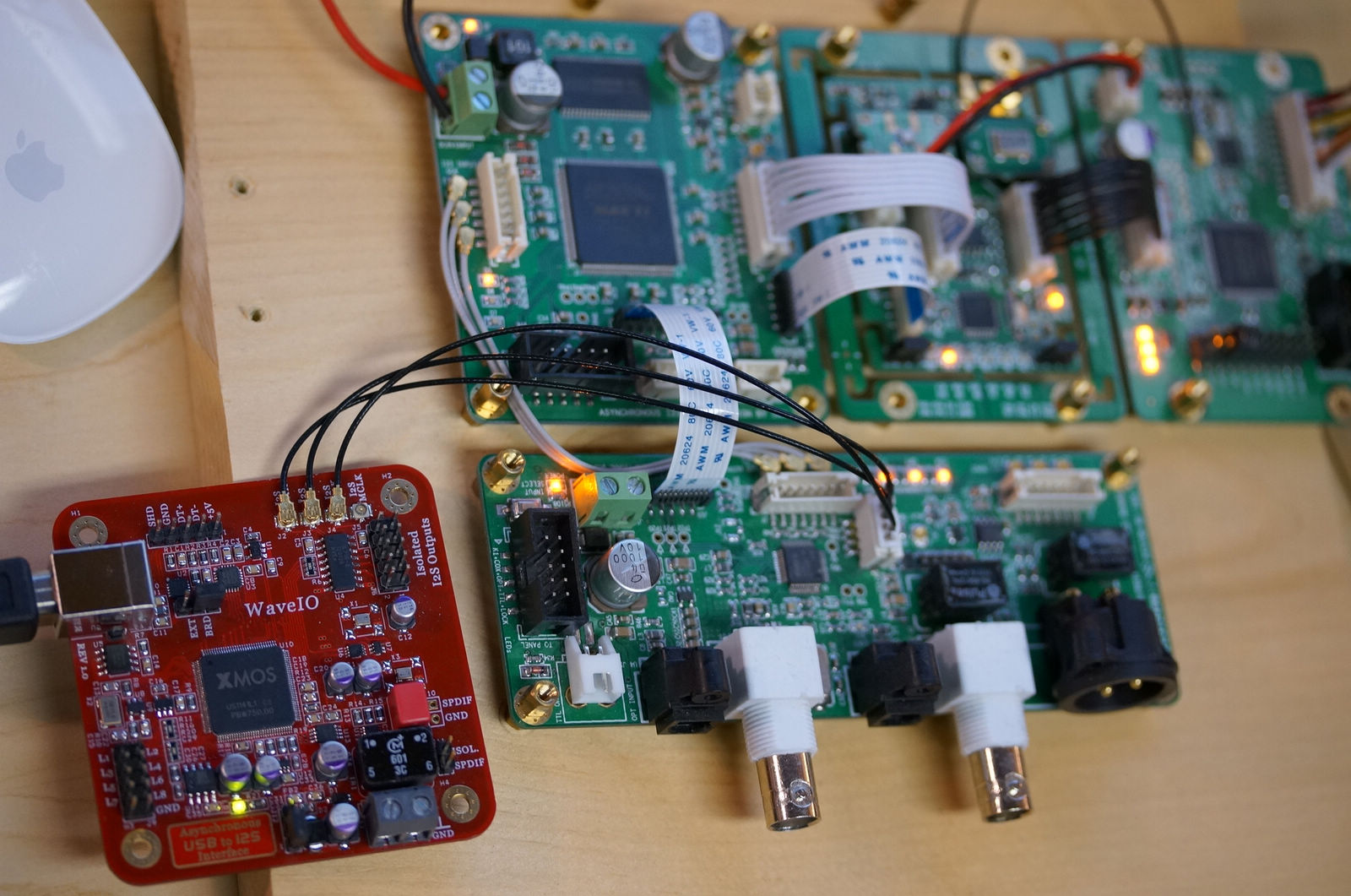

Hi Shane,
With directly I meant using the three WaveIO U.fl outputs (no isolator) directly into the three U.fl inputs of the Fifo board.
The 'problematic' connection was WaveIO isolated output to the 'backdoor' of Ian's SPDIF interface input board.
This board, the SPDIF interface board, has the 192Khz (DIX9211) restriction. So I do not think the WaveIO isolator has this 192 restriction too, but I did not try that. But you could trust the isolator for being able to throughput 384 Khz.

Hi Shane,

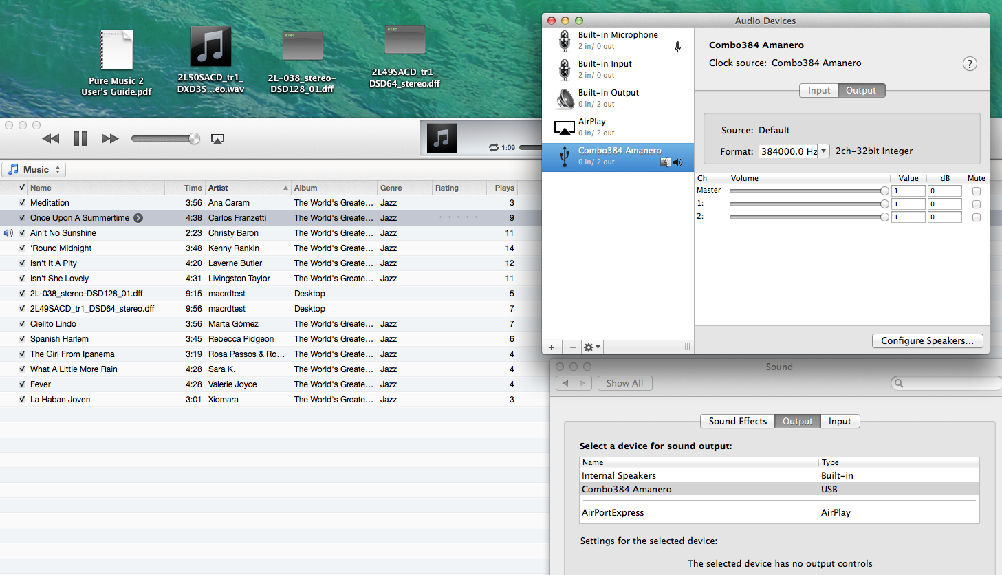

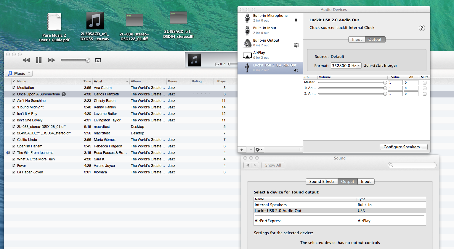

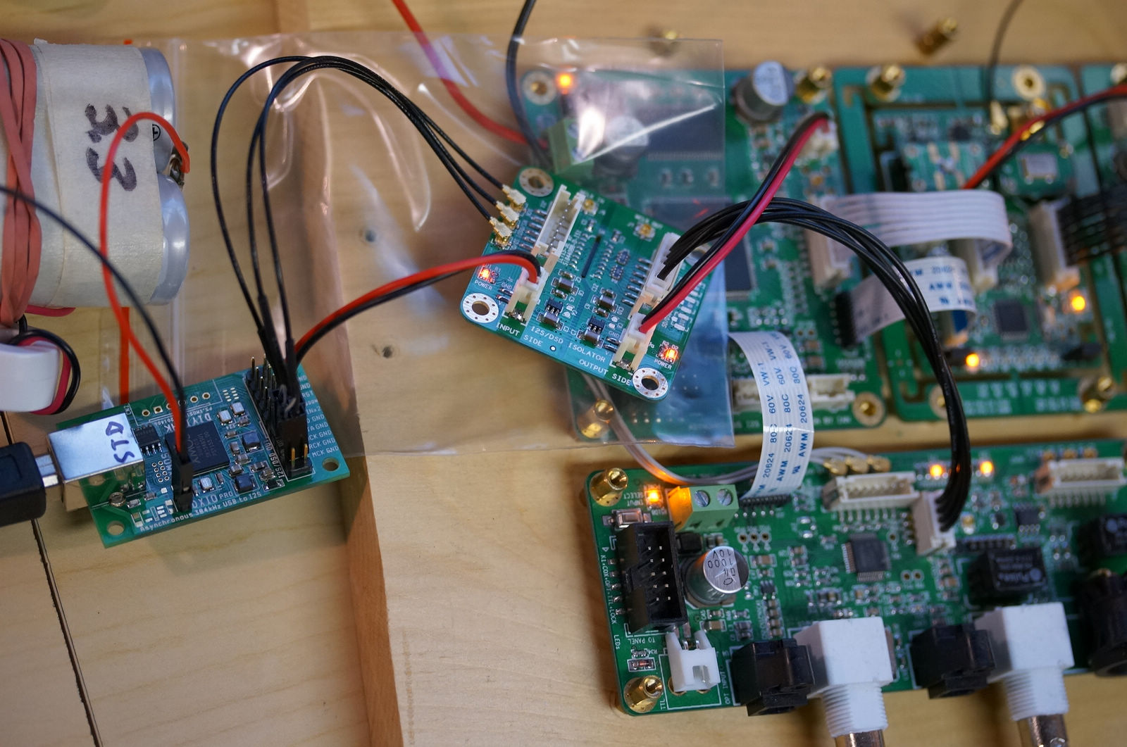

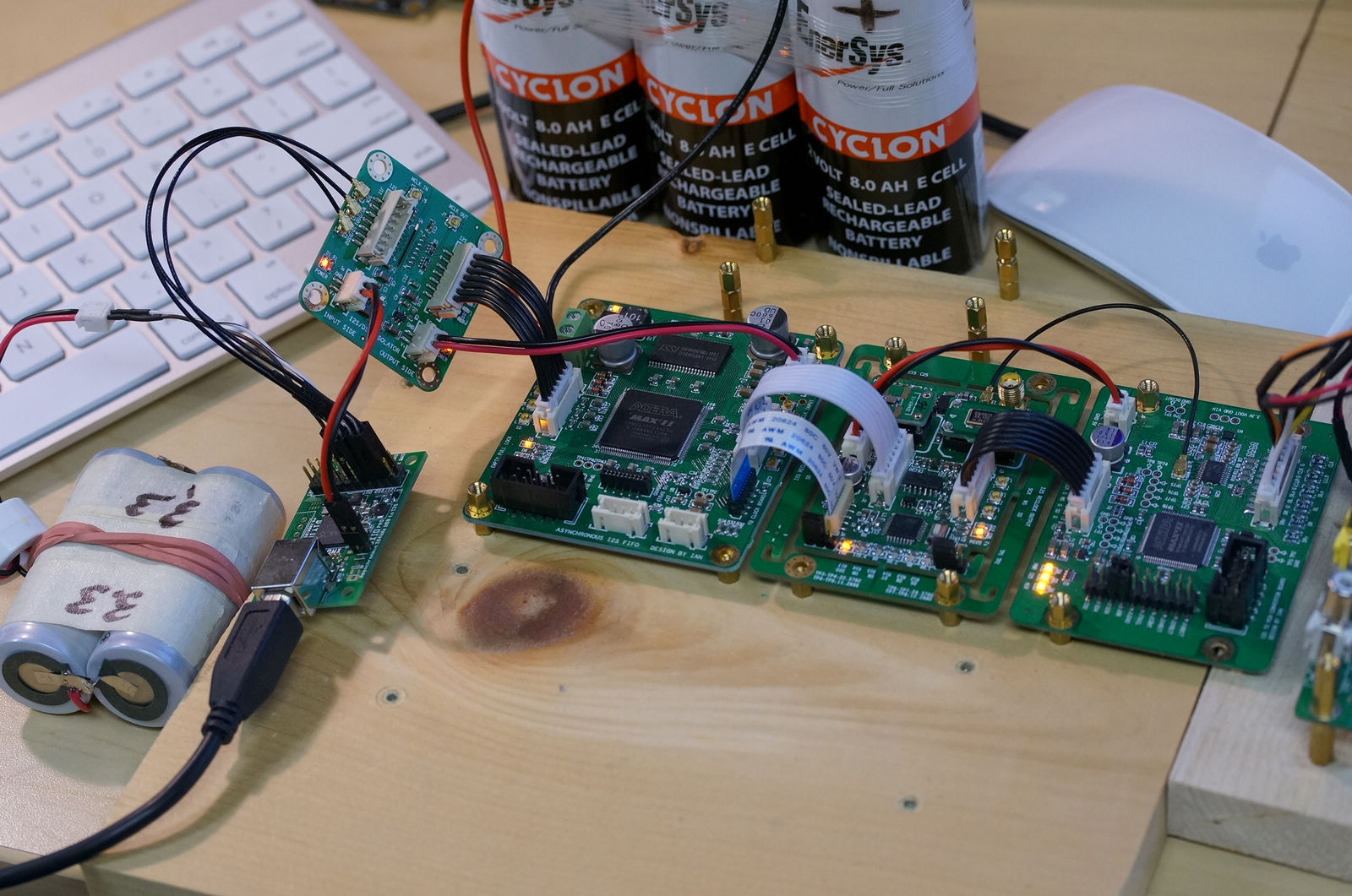

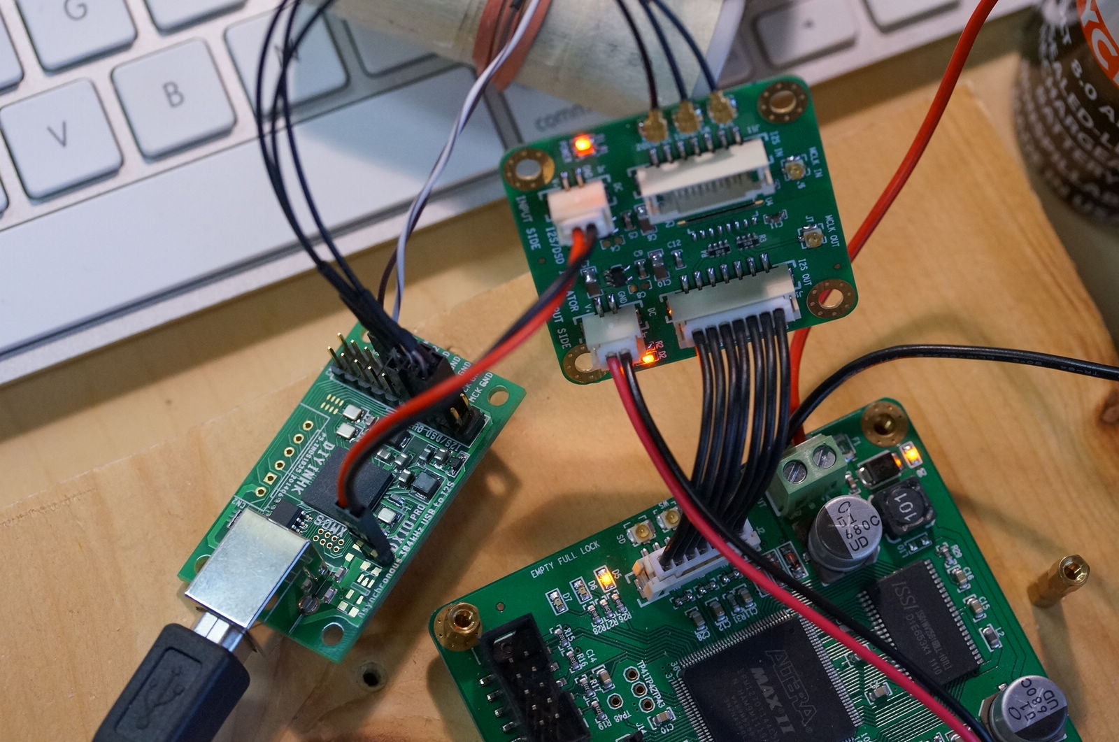

Confirmed I2S backdoor of S/PDIF board works for 384KHZ
Hi Ed,
I did more test today on my system with feeding I2S signal into S/PDIF board backdoor, I confirmed S/PDIF board I2S backdoor works for 384KHZ without any problem! But not for all USB .
1. Amanero Combo384: works for 384KHz, with/without isolator, both FIFO and S/PDIF board backdoor.

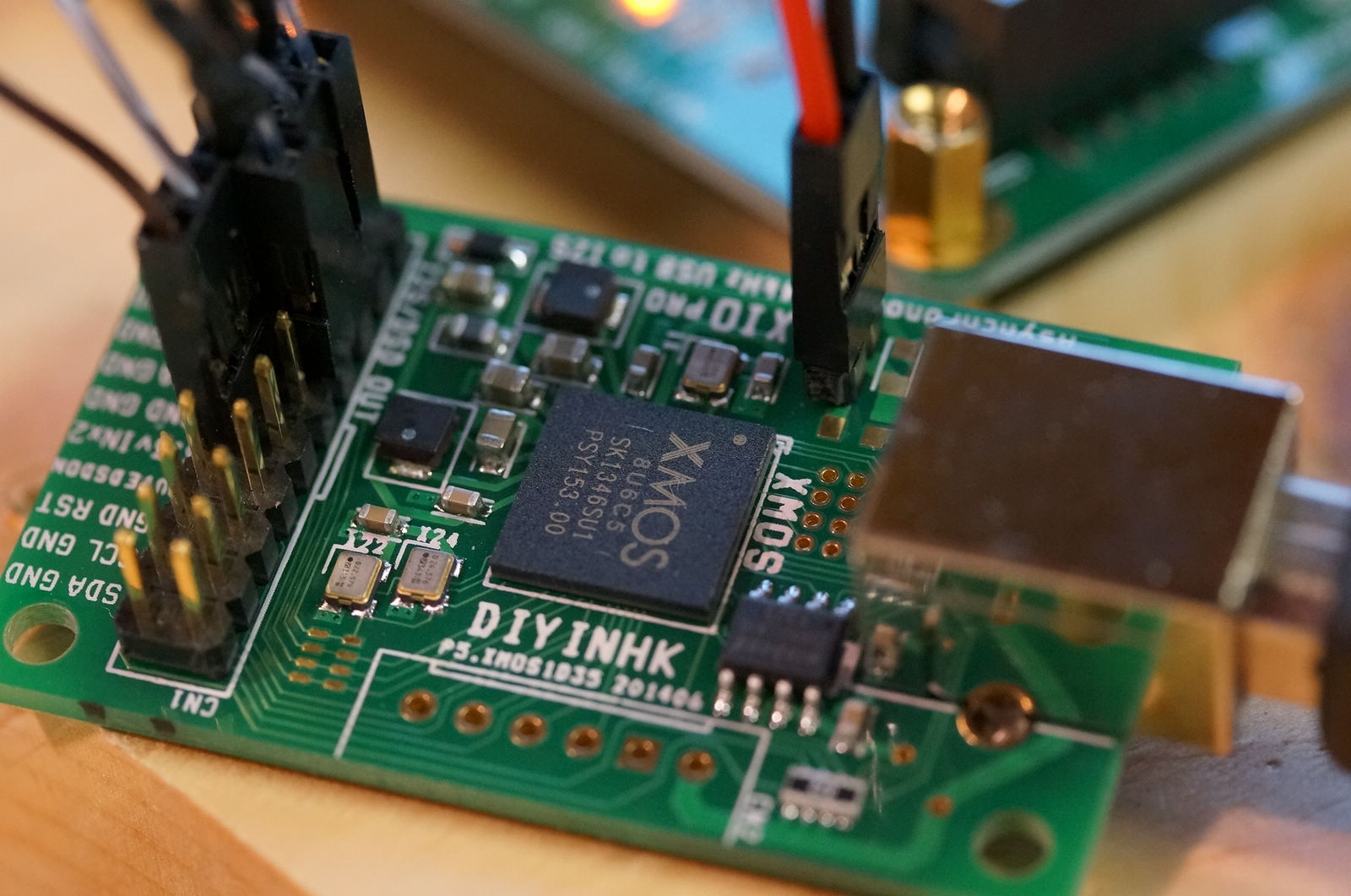

2. DIYinHK new XMOS: works for 384KHz, with/without isolator, both FIFO and S/PDIF board backdoor.
3. WaveIO old XMOS: works only up to 352KHz, without isolator, into S/PDIF board backdoor;Noise starts at 384KHz.

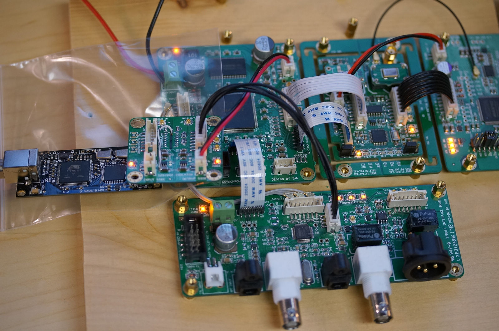

My system for this test:
iMac – iTunes – USB – S/PDIF board – FIFO – DualXO clock board (45/49Mhz) –PCM board – TDA1541A DAC (simultaneous mode)

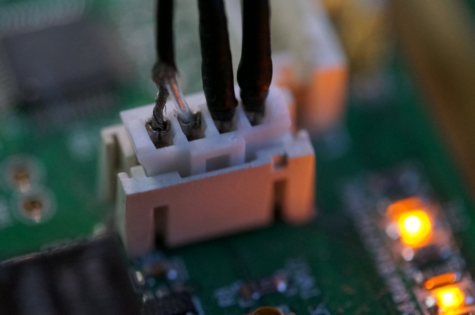

50ohm coaxial u.fl cables between FIFO and S/PDIF board
There is no 384KHz limitation on DIX9211 I2S input. I think that 192KHz limitation was only for S/PDIF receiver.
Some tips running 384KHz,
With this Fs, BCK will run at 24.576MHz, while Data up to 12.288MHz, so we have to tread them as high speed clock signals

Hi Ed,
1. Use coaxial cables and u.fl connectors as possible as could.
2. Making cables as short as possible.
3. Termate signal sources with 33 ohm chip resistors to mach impendence with cables
Good luck to your project
Ian

Thanks for doing those tests Ian, interesting result!
I was going off the datasheet spec for 'routing'
So assumed that 216kHz was the limit for i2s signals also. It may be that different batches are built on different processes so all ICs may not come out exactly equal after fab tolerances perhaps?
Chris
Chris
