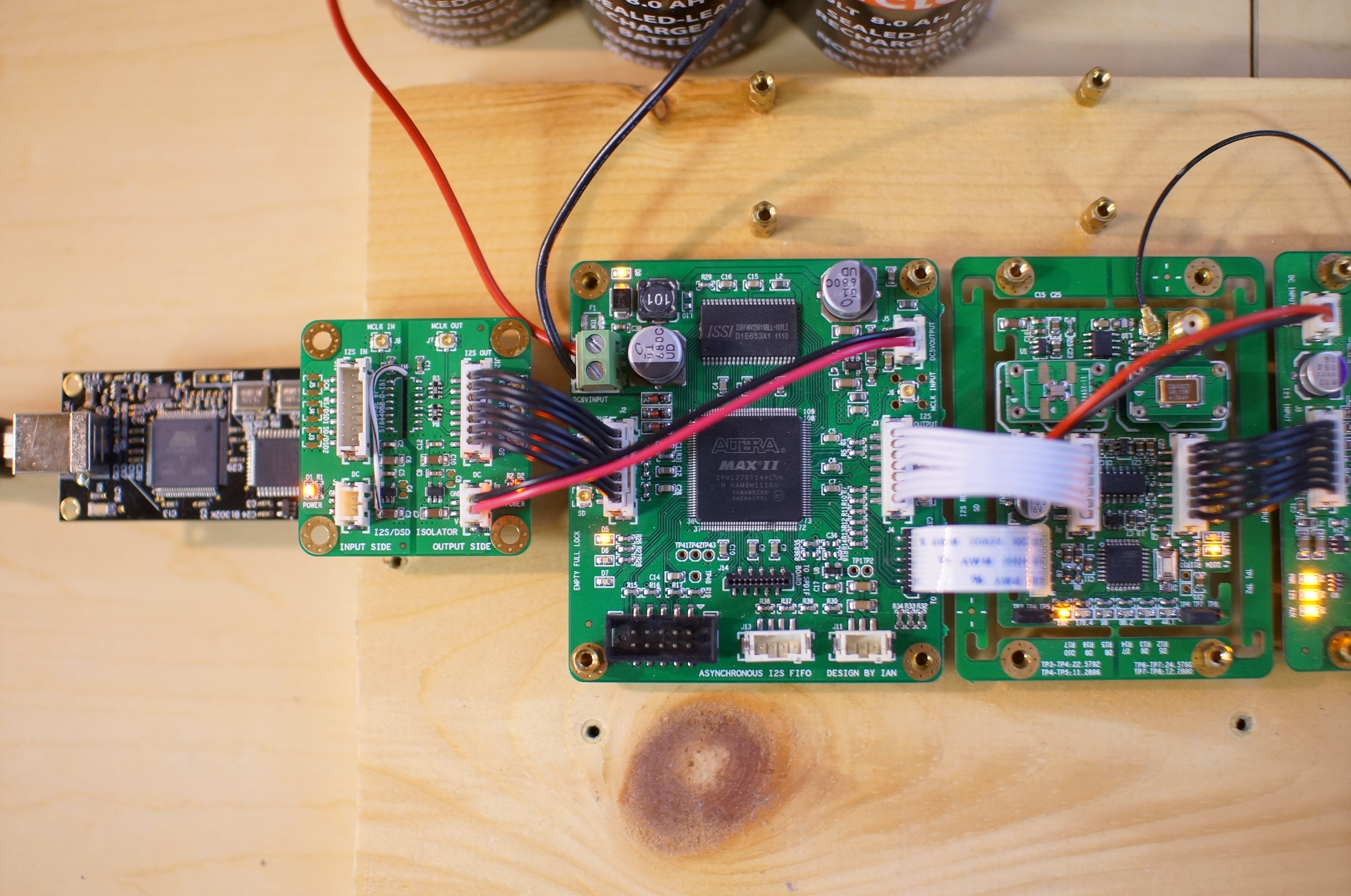

Regettably I have to put the isolator-board back in place, because I modified the dualclock board to be fed by a lifepo4 battery and thus feeding two supplies linked. Little Fifo does not like that!
So for the time being everything back to the 'old' situation. (not able to play higher res. than 192Khz)
At least I know now, where the problem comes from.
Ed

Dual clockboard/384Khz
Hi Ian,
Thanks for your explanation.
I did place your (2.0) isolator indeed between Fifo- and clockboard.
I use the isolated connection from the WaveIO to have a nice extra I2S input via the SPDIF input board.(Backdoor remember?)
I need the isolator between Fifo- and clockboard because the clocks are fed by a lifepo4 battery.
Question:
1) Can I, after removing L11, work without the isolator?(When using battery)
2) Is it an elegant way to split up coax (hirose) to make the 'backdoor' connection? Or is there another possibillity.
In the meantime I would gladly try one of your prototype PCB's. Does a BOM exist for this board?
And get myself an Amanero. But I must say I am soundwise happy with WaveIO.
Go and try for now if having just one isolator, between Fifo and clockboard, does the trick.
Ed

1) You can power the dual xo clock board separately after removing L11
2) I'v never tried other way connecting the back door, You can give a try if your have some good ideas.
They are just PCB only, all components you have to order and assemble by yourself. Please message me your address if you still want the PCB.
Ian
Dual XO Clockboard/384Khz
Hi again Ian!
My routing now is :
PC>WaveIO(isolated I2S)>Fifo 'backdoor'>Dual Clockboard(45/49)>1794Dac.
So no isolator between Fifo and clockboard.
L11 removed, no problem anymore with double power.
Clockboard powered by lifepo4 battery.
44.1 up to 384Khz without any problem!
Please tell me if this is ok or is there a better way of isolating, if needed at all?
Thanks for your help,
Regards, Ed

Isolator/384/Shane
Hi Shane,
This was intended to be my last move...
I tried it earlier but forgot about it because I want to use my SPDIF ínput switcher.
So what I did again is:
WaveIO>directly into the coax Fifo>Ian's universal isolator>Dual xo (45/49)Clockboard>DDDac1794
and.....
Success! 384 again. Clean as can be!
So the problem resides in the use of the isolated WaveIO in this setup.
Make myself a new cable for the 'backdoor' and go on with my life.
Thank you all for the help,
regards,
Ed

Hi Shane,
I do not own a multibitter, s.a. 1541. So I dont use the I2S to PCM board.
My route is:
PC > WaveIO (not isolated coax) > Fifo (coax of course) > Ian's Isolator (Ver.2.0) > Dual Clockboard (45/49) > DDDAC1794 > Two monoblocks full class A > Two times ESL63 , grannies but producing beautiful music for my aged ears!
Hi Ian!
The above route works now, up to up to 384Khz.
But......
I am a SPDIF user too!
That means I own the in-output board because I use two SPDIF sources,
galvanic and optical.
Next to the most used one, USB-I2S via the 'backdoor' as you know by now. Hahahaha.
After putting the SPDIF board into the system again, I am back at the start.
NO 384! Lot of noise again, no music. 192Khz MAX.
My suspicion was all of the cabling between the boards.
What I changed:
1) Shortened the backdoor cable to one and a half inch. Using the coax connectors from the WaveIO conversed to the plug on the input/backdoor.
2) Changed the ribbon cable from input board to Fifo with three times two inch coax. (have no shorter!)
3) Changed the ribbon cable from Fifo to Isolator board with three times two (again) inches coax.
Now I am able to play 352Khz! (Just on its toes! Sometimes complaining)
So that was a right guess, or not?
Next thing is to shorten the cables furter, but I can find one inch cables nowhere. Maybe somebody can. Or a better quality perhaps?
For now, since I am stuck to using the input board, I will have to look for shorter/better cables.
Or better wait for your findings with your new xmos usb thingie.
But not too
far away, land in sight!
Regards
Ed
Hi Ed,
Just to confirm WaveIO Un-isolated output > FIFO > Original Universal Isolator (Ian) > Dual XO > I2S to PCM > DAC chip and now 384kHz success?..
Shane

Ed, the SPDIF board routes all data through dix9211 which won't support 352/384k. That's the limitation for sample rate when you're using the back door input rather than i2s direct to FIFO.
Chris

Hi Chris,
Thank you for this answer, explains a lot! Long time I have been mumbeling
about this issue.
I must be too simple to understand why my 570 clockboard has no problem with this setup. I did know about the 192Khz limitation of SPDIF but expected the I2S routing was a different one on this board, not going through the 9211 as well, but somehow parallel.
Is there maybe another way to have both I2S an Spdif switchable?
And Ian suggesting a different usb interface or an amanero that should ?
I will let it be for a while now,
Thank you,
regards
Ed

That's interesting that Si570 enables the SPDIF board to pass 352/384k music. I'll look into why that may be, could just be luck and may not be working optimally. May need Ian to run a test with that config if he has time?
I think Ian has a solution cooking in his multichannel FIFO project. Alternatively I think you could have an i2s switch like TPA's OTTO-II to select i2s data from amanero or from spdif board and feed it into FIFO input. I do not know if that board would cope with 352/384k but I think it should do ok.
Chris
