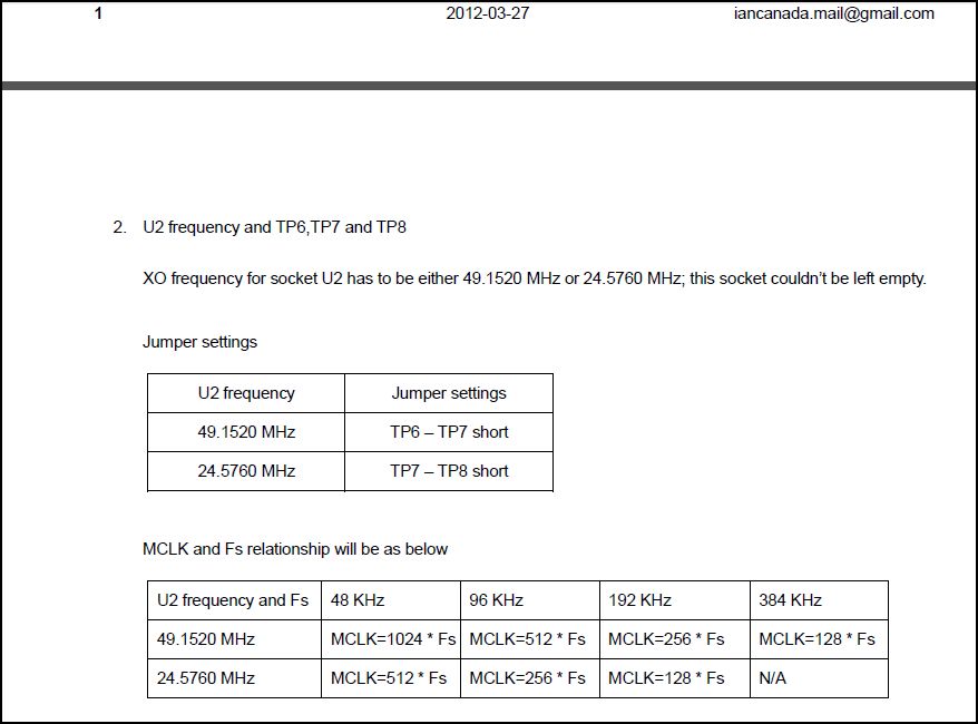

Doede's dac doesn't take mck, it generates it from bck? Wouldn't the single clock board work? The FIFO output to the dac would only use BCK/FSCK/DATA?
Hi Palmito,
All the clockboards work in my combination. The 570 board up to 384, but with the dual board and 45/49Khz clocks (in highspeed mode) is 192 the highest frequency to achieve.
You have the DDDAC174-Waveio combination as well if I remember right?
Did you try the dual board with the 45 en 49 clocks?
I wonder what your findings are...
Ed
Hi Ed. I no longer have the WaveIO hooked up to the ddac. Additionally, I have not used my ddac with the FIFO, so I can't really give you an opinion on that. Mine is driven by a raspberry pi hooked up to an Acko S03 and this to the ddac. But the S03 has a single 100mhz clock. The pi does not have MCK, can you hookup the WaveIO without MCK to the FIFO? Ian? If it can be done like that then it would be same hookup as the pi and it should work with the both dual and single clock boards?

Works perfect without MCK from Wavio I2s/Spdif-Fifo/clock/Dac.
1) Dual clockboard with 45 and 49 clocks up to 192 Khz.
2) 570 clockboard up to 384!
3) For single clock board I did not try higher F than 48Khz.
Ed

For what its worth, the dual XO I have here with 45/59 clocks is limited to 192kHz as max useable frequency (352/384 is displayed as an option) This is also with Lucians WaveIO with the 384 firmware update. I was starting to think its the WaveIO, or the Aurdivana software, or perhaps even the PCM board feeding 1541A (half speed or full mode). Best thing I ever heard so far but if theres a solution I'm overlooking, I'd be all ears.

I was thinking I had blown my dual board, because the manual does say that 384 could be done with the dual board + 45(49) clocks.
I am afraid I will have to wait for a version 2 as Ian mentioned in one of his replies.
Ed

Ed, try the single board with the 98 clock as Ian mentioned. For ddac you don't need both clocks, just one, since you are not doing anything with the MCK.
Palmito,
That means I have to get myself a 98clock! Ok, I have to try that.
This means that the Waveio does the frequency changeing, and the clockboard stays passive.
Sounds if it could work.

Think I have to forget it!
There will be no switching of frequencies.When choosing 98 clock I will only have 384 and I do need all F's, both 44 and 48 families.
So for automatic switching I need the two clockfrequencies I am afraid.
Please correct me if I am wrong,
Ed
Hi Ed,
So you think its to do with Fs as it relates to sampling frequency vs clock speed and that 90/98 mHz clocks will do the trick?.
With the 45/49 clocks, what happens if you shift the jumpers at TP3-4 to TP4-5 and TP6-7 to TP7-8 ?
Shane
Hi Ed,
Shane
Hi Shane,
Ian says I need clocks with double the F (90/98) from what I am using. It is a pity, because I bought them just for this reason. Being able to play all resoutions. And besides.....the manual said so.
And he spoke about a future version2 dual clockboard that should do the trick.

Hi Shane
Thank you for asking.
Nothing different happens.
Ed
Thanks for trying this, Ed.
Even if nothing different happens, how can it not change anything?. This is all way over my head BTW.
But it does clearly state that 45/49 will provide up to 384, which is what I'm struggling to achieve. I have 22/24 and 45/49 don't want to buy more clocks.
Shane
