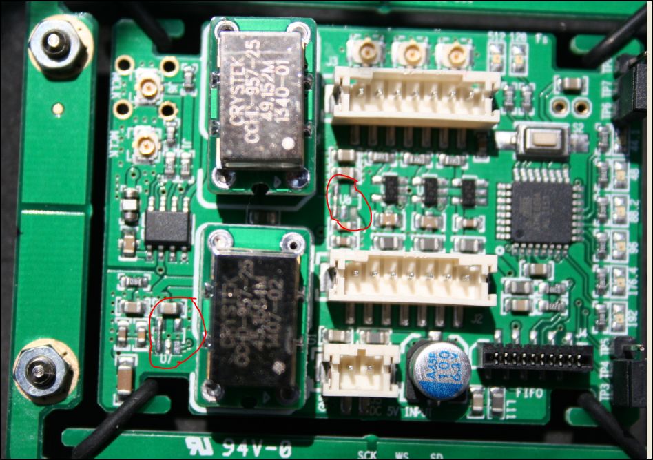

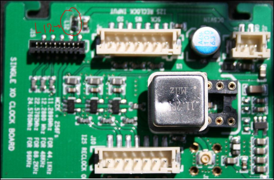

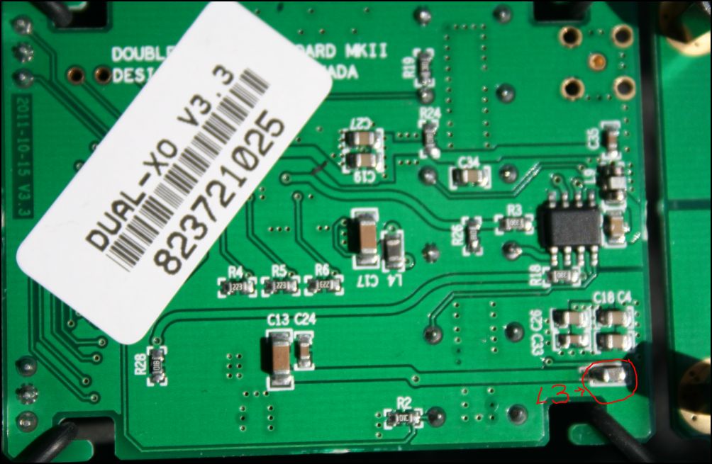

Trouble with dual clockboard fed by Lpifepo4 battery
Hi Ian,
Until now, to my feelings, I like the 570 clockboard best when fed by an original lifepo4 battery. So thinking about finding out how the battery fed dual board with a Crystec 45 and 49 Mhz in double speed would work...
So I did the mod, taking both regs out and shortcutting their in- and outputs.
Isolater board between Fifo and clockboard and powered by the lifepo4 by means of the management board.
No sound, just a little smoke!!!!
More thorough investigation showed a shortcut between two connections of one of the removed regs.(U7) This had ruined the L3 on the bottom side of the board. I borrowed a replacement for this L3 from my, not used, single clock board. (L12) Not knowing it was the right part I did use it.
Back in the music again. Happy me!
Hope you can tell me if I did the right change, or what part it is that I exactly need as replacement? Things are showed in the pictures.
One problem has left though.
I can play all resolutians exept 352.8/384Khz. Playing this F means static noise on the tune of the music file choosen.
Have to tell that I really like how these clocks sound on those batteries!! I think I will not ever go back. Even keeping them charged is no hassle at all.
I checked the 570 under the same conditions. Works without problems.
I hope you can assist me a little in finding the solution.
Thanks againfor the beatiful toys,
Ed

Hi Ed,
You did good job! They are in same part number. Glad you fixed it by your self.
I'm happy you like the toy, Enjoy your music!
What DAC your are playing with 384KHz? What is your USB source? FIFO works up to 384KHz without problem, but I had issue with some USB, maybe you you can find out that topic from my old post.
Ian
