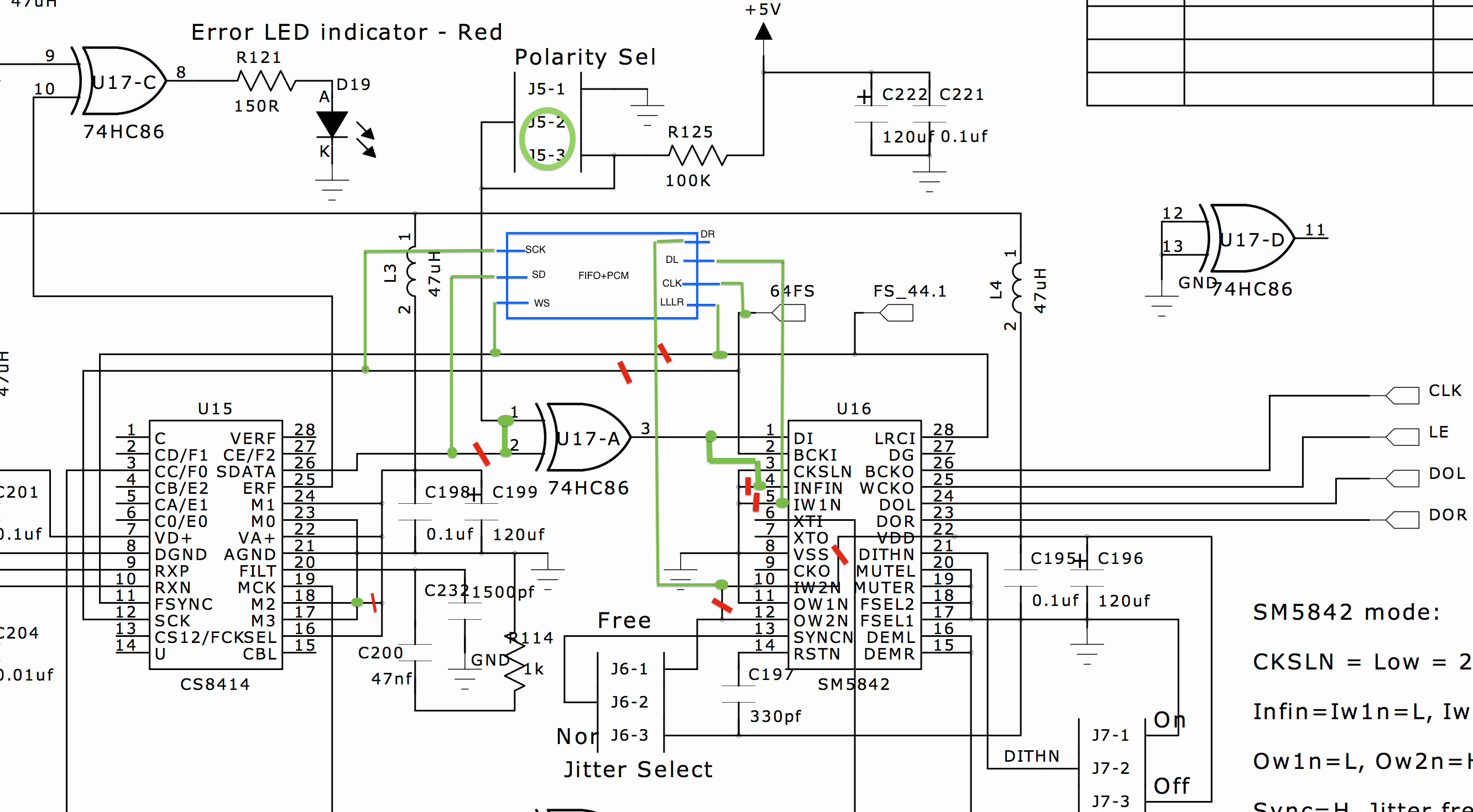

FIFO with PCM63 D1
I finally have some time to try and implement the FIFO modules into a DIY replica of the D1 DAC. Before I get started, I just want to make sure that I figured out the right way to connect everything to the DAC.
The DAC is a diy version of the D1, more specifically the D1V2 from Spencer Cheung (schematics: http://www.fetaudio.com/wp-content/uploads/2009/10/BAL-PCM-63-DAC-30.pdf). The digital section consists of the following: CS8414 -> SM5847 -> 4x PCM63
If I understood correctly, first the CS8414 must be set to output a I2S signal which is done by setting the Normal audio port modes to M3=0, M2=1, M1=0, M0=0.
From there, I take the SDATA pin and connect it to the FIFO board on the SD input, the SCK to the SCK input and FSYNC to the WS input.
The FIFO board will be connected to the Si570 clock board, and the clock board to the I2S-PCM board.
Connections from the PCM board to the DAC will be done by removing the SM5847, and connecting:
- CLK to the PCM63 CLK pin,
- LLLR to the PCM63 LE pin,
- DR to the DATA pin on the first PCM63
- DRn to the DATA pin on the second PCM63
- DL to DATA on third PCM63
- DLn to DATA on the fourth PCM63
Prior to the PCM63, there's a quad OR gate (74HC86). Can the PCM board drive the PCM63 directly without having to pass by the OR gates? Given that the PCM board gives the option of having an inverted data output for a differential setup, it would simplify the connections.
Are there any disadvantages of removing the SM5847 digital filter if I connect the FIFO?
Lastly, in terms of 5V supply, can the I2S-PCM board be connected to receive its 5V from the DC 5V output (J5) on the FIFO board? If I later add the isolator board, will I have to use a completely different 5V source for the clock board and PCM board?
Paul
:up:
For I2S CS8414 seems to need: M3=0, M2=0, M1=1, M0=0.
Yes
74HC86 is XOR not OR. If you are using DRn and DLn you do not need it 74HC86.
The FIFO is a "just" a FIFO, it doesn't modify the data. I2S-PCM board splits it into L, Ln and R, Rn, but still the same data.
A digital filter like SM5847 does 8x oversampling and digital filtering on the data. By removing the digital filter you will end up with a NOS (non oversampling) DAC. For a basic explanation on oversampling google for a pdf from Lavry on "Sampling, Oversampling, Imaging and Aliasing".
My 2 cents on this:
1. Leave SM5847 and use only the FIFO+clock to clean-up jitter.
2. Remove SM5847, forget about CS8414 and buy an Amanero Combo384 or similar 384MHz capable async USB thing and do the 8x upsampling on PC/ARM board
Yes for both.
Thanks for your help Vzs!
Concerning option 1 that you suggest:
From what I understand of the SM5847's datasheet, it doesn't seem to accept I2S input format. Therefore the FIFO+clock+PCM board must be inserted in-between the CS8414 and the SM5847.
To do that I would still set the CS8414 to I2S output as you've corrected, set the SM5847 to LR simultaneous, left-justified by having INF1N and INF2N high, and then connect the PCM board's DR to the SM5847's DIR and the DL to the DIL (I've attached a crudely modified schematic of the changes). Would that work?
As for your recommended option 2:
I must unfortunately still use SPDIF as input for the DAC. An option would be to use an ipod with the usb camera kit connected to the amanero and stream music to the ipod via itunes (the system must remain wife-friendly...), but I'm unsure if that would negate any benefit of going with the amanero + FIFO.
Paul

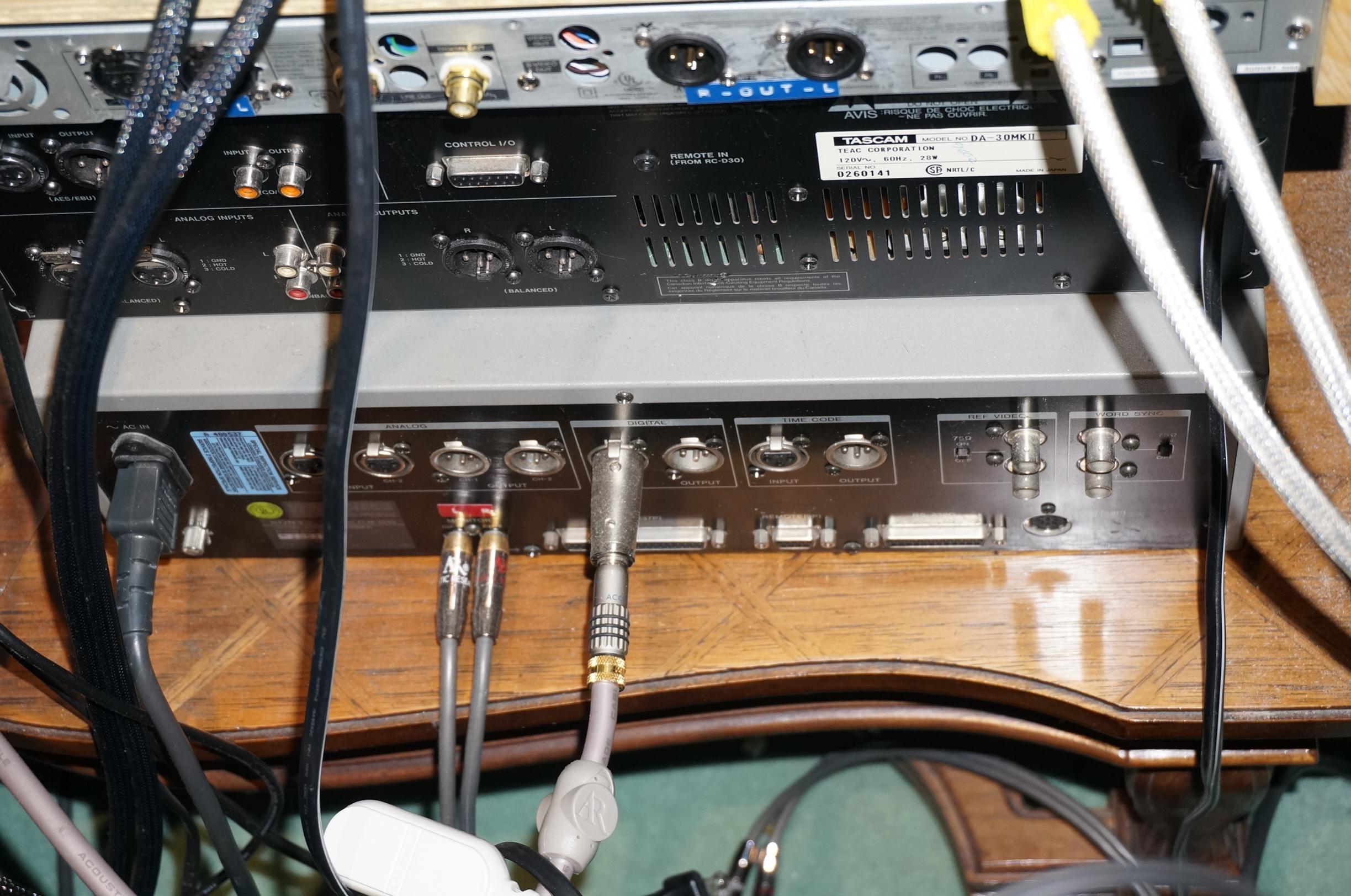

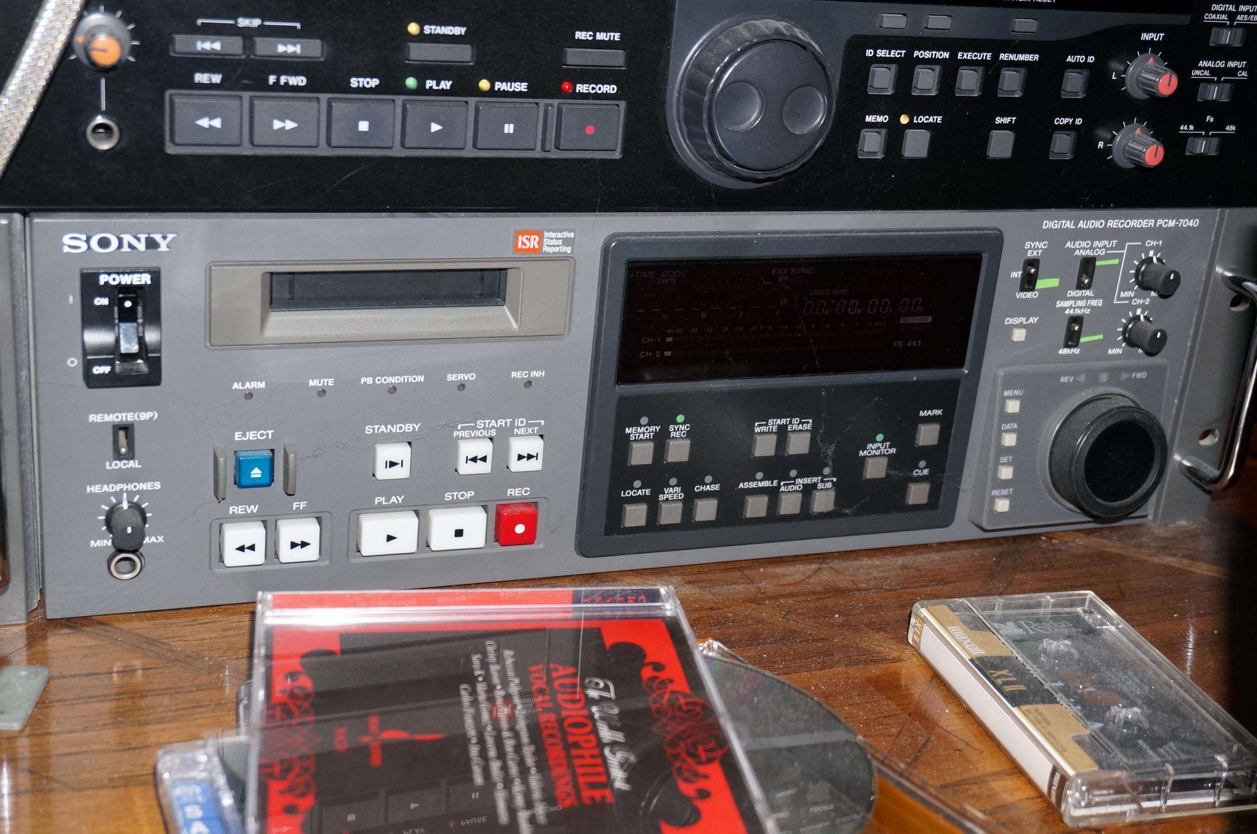

@bisesik S/PDIF FIFO setup for SONY PCM7040 DAT
SONY PCM7040 DAT was one of the best broadcast grade DAT, it can be used as an great AD1865 DAC for audiophiles. You can get one with very good price from eBay now.
To run it from USB or any other SPDIF sources, you need:
1. Configure FIFO KIT as standard S/PDIF FIFO.
2. Connect the S/PDIF output to DAT7040 by either AES balanced cable or 75 ohm coaxial cable via adapter.
3. Set the panel switches as picture with "input monitor" button pressed.
Analog signals can output from both RAC and XLR connectors. But the XLR outputs have higher level than consumer audio standard. I suggest using RCA except you can figure out how to reduce the XLR level.
Ian
