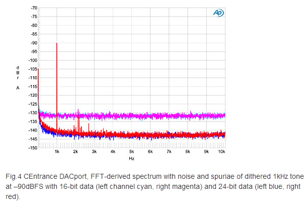

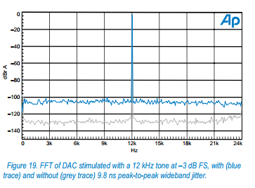

Random jitter shows up as a noise floor in the audio. I will also show as a spreading of the base of a pure tone when reproduced. However Digital audio has a pretty absolute floor for noise, essentially the resolution limit of the bit depth.
Below- the first picture shows the difference in noise floor between 16 bits and 24 bits. The noise floor drops about 18 dB in this case. The DAC is not capable of a full 24 bits but the idea is clear, there is an absolute noise fllor associated with bit depth (the 16 bit curve illustrates it). The second shows the impact of random jitter; it raises the noise floor. 10 nS random jitter set a noise floor of about -105 dB. Not knowing the resolution bandwidth of the measurement etc. I can't relate the plot to the usual quoted numbers but the relationship is pretty direct- 10X less jitter is a 20 dB reduction in noise floor from jitter. However, once you hit that absolute floor for 24 bits then lower jitter will make no difference in the output.

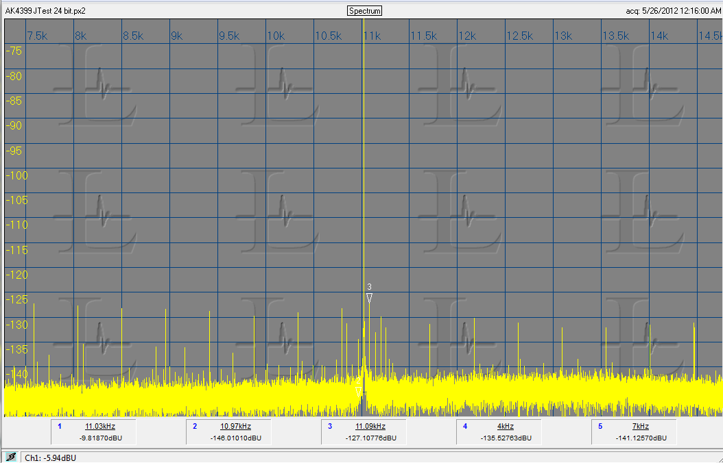

The third picture is a J-Test of jitter on the AKM AKD4399 demo board using the AK5315 SPDIF receiver. The strongest sideband is 60 Hz from the carrier and at -120 approx from the carrier, but its not symmetrical so it may not be a jitter sideband. The sidebands suggest a jitter of about 20-30 pS. This is using SPDIF at the end of a 15 foot coax cable from a PC sound card. I would not write off SPDIF as a means of connecting a digital source to a DAC.
