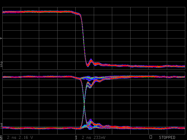

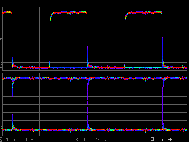

I upgraded my WaveIO USB with Lorien’s new sent FW last weekend and confirmed it works. The new FW has 17ns setup time on I2S signals rather than the previous 3.4ns. As well, LRCK and SD are changing exactly at the moment of falling edge of SCK now which meets the requirement of I2S BUS specification. The 384KHz issue was fixed, which just as I said, the solution1 is the best solution.
It works very well, even together with the on-board isolator and the I2S backdoor of the S/PDIF interface board. The music plays very nice at 384KHz, no any noise at all.
The attached screen shots are current measured waveform of WAVEIO USB running at 384KHz with new FW.

Fix 384KHz issue(10): Case can be closed
Small issue, quite a few homework. But fortunately it seems the case can be closed now.
Just hope not too much confusing, some sum up here:
1. Insufficient setup time of I2S output signals was the reason of old XMOS 384KHz issue.
2. This issue can be fixed by upgrading XMOS USB to the new firmware which will generate I2S signal exactly up to i2S BUS specification.
3. The issue can also be solved by adding 5-10ns delay to SCK(BCK) signal with hardware.
The attached waveform is the finial 384KHz PCM signal (will feed into TDA1541DAC) measured at output of PCM board after FIFO in my system (Under same testing condition).
Ian

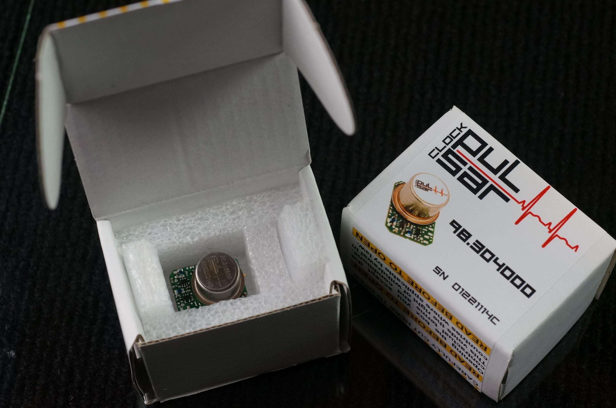

90.3168/98.3040MHz OCXO
The pair of OCXO I ordered arrived last week. Very expensive though. The pair I evaluated was the best impressed so far, I couldn’t live without it. That’s the reason I must buy them. Just hope they are better, or at least, as same as those prototypes.
It seems I have to design a new Dual XO clock board the next to support 90/98 MHz audio clocks. According to my listening test, both ESS9018 DAC and other multi-bits DAC which connects to PCM board, sound better than with 40/45 MHz clocks under same test condition.
Have a good weekend
Ian

Very nice Ian,I wanted to order a Pulsar @ 45MHZ,do you intend to quickly produce new XO board?can you define the difference that may exist between 45-49MHZ and 90-98MHZ please.
I'm gonna design the new Dual XO II clock board very soon. I'm trying to supply it at next GB.
I compared them with CCHD957 40/45 a couple of month ago, better result. But I don't have 45/49 OCXO. I would suggest you order the 90/98 version.
