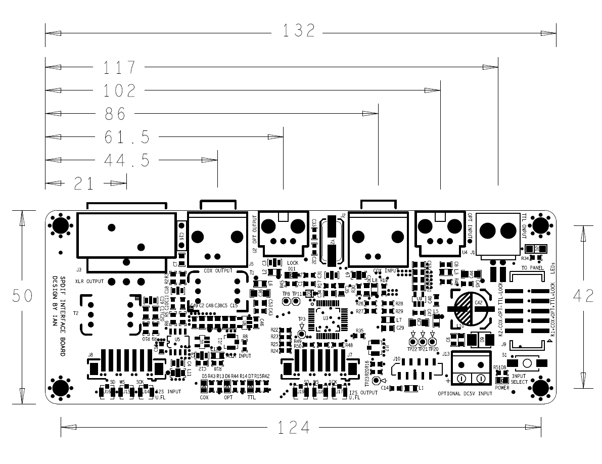

Hey all
I'm trying to make a case of this kit including the spdif board.
Did any one make a drill pattern for spdif board before?
I searched this thread but didn't get any luck.
Here is the detail SPDIF board PCB dimensions, just hope it helps.
Ian

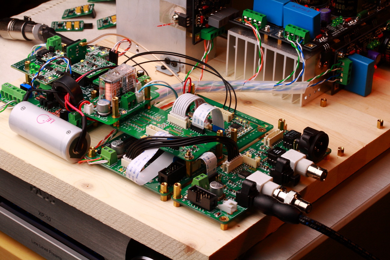

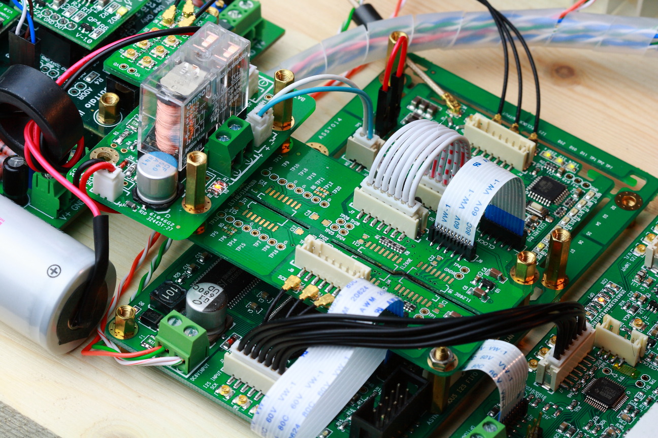

Set up 3.2V LiFePO4 direct battery PSU as a reference for Si570
As I mentioned a couple of weeks ago, the key thing to Si570 is the PSU. But to achieve a better result, what we need to do the first is setting up a reference. Each change will get compare with the reference to decide improved or not.
LiFePO4 battery cell is a good candidate. The 3.2V output can power si570 board directly. Battery comes with very low noise. But it doesn’t mean battery must be the best, because noise comes from three parts: DC power, regulator (include voltage reference) and the load. Battery wires and the high frequency active load can still make noise.
To power si570, higher capacity battery cell would be a better choice. I got a couple of 26650. I wanted to source some A123, but A123 was discontinued for a long time. I don’t think the ones I’m using are as good as A123, for I just use them as reference, so I don’t concerned much about that.
Steps (Please see the pictures for details):

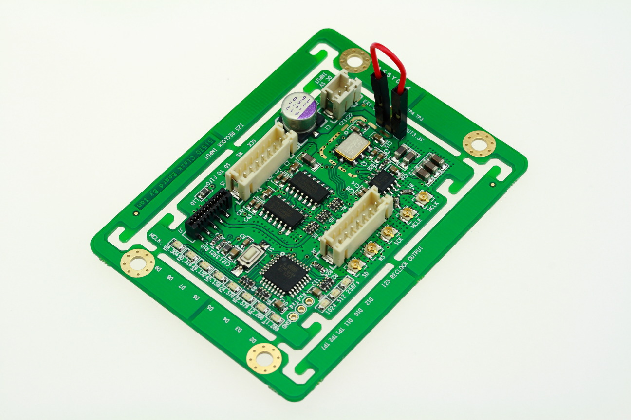

1. Short the input and output of external LDO connector with a jumper (included in the KIT).
2. Must include an isolator board between FIFO and the clock board.
3. Connecting one LiFePO4 battery cell to the DC input connector J2 of the si570 board via a battery management board.
Some comments:
1. Magnet ring is suggested for the battery cable because the load frequency could be very high and wires are too long in this case.
2. If it is possible, try to monitor the battery by a passive voltage meter to avoid any damage caused by over discharge.
