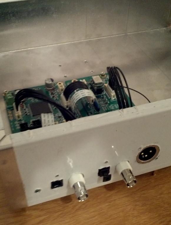

With some files and a cup of beer, here is what i got

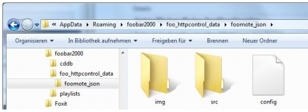

1. Go to Foobar2000 official website download the foo-httpcontrol plug-in, copy the extracted .dll into foobar2000 component folder.
2. Download foomote_json template, create foomate_json folder in the foobar2000 foo_httpcontrol_data folder, than copy the extracted xx folder into that folder
Please note the foo_httpcontrol_data is a system hiden folder, to located it you have to find it by searching %APPDATA%/foobar2000 at Windows7 search

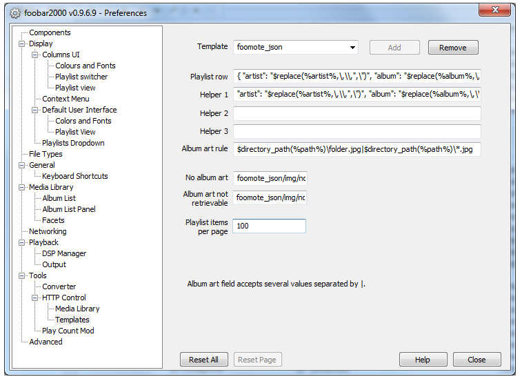

3. Run foobar2000 and configure the plug-in as picture below, confirm to allow win7 firewall not to block it. You have to input the IP of the foobar2000 computer
