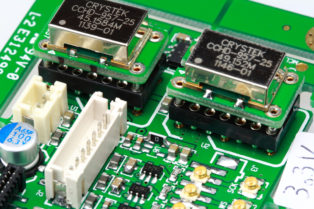

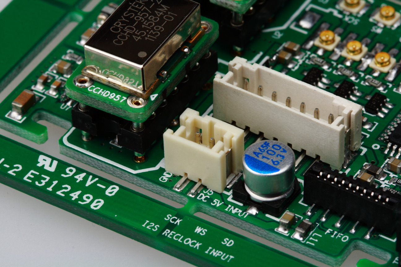

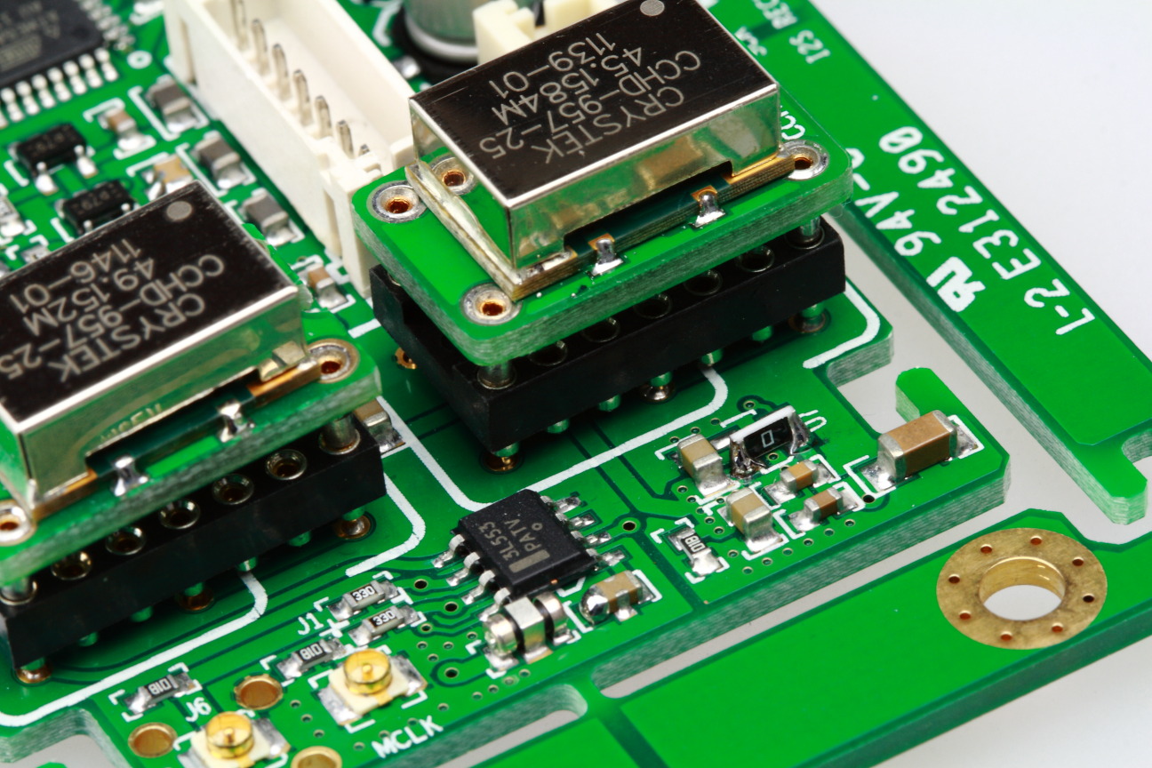

Power the dual XO clock board by 3.2V LiFePO4 battery direct
Some changes have to make to the Dual XO clock board to power it by a LiFePO4 battery cell directly because of the internal LDOs.
Steps (Please see the pictures for details):
1. Remove the two on-board ADP151 3.3V LDOs U7 and U8 from PCB, SMT re-work tool is preferred.
2. Short Pin1 and Pin5 of the footprint of both U7 and U8 by two 0 ohm 1206 chip resistor jumpers.
3. An isolator board must be placed between FIFO and the clock board in your system.
(Without this isolator board, FIFO board could be damaged from the shorting of two power supply)
4. Connecting one LiFePO4 battery cell to the DC input connector J5 on the dual XO clock board via a battery management board.
Some comments:
1. 26650 would be a better choice than the 18650 for selecting the LiFePO4 battery cell.
2. Magnet ring is suggested for the battery cable because of the load frequency could be very high for a clock board.
3. If it is possible, try to monitor the battery voltage by a passive voltage meter to avoid any damage caused by over discharge.
Ian
