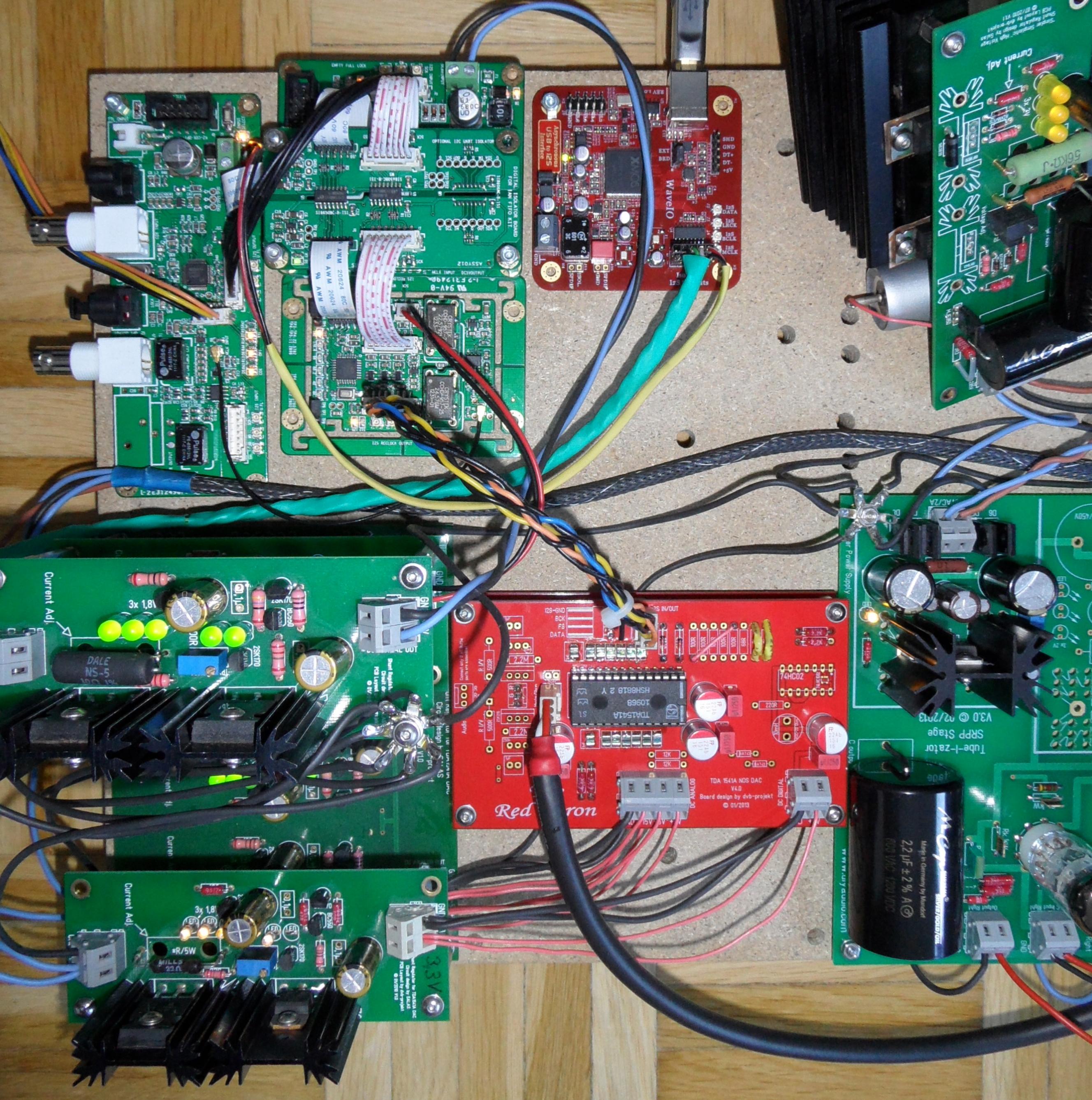

Hi Ian,
good to have you back here! 🙂
I have connect everything to my Red Baron rig. It runs perfect. 😀
Wave IO --> S/PDIF backdoor I2S input --> FIFO --> Isolator --> Dual Clock --> Red Baron --> Tube-I-zator
The 1st Salas SSLV (6V) is for the Wave IO, S/PDIF module, FIFO and Uplink of the Isolator.
The 2nd Salas SSLV (5V) goes only to the Dual Clock and downlink of the Isolator.
As i know from my modified Teralink X2 USB to I2S converter it was a major step forward, after i omit the onboard 3.3V reg. and use a 3.3 SSLV direct.
Is it also possible to omit the dual clock onboard reg. an use a SSLV 3.3V here?

Hi dvb-projekt,
Your system looks great. How's fifo going with your Red Baron and your glass IV?

Hi dvb-projekt,
Ian
It runs perfect.
I did some modifications on the Red Baron that -ecdesigns- recommended.
Therefore i must build up two new pcb´s and i am still in burn in phase.
The first few hours are very promising.
Perhaps you could send me a PM for the direct 3.3V input of the dual clock board.
Even if i ask it before, did you see a chance to get the same input running after powering up the S/PDIF ?
Now it starts every time with the optical input, witch is not nice if you use another input e.g. I2S backdoor...🙁
Oliver

Good to know that, Oliver
Do you want to run the dual xo from 3.3V battery direct? You have to remove the on board low noise LDO. But I don't think it's problem for you. Let me know if you need a picture of the set up.
The source selecting was done by FPGA hardware, the last setting can not be saved and re-called. It's not difficult to design a panel board to take care of the control and display. Last setting can be re-called on next power up. A small MCU would be good for this kind of application, or you can use an Arduino.
I2S back door...? Do you need fixing it?
Ian
