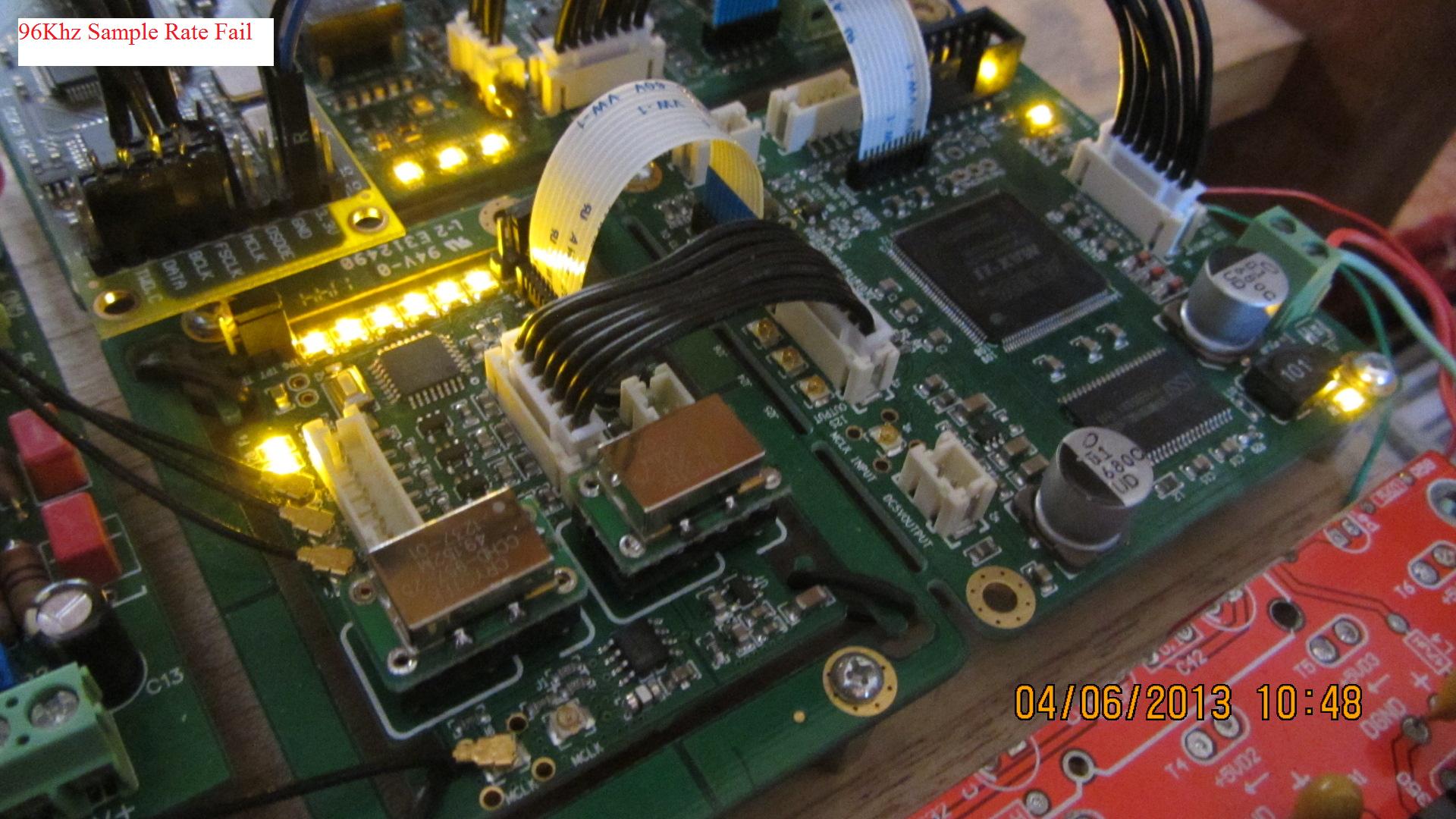

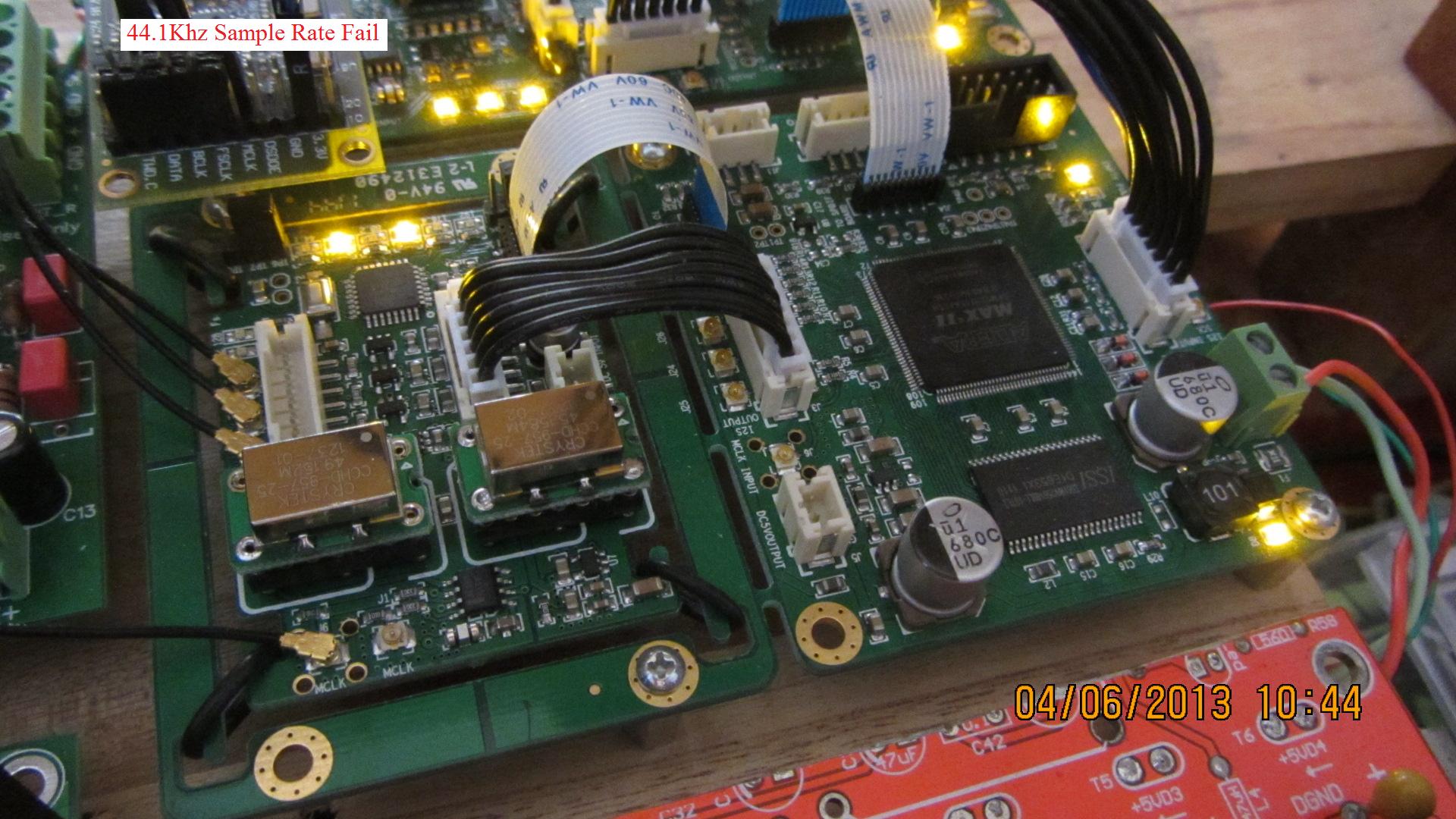

Hi Ian,
I upgraded to double dual clock with crystek 45Mhz & 49Mhz. The sound improved, but I get the error when playing the files with sample rate 44.1 Khz & 96 Khz .
- Sample Rate 96KHz :
All times playing 96kHz files then all Leds on Clock board is flashing. On FIFO, the Led "Emty" is light. No sound.
- Sample Rate 44.1kHz :
On Clock board, The Leds 48Khz & 96Khz is light. On FIFO, the Led "Emty" is light. No sound.
But I noticed that when I playing the file 88khz or 176 Khz, then continue to playing the files 44.1 Khz is ok.🙂
I read but not seen anyone with this error. 😡
Ah, it is necessary to add the 100n capacitor and 1uF for Crystek adapter board ?.
I use PC with Jriver 18 + Amanero .
Thank you .

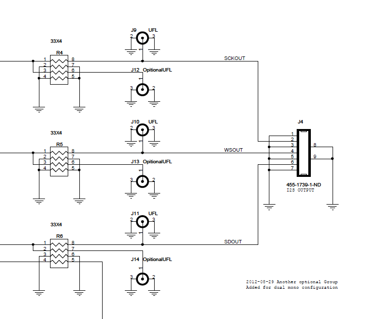

Greetings,
I reolved my issue with the Si clock and synching the es9023 dac. I noticed that the clcok was set to 90/98 Mhz. The es9023 didn't like that speed. I switched to 45/49 and all is good. tried 44.1 and 48khz files without any glitch.
Now, I would like to drive a dual mono with the Si clock board in asynch mode for now. So I soldered the ufl on the second I2S outputs. I get no signal on the second set. Only one channel (N the top set) is functionning.
Is there anything else needed other than the ufl connectors? Jumper I am missing perhaps?
regards.
Greetings,
regards.
Hi necplusultra,
Here is the schematic of the output section of the Si570 clock board. It would easy for you to address the problem with it.
Hope it helps.
Ian
I just noticed this hadn't been addressed. You should not need those caps when using the Crystek XO. The Crystek units have decoupling internally I believe so do not require additional decoupling on the adapter PCB.
Thanks you ,
I thought why not practical test? 🙂 . After listening to both cases, I likes the sound with no capacitors . The sound more open, especially in high frequencies .
