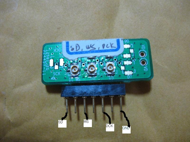

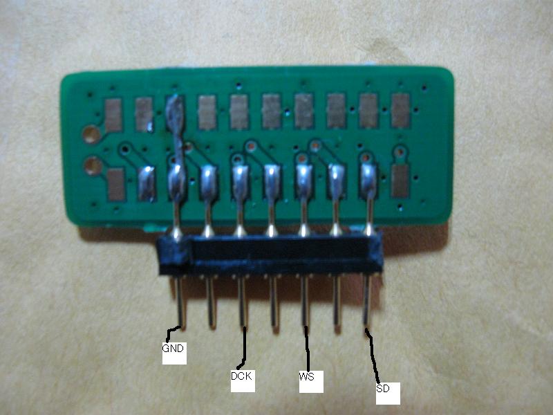

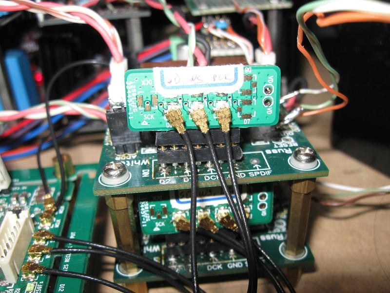

you should try to make more than 1 ground pin somehow, given you have more pins available. perhaps by scraping back some soldermask on the BII
I have checked with DMM and found each gnd pad on the adopter pcb share the same GND
plane. In other words, all u.fl cables' shields are already grounded.
still need to do so?
yes, the BII i2s layout was flawed in this regard. sharing a single pin on the adapter for all the grounds is not good design. you have the extra pins on the adapter, use them.

Part id
Does anyone know the name of the pin connector that was used or a Mouser part number? Thanks.
I hope these pictures explain well.
