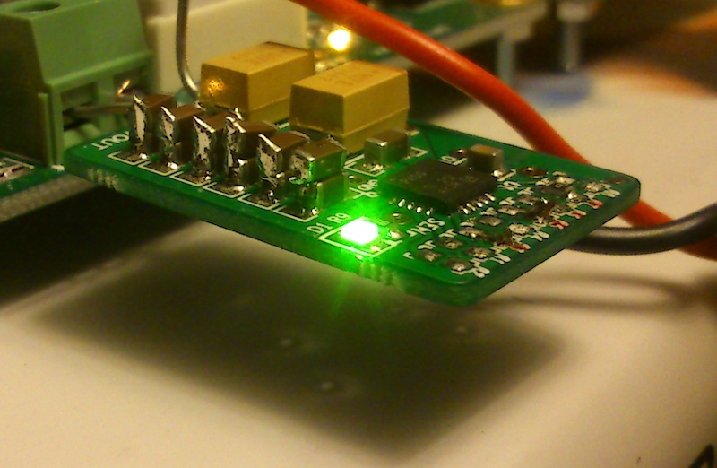

TNT you're using the TPS7A as a pre-regulator for the entire FIFO+clock board setup correct? IE Not as a local LDO reg on the Si570, in the way makumba1966 is using it?
There is a bunch of other local regulators in these devices that you're supplying, for the pre-regulator to make a significant detrimental impact on the sound, I suspect there is something other than caps that are causing your problems.
Could you describe or show the connections you've got to the regulator board? What are you feeding it from?
The first thing that comes to mind is that you may be having thermal issues with the regulator chip with v-drop across the regulator or too much current or combination of these given that this tiny pcb is the only heat sink the regulator has ...
more likely its just the power of suggestion...
stacking the caps creates a longer ground path with each one stacked, worse than having them on the PCB, for it to create an improvement is somewhat confusing to say the least.

yeah well making something worse doesnt often make things better, so you'll excuse my skepticism. the mods described have either added inductance and made the smoothing LESS effective at high frequency (in the case of parallel leaded film caps) or made the return path longer to add extra capacity that isnt needed. 0.6mm ... these must be very small caps... by my reckoning stacking 6 caps vertically makes it about 20mm tall as well as putting all of the return current through a smaller number of vias and turning the stack into a little antenna. the si570 operates at pretty high speed, well up into the RF; stacking caps upwards means the return is further away and the caps are nolonger surrounded by ground fill.
or by vertical do you mean the parts are vertical but still on the PCB plane? i'll see if I can find the paper, even in that case the planar format of stacked film or ceramic caps means that changing the alignment does degrade performance.
in the case of the si570 its a bit more dynamic, but the well placed local decoupling caps and differential mode LCR filters are taking care of transient needs. the load current is 10% of the capability of the regulator. the caps are already more than enough storage, so simply increasing them while making the layout less optimal is pretty unlikely to improve matters. there may be some differences, I wont rule that out, but its not likely to be caused by increasing the capacity
delusion is a strong word, but when talking about supplying an already regulated load that makes it both a high impedance and not terribly dynamic load, so i'm very doubtful its having an effect, even a minor one, let alone one as distinct as you say.. the mind is a funny thing and that you have reported similar findings from doing the same thing after reading about someone else's experience, but with a completely different setup, smells like the power of suggestion to me. that doesnt make you stupid, it just makes you human.
Stacked... I stand by my impression after listening this evening.

there is no listening to stand by anymore.... sorry nothing makes your listening special other than it being yours. you would improve the impedance more by simply directly soldering it instead of using the screw terminals.
or using the load sense connection...
or perhaps more/different smoothing on the reference bypass.
seriously, why you didnt try the 2-3 things designed into the board to play with improving/tuning performance first (neither have been soldered before looking at your board and these actually may lower noise depending) I dont know.
yep, its completely unreasonable to suggest that perhaps using the 2 methods designed into the board and regulator to improve dynamic performance and noise are tried first, before suggesting its better to double output capacitance randomly to 'fix' the unbearably harsh sounding regulator. what was I thinking?
Sense/feedback is specifically there to improve dynamic performance and lower ripple/noise as it relates to the drops caused by the trace resistance and load current. the reference bypass is there specifically to lower noise.
the reference bypass capacitance and output capacitance directly relate to each other and together with the load current, control where the resonant pole in the regulator response/impedance is.
its clear that you have either not read, or do not understand the datasheet. Is it not better to understand the 'problem' and use the proper tools at your disposal?
youve been talking about these regulators for months, for this and other projects. Do you really still not understand their operation?
