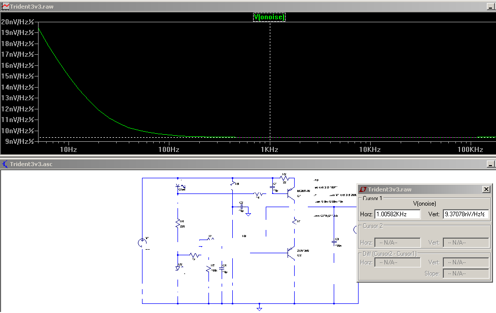

Sorry, I'm a bit confused. Did you find the modded Trident sounded better than the TPS7A4700?
This is not a surprise given the noise of trident regulator: 2.9uVrms, 100Kh bandwidth
The output impedance is almost the same as TPS7A4700 regulator.
I suppose no one imagine an integrated regulator will beat a well designed and implemented discrete regulator 🙂

well its not that far off at 4.17µVrms 100khz bandwidth and whether the trident maintains that same performance at 200mA in reality would be interesting. so I think your scoffing at the idea of an IC being a discrete regulator is a bit unfounded. also 2.9µVrms is hardly world beating as discrete regs go though.
its a nice small discrete reg, but ICs are catching up, certainly its got wider capability in voltage and current
