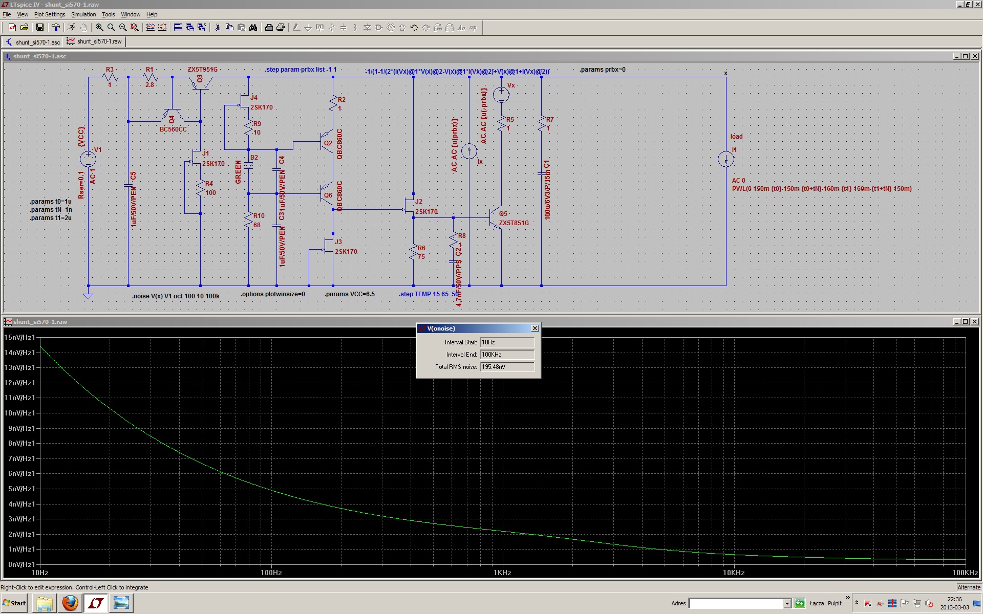

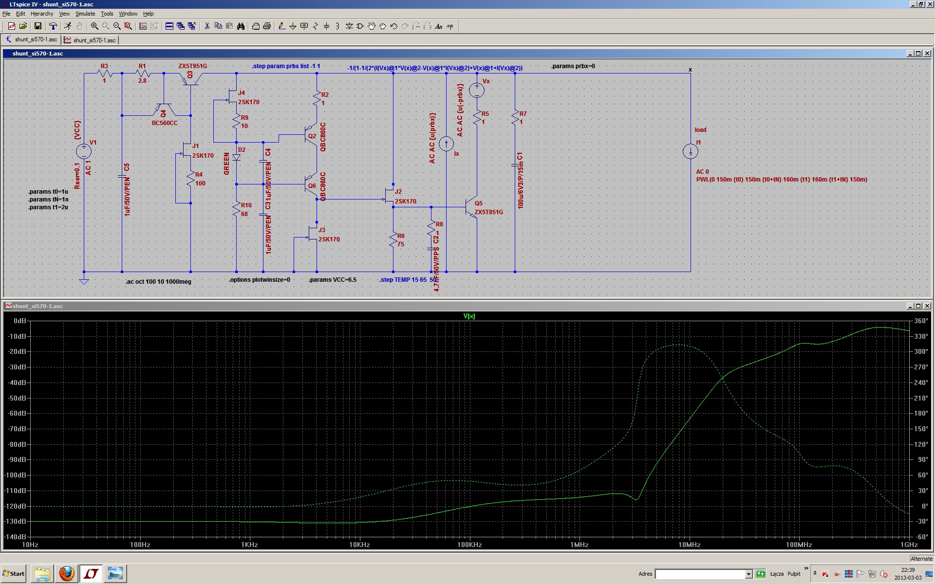

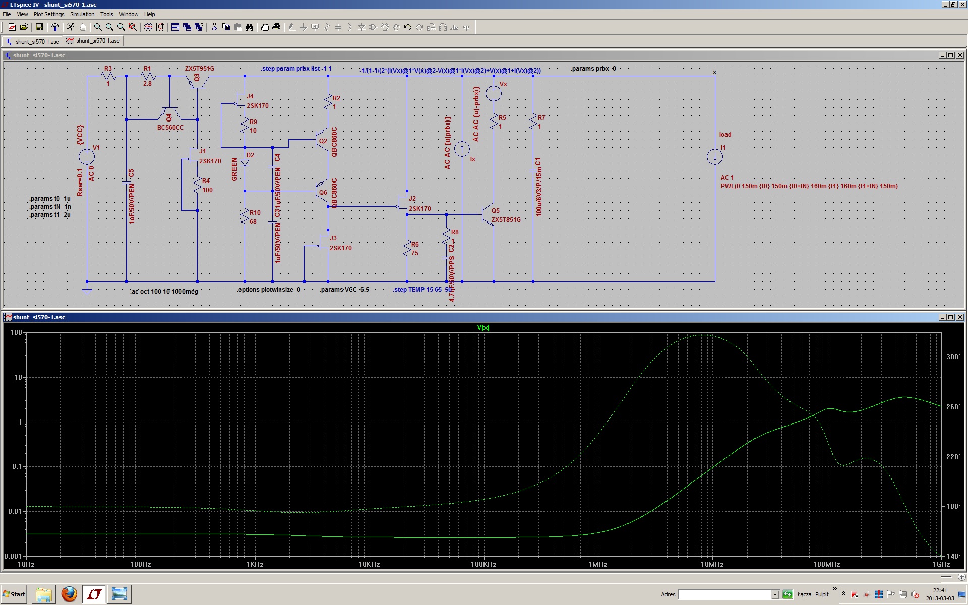

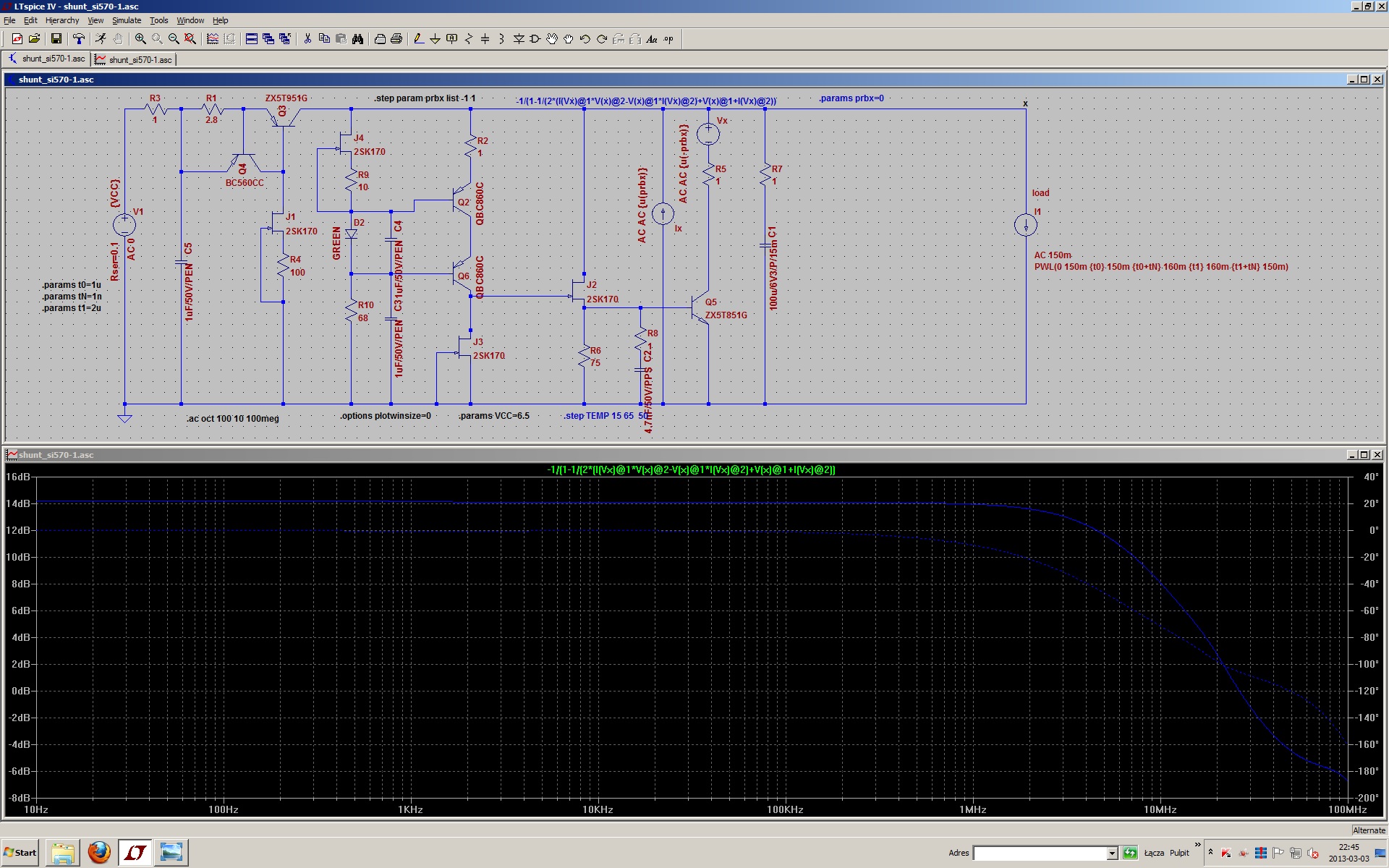

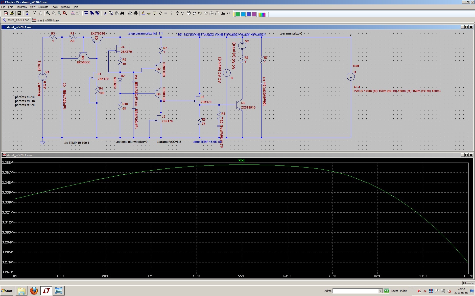

It's fascinating how Si board is sensitive to power regs 🙂 In my last setup I am using single Kemet polymer cap 100u/16v and it's best option so far. While testing TPS board i want build "Salas style" local shunt. Initial sims are promising. Iam using Kemet caps models.

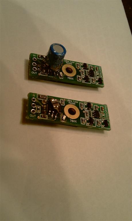

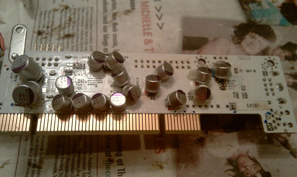

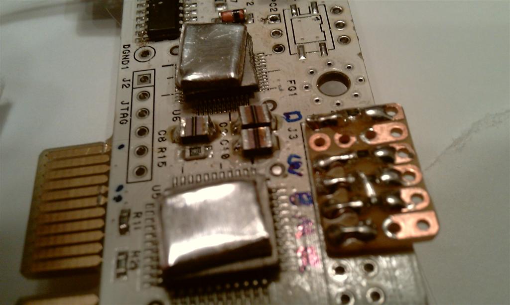

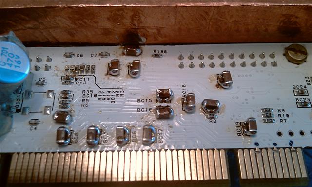

A couple of additional thoughts on the TPS regulator & bypass caps...
I did some experimenting about a year ago with additional local filter caps on the power supply pins of my computer music server's sound card, and ESI Juli@, digital portion only.
I originally did 100uf MLCC (TDKs) everywhere (about 20 total) at each chip's power pins (an relatively easy mod since they already had small C0G's on the back of the board at each location). This made a significant difference in clarity, bass impact, and dynamics AND took about 3 weeks before the ceramic cap signature diminished (a bit of harshness and emphasis in the trebles and over-emphasis of the bass). But the 'ceramic cap' sound never went away.
So I next tried replacing most of the 100uf MLCCs with 50uf or so Oscons. The ones that weren't Oscons were Panasonic 1uf PPS caps, only at the I2S/SPDIF generator chip (AK4114).
This version kept the clarity, but lost some of the bass and dynamics impact. OTOH, the trebles were VERY sweet on this version. These took about a week to settle in and stop changing.
Along with the local reservour caps, I'd also played with replacing the regulators which were modified Dexa units for the 3.3v & 5v. They got a different error op amp (OPA827's) and some additional power bypassing at the op amp pins. With the Oscon trial, I also swapped out 10uf MLCCs there for an Oscon/1uf PPS combon on the 5v reg and 2 1uf PPS on the 3.3v reg where I had less room.
It seemed I needed to be somewhere between the two trials, so the next try used the 100uf MLCCs at each of the deep digital chips (PCI Audio Controller, processor, memory, etc) and kept the PPS at the I2S/SPDIF output chip, the Oscon/PPS combo at the regulator error amps, and added some 1uf PPS caps at the reg's output on the boards.
This was the best of the trials and I've lived with that since. Again, it took a good 3 weeks of constant on and playing to do away with the ceramic cap signature.
I do want to try an all PPS version, but soldering in the 1uf PPS caps across the existing C0G caps without damaging the PPS caps would be very challenging (the whole mod is very challenging!) and I suspect that reducing the amount of capacitance by that much at the power inputs to the deep digital chips would not be an improvement.
All of this is to say these things:
1. In my experience using MLCCs in a digital circuit, it takes a good 3 weeks for the sound to settle.
2. If you try the MLCCs again and don't like them after they settle-in, try PPS caps as someone else suggested, perhaps as bypasses across mid-sized Oscons (10uf-50uf or so). I use either through-hole or SMD (with the plastic base removed) Oscons and bend the pins so I can nestle the PPS caps at the base of the Oscons soldered between the two pins, with them bent to allow soldering to the pads while keeping the leads ultra-short. I use a dab of hot-melt glue to help keep things from moving and damaging the PPS caps during mounting and mounting to the board.
3. Funny that Bunpei hasn't mentioned this, but I know that one of the updates to their SD card player is to add some PPS caps as bypasses at the chips.
4. That seems to be getting more popular, with John Brown in the monster TDA1541 thread doing that along with EUVL in the latest version of his ES9022 DAC card (check the latest pix he posted of them... also, I'm using that card mounted on the Juli@) and Fitzfish using them on his ES9022 (or ES9023, I don't remember)-based DAC.
Greg in Mississippi
P.S. Bunpei, do you still use the large CDE Polyprop caps on your DAC's AVCC?
