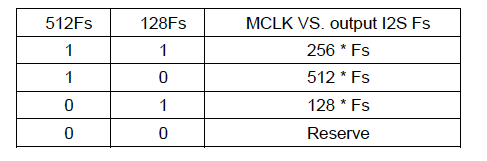

Ian, what configuration of optional control signals output port (J13, pins 2 and 3 - FIFO board) if Dual XO board in dual speed mode (XO-s 45.1584 and 49.1520 MHz) ?

I think we've misunderstood vd-two's question guys, I didn't get it until just now, re-reading the FIFO manual.
J13 is the output port to monitor *FS currently used, is this the same in 'normal' and 'double speed' modes? He isn't asking about setting the double speed mode, but how to use the J13 port to monitor while the FIFO is set for double speed, the current version of manual has missed this configuration by the looks.
The Page 6 of the FIFO manual shows this lookup table for J13 pin 2 and 3:
attachment.php
Is it fair to guess that 0, 0 might indicate 1024*Fs? This would be consistent with the LED status notifications so would make sense, I think.
