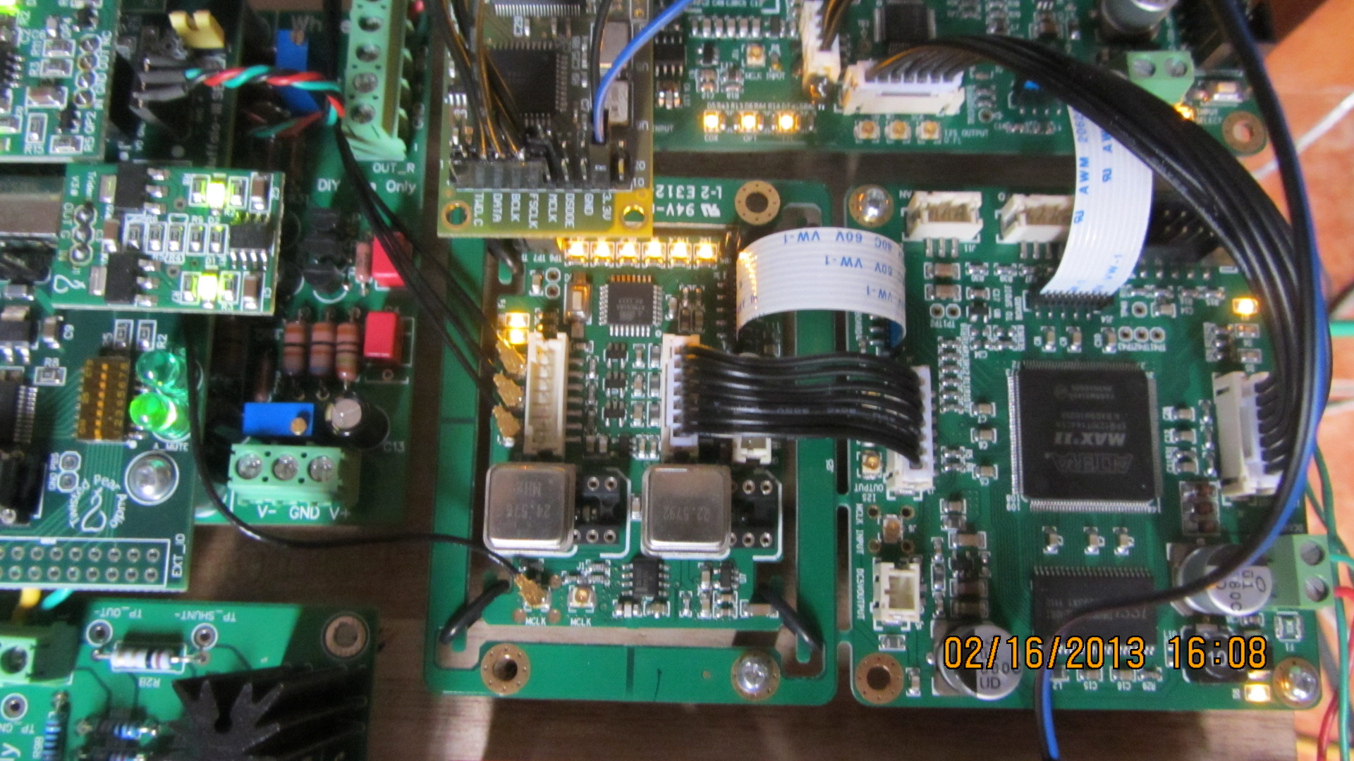

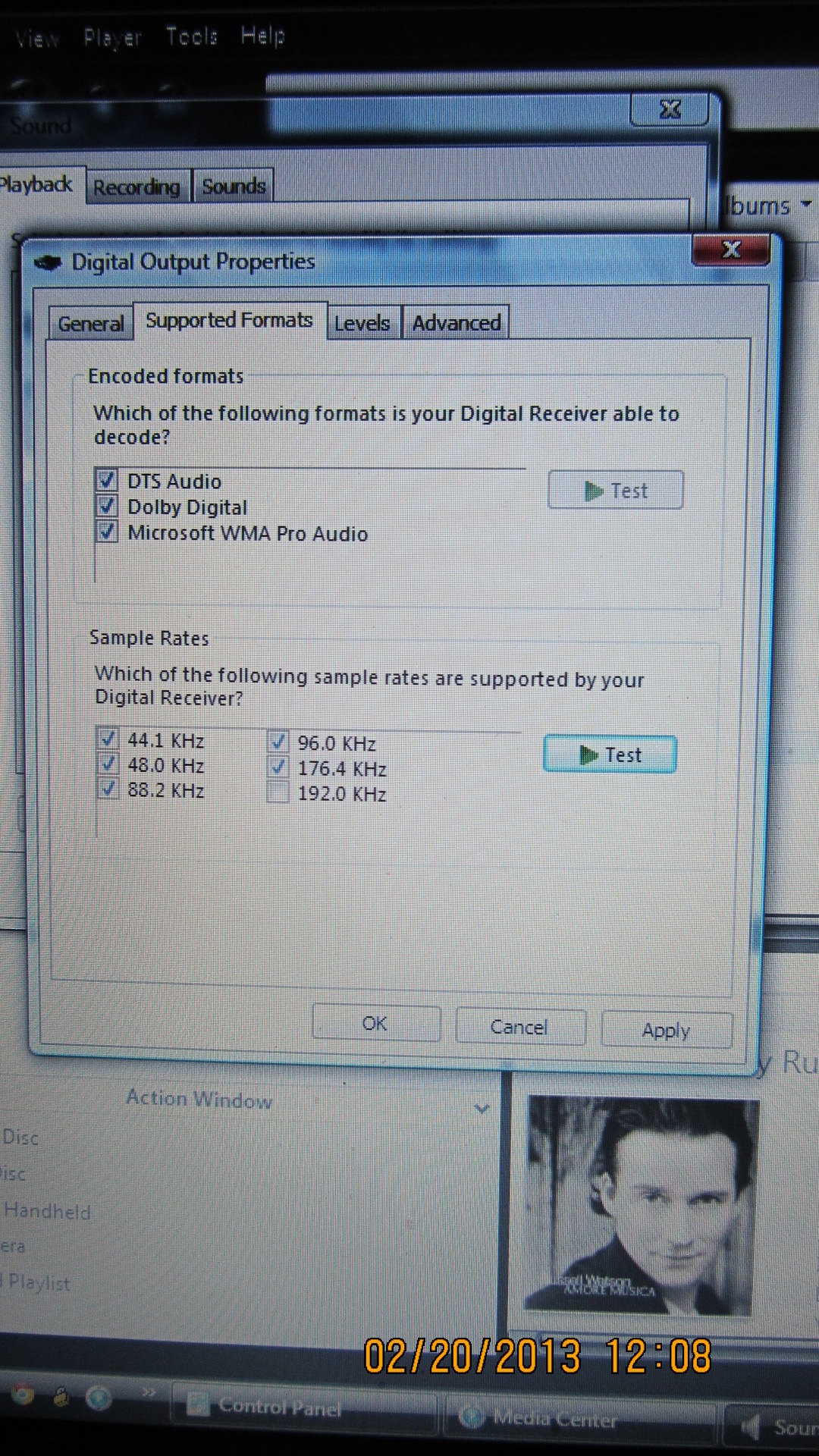

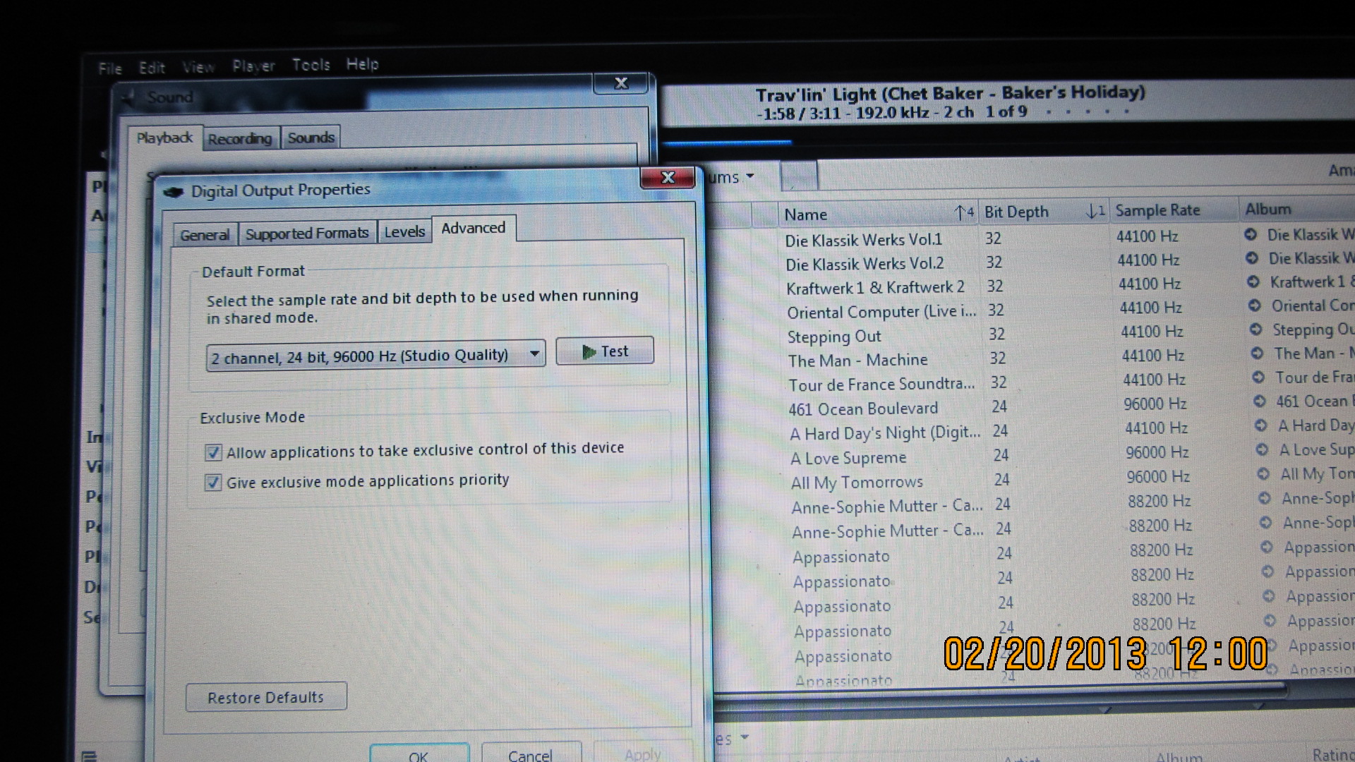

With Jriver 17 in Output mode is Drirect Sound or Wave out, my lossless system play normally but trouble with other Output mode, ex : Kernel Streaming, WASAPI output & WASAPI output-Event Style. Jriver 17 still playing but no sound and I see all the LEDs flashing in the DualXO clock board. Does anyone have this case ?. This error also appears when I use the Empirical Off-ramp 3.
Do you have a oscilloscope? Can you find out what's wrong with the I2S signal?
In your normal playing, does dual xo clock board switching between 44.1K and 96K without problem?

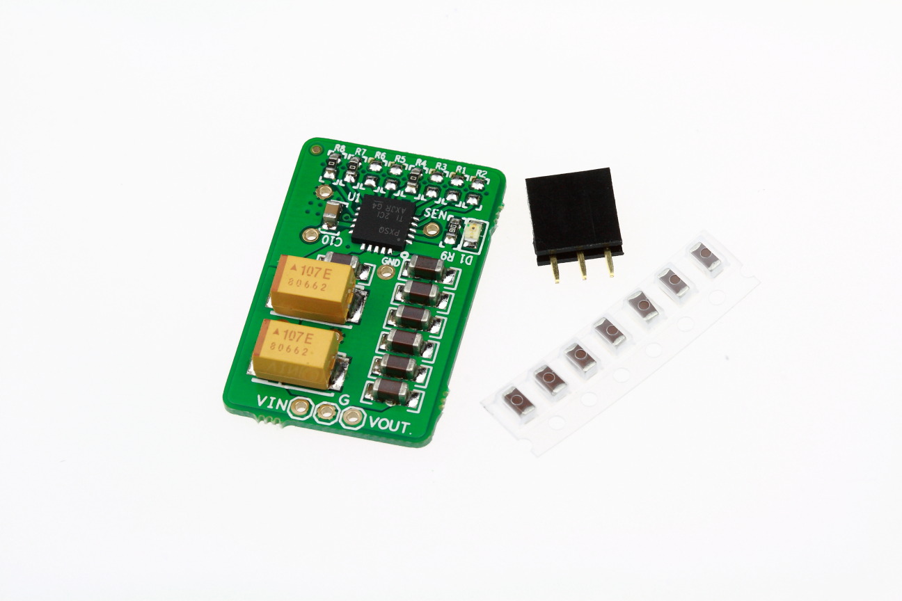

The pic Ian attached to the GBIV is probably the best one for it, there is a dot on the top corner of the TPS chip.
Note there are a few subtle changes to the layout of the board below, the chip orientation doesn't appear to be one of them though 🙂
At a glance the changes are something like: Extra output cap for 6 x10uF rather than 5x10uF; change of position for LED+resistor; Larger value input caps (now total of 200uF rather than 100uF total previously); there may be a few other tweaks Ian has done too, regardless, I don't think the prototype TPS7A regs had any inherent problems.
Ian
I resolved by setting the "Default format" in "Control Panel \ Sound" to the limit that my Amanero can get. Now, this error still occur when play files with format 24bit/192khz. I updated Amanero with the latest firmware and drivers.
