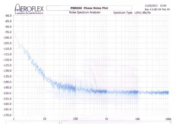

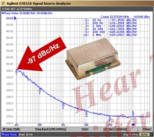

Well, let me know the difference measuring a standard XO like the Crystek and a state of the art OCXO like the HCD.
Take a look at the attached image, maybe is easier measuring the state of the art device, since 1 Hz offset from the carrier is showed? Or simply Crystek choice to not display the result at 1 Hz offset? At the bottom of the phase noise analisys you can read: Start 10Hz. But such kind of Agilent measures below 1 Hz.
Well, now let me know the difference starting at 1 Hz or 10 Hz with an Agilent E50 or E55 series or an Aeroflex PN9000.
I'm very curious.
P.S. An useful link to convert phase noise into RMS jitter
http://www.raltron.com/cust/tools/osc2.asp

Keep in mind, I know the answer, HCD build the OCXO as a custom part for me, so I know how many time they spent to trace the phase noise...
again, if was not clear... WITH THE PROPER EQUIPMENT.
if I wasnt clear, even with the proper equipment, it still isnt a simple or quick issue. ask them how long it took them and how much their test fixture cost them where you bought the XO's. good chance they built and characterized a buffer and its performance is deducted from the measurement
You have to read more carefully, as I said I know how many time they spent to measure the OCXO, and I don't tell you, since seems you already know that.
Maybe you don't know these are automatic phase noise measurement system, with built-in ultra low phase noise reference OCXO, ultra low noise preamplifier and a PLL to tune the exact frequency under test. The spectrum analyzer display the result, automatically. Just tuning the PLL.
The cost of such that equipment can vary from 20.000 USD up to 100.000 USD or more. But this is out of context, since I said several times "with the proper equipment" and I never said there is a cheap way to do that.
But seems you have no intention to step back, so I give up.
right, OK so you make a completely useless suggestion that has no relevance to anyone at all apart from a company making XO's
even with that I doubt very much its like operating an easybake oven
