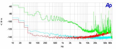

Please, take a look at the attached image, green and blue trace: from battery and from a commercial regulator.
Try to guess which trace is the battery.
ahh yes, that old measurement... I wonder when people will stop referring to these measures as relevant?
the late great low noise Guru Jim Williams of Linear Technologies always used and recommended batteries for verifying noise performance of regulators and voltage references and that was before more modern lower impedance cells were available. do you really suggest that he was getting performance like you link?
most of the measures for battery noise that are relevant to audio are old and/or produced by companies that sell regulators.... i'm yet to see something using technologies any more modern than SLA or perhaps NIMH (not sure if ive even seen that, cant remember)
also the noise of batteries can be very load dependent, clocks and low current class A or CCS loads arent terribly effected by this. there are advantages to both ways, regulators can get lower impedance, but then you can just add some caps or an LCR to the battery to get the noise down and improve transient response. its a power source, use it competently.
