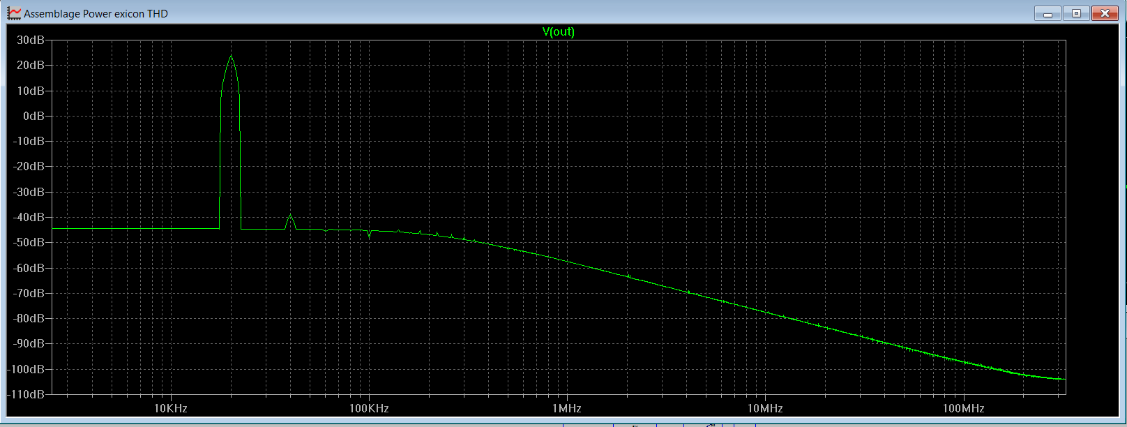

Now I am beguining to understand what it means to have a low THD prediction at 1v 20kHz..... It sounds outstandingly open detailed and accurate.

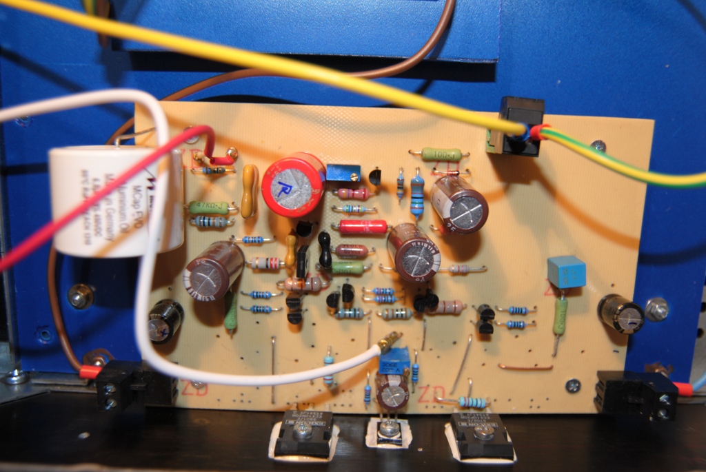

Now connected to my main system I confirm my initial impressions.
Bass is present but not overwhelming while retaining a very good detail. I like that because bass "contrabaixo" is one of my preferred instruments as it was one I used to play in the old days 🙂.... NHOP sounds really good in the several pieces I listened to.
Mids are well integrated and convey a credible presentation to the whole.
Highs are good but do seem to lack that "ultimate" spatiality I am used from the Meridian or Quad amps I use normally.
Stage width is quite good and the amp is quite "musical" in the sence that makes us forget about it and really listen to the music.
As for reality, it lacks the "finesse" of the Meridian particularly with piano and some wind instruments that tend to be slightly "hard".
I believe this is the typical signature of SM caps that I used for miller so I plan to replace those with something less hard but as detailed as.... I particularly like the copper foil on polystyrene from relcap..... Now I have one important question... I have two 30pF caps of this type, can I replace the 47pf miller for those 30pf without impairing the amp stability ?

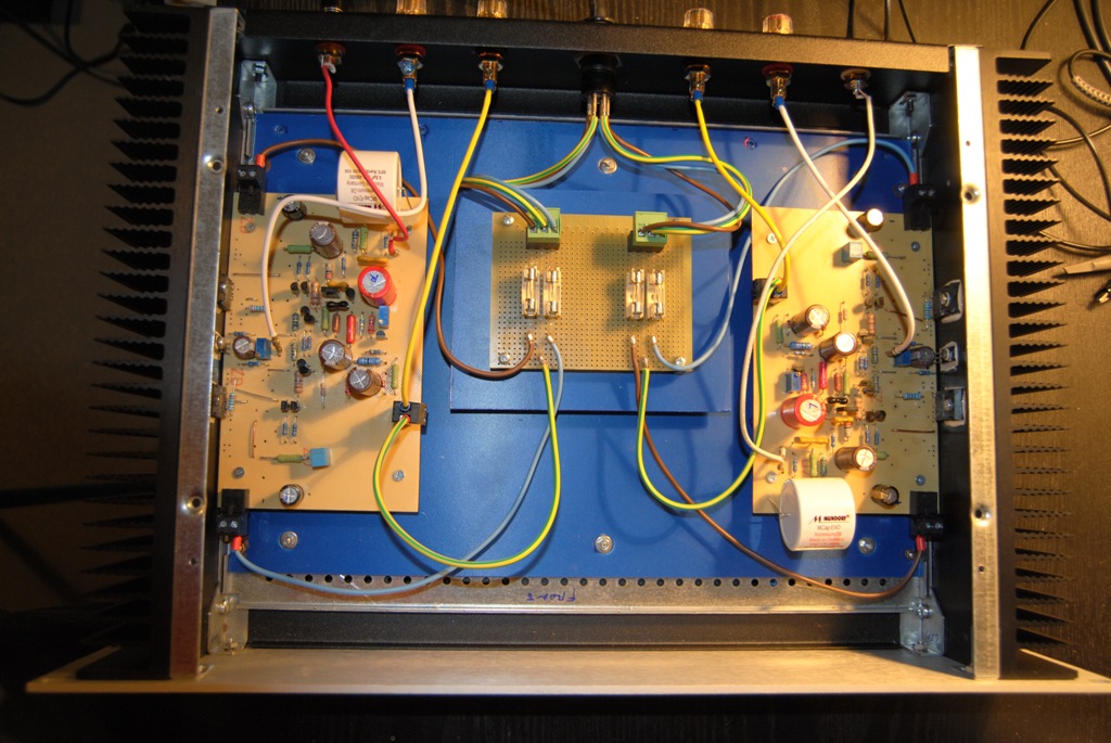

Hi
I suspect the area of your fuse board, with its long, wandering leads is going to cause problems in the amplifier since they carry the power supply and all its switching pulse energy is free to radiate to the feedback and input sections. That increases HF distortion.
Consider reducing that loop area of the supply by shrinking the fuse board drastically and mounting it right at the power connector. Then twist the supply lead pairs to the boards to cancel radiated EM fields and reduce their overall length to a minimum.

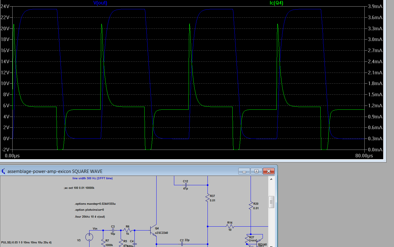

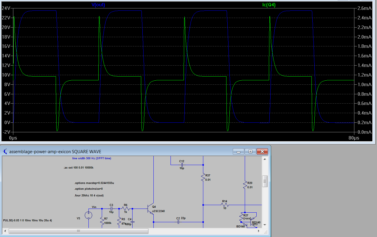

After some more listening sessions I believe the treble should be improved. It is somehow "splashy".
I believe I am experiencing the effects of too low slew rate.
Input transistor collector current presents compression when I input 1v at high frequencies square wave.
Reducing the miller cap to 20p seems to improve matters a lot (in simulation)
Can I replace the 47p cap without fear of oscilations ?
The BD140 used for VAS has a rather high Cob.... maybe it can cope with a smaller miller cap.
See what happens at the current on the collector of the input transistor when we input a 1v square wave.
One pic with 47p for miller, the other with 10p in the same location....
Can I reduce the miller cap without needing to increase gain ? (I would like to keep NFB as is)
When using 22p the simulation shows 22dB/66deg. 10p gives 21dB/64deg, still usable. That should be enough.
