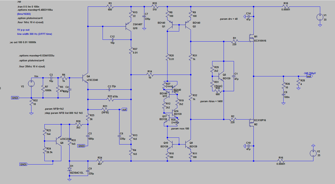

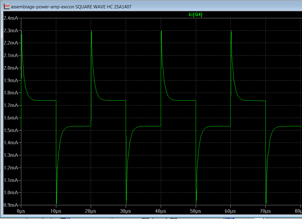

I am getting really nice spikes in the input transistor collector using 2SA1407 running at 11mA.....
Please verify my 2SA1407 model and I would also appreciate stability confirmation (Frans 🙂)
This is looking really promising.

Due to the high cost and dubious spice model the 2SA1407 is off.

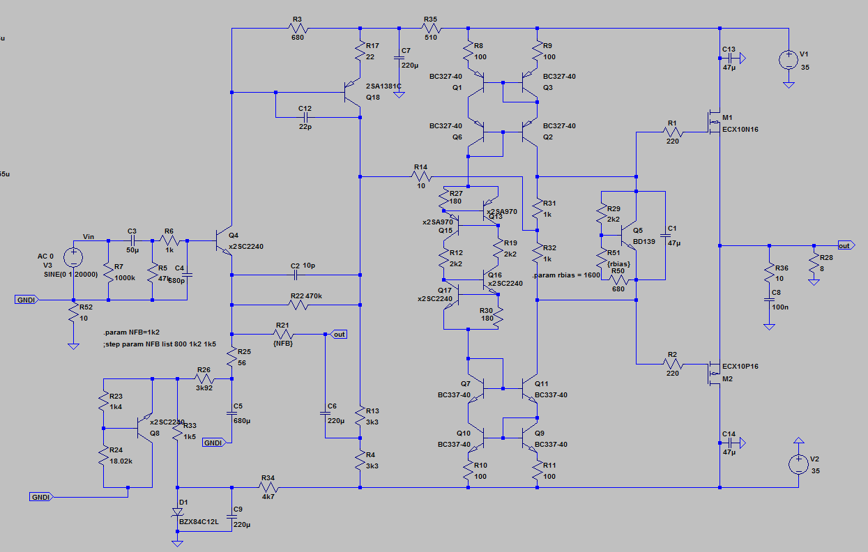

I Found the 2SA1381 that I can get from reichelt and included in the Cordell lib.
So here is my last sim that looks ok.
I will now rest and wait for your approval and fine-tuning if possible 🙂
I have been simulating with this last version and I can not see instabilities using low Cdom values but I am not sure..... Looking forward for some input from you guys 🙂
I would just build it.
You can adjust the square wave later with capacitive load.
Say 8 Ohm in parallel with 0.1uF.
When you use a dynamic speaker and your cable is not super high capacitance the stability will not be taxed anyway.
A dynamic speaker behaves more like an inductor at higher frequencies.

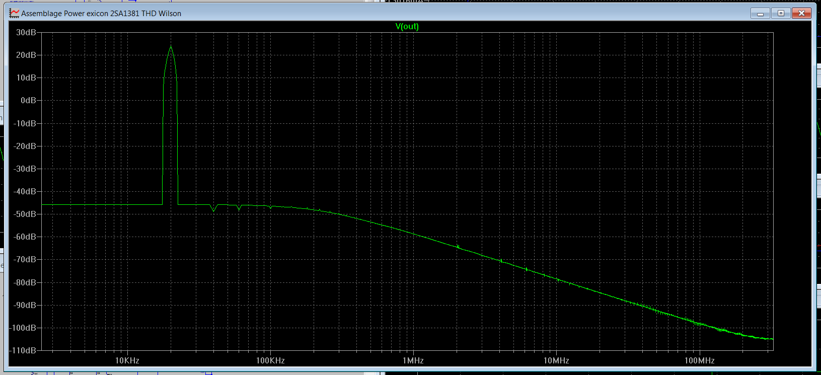

So this 0.1uF would be the worst case cable capacitance right ?
In simulation, this cap produces a nasty rise in gain from 27dB to 32dB at 1.9MHz.... this peaking might indicate instability.
Placing a 50uH in series with the 8ohm load does not affect stability.
I will build it and trim Cdom latter.

For simulating phase margin you can add a little capacitance in parallel with the load, say 1nF, which will give you some idea as to how sensitive the amp is to nasty cables.
I'd add a resistor in series with R24 so that the adjustment of dc-offset is easier, less sensitive.
I'm unfamiliar with the output FETs you've chosen. In the final design it might be prudent to allow for some footprints on the pcb for additional SMT components to tame any vhf instability that FETs can exhibit. By this I mean add a gate-drain zobel (see my TGM8 schematic).
You have no output source resistors - is this OK ?
On a completely crazy note - I wonder if you could throw out the current mirrors and use double bootstrap for the Vbe multiplier to give more voltage headroom for those FETs ?

Off course but that would mean I would be building the TGM8 instead.
Remember the initial idea was to develop the Nobrainer loosing it's opamp input stage... that is why I searched for Gareth's singleton input.
Anyway it works really well... just needs some finetunning to improve it's treble.

It seems quite sensitive to capacitive loads .... will mod it soon and verify in reality.
Did not detect any nasties with the scope so I believe it is really stable without the zobel from gate to drain.
I get lower distortion without the source resistors and I believe they are not needed with this type of laterals as long as they are not paralleled.
Anyway this is Miibs output stage 🙂 So I'm cool
