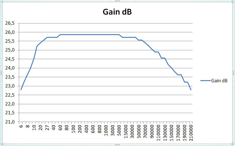

Gain
if you want better LF response increase C-1 to a larger size. evt like 2,2mF
C1 bypassing the bias vbe multiplier is already 47uF.
