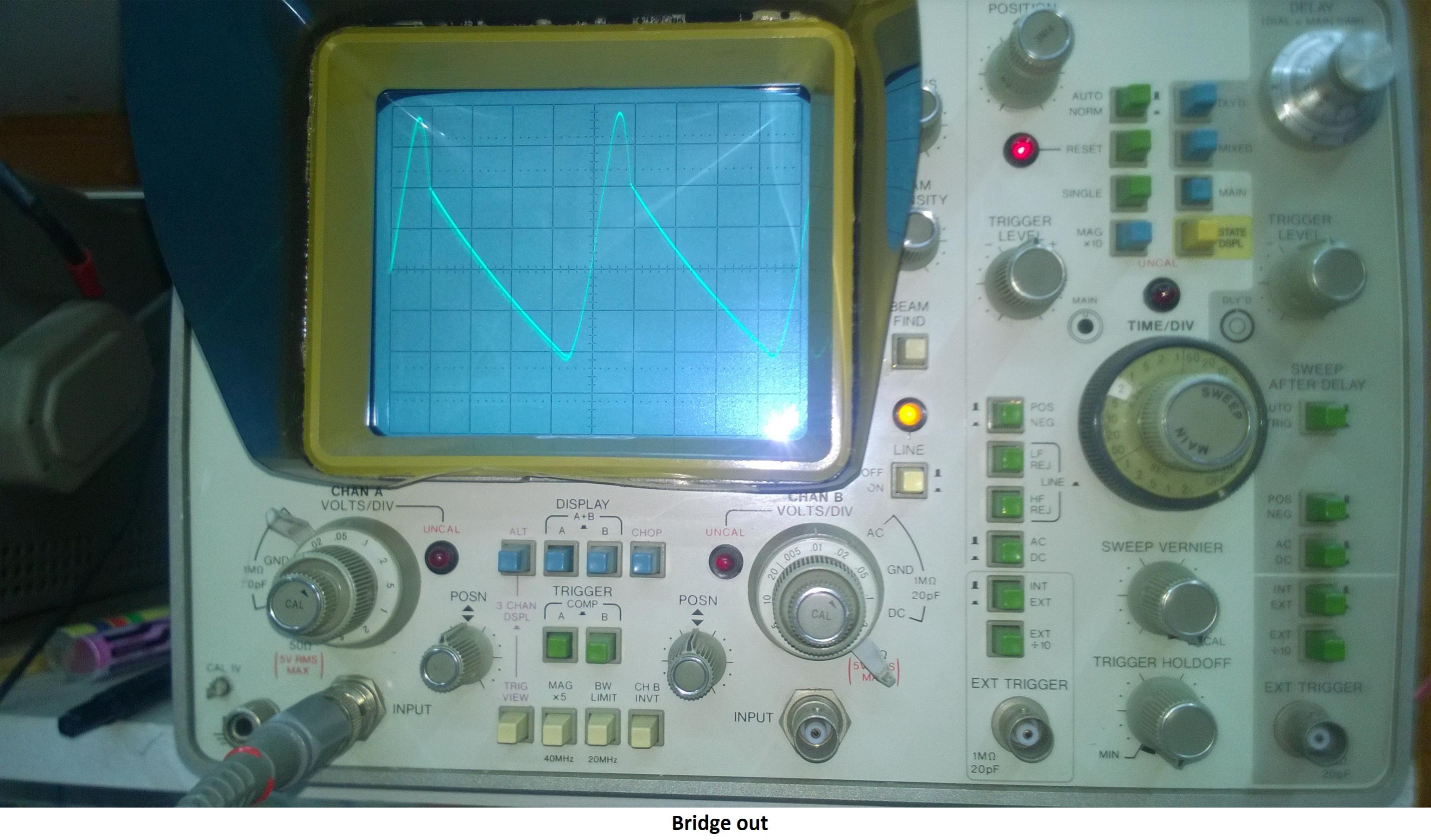

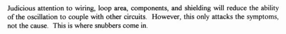

It's not the rectifier diodes by themselves, it's their turnoff delay (speaking of the common and ubiquitous 1N400x series) that gives a short current pulse causing the stray inductance of the transformer secondary to ring with stray capacitance, giving a large RF pulse that radiates and gets picked up by nearby circuitry. Due to the nature of it being transmitted, adding extra filtering to the power rails won't do much to fix it. It has to be fixed at the source where it's generated.
There are two common solutions, one is adding an RC snubber circuit across each rectifier and/or each secondary winding, the other is using modern rectifiers that switch off much faster when the current reverses. Both have been discussed here on diyaudio.

The diode shootout in Linear Audio Volume 10, showed a strong correlation between reverse recovery time "Trr" and ringing amplitude. It showed an even stronger correlation between "Softness Ratio (Tb/Ta)" and ringing amplitude. But lots of today's diodes were introduced long long ago, and their datasheets were written long long ago. They were written so long ago that manufacturers did not measure or specify Softness Ratio.
So, if you find yourself far away from your copy of the LA article, with its table of diode specific part numbers and their ranking on the ringing amplitude test, it's convenient to pretend that smallness of ringing amplitude is perfectly correlated to diode recovery speed. It's not true but it probably is useful. Certainly that will prevent you from choosing the five worst diodes, for example.

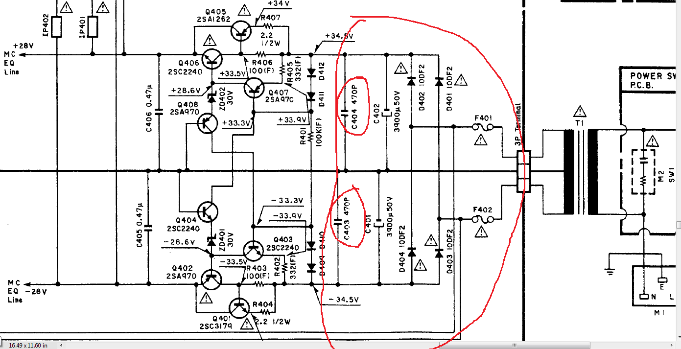

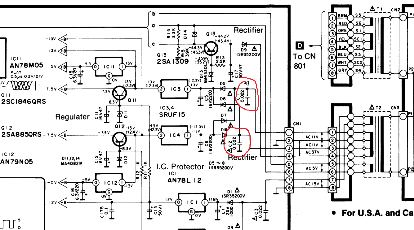

you might be true...I just looked at Nakamichi CA-7 and ca-50 high end preamp and their bridge is composed of fast rectifiers, but weird enough they have a supplementary 470pf capacitor across the output of the bridge...:

yet if i look at tecnics sl-p1000 cd player i see no high freq diode in their rectifier bridge, but i see the classical 22nf cap from the bridge input to ground...

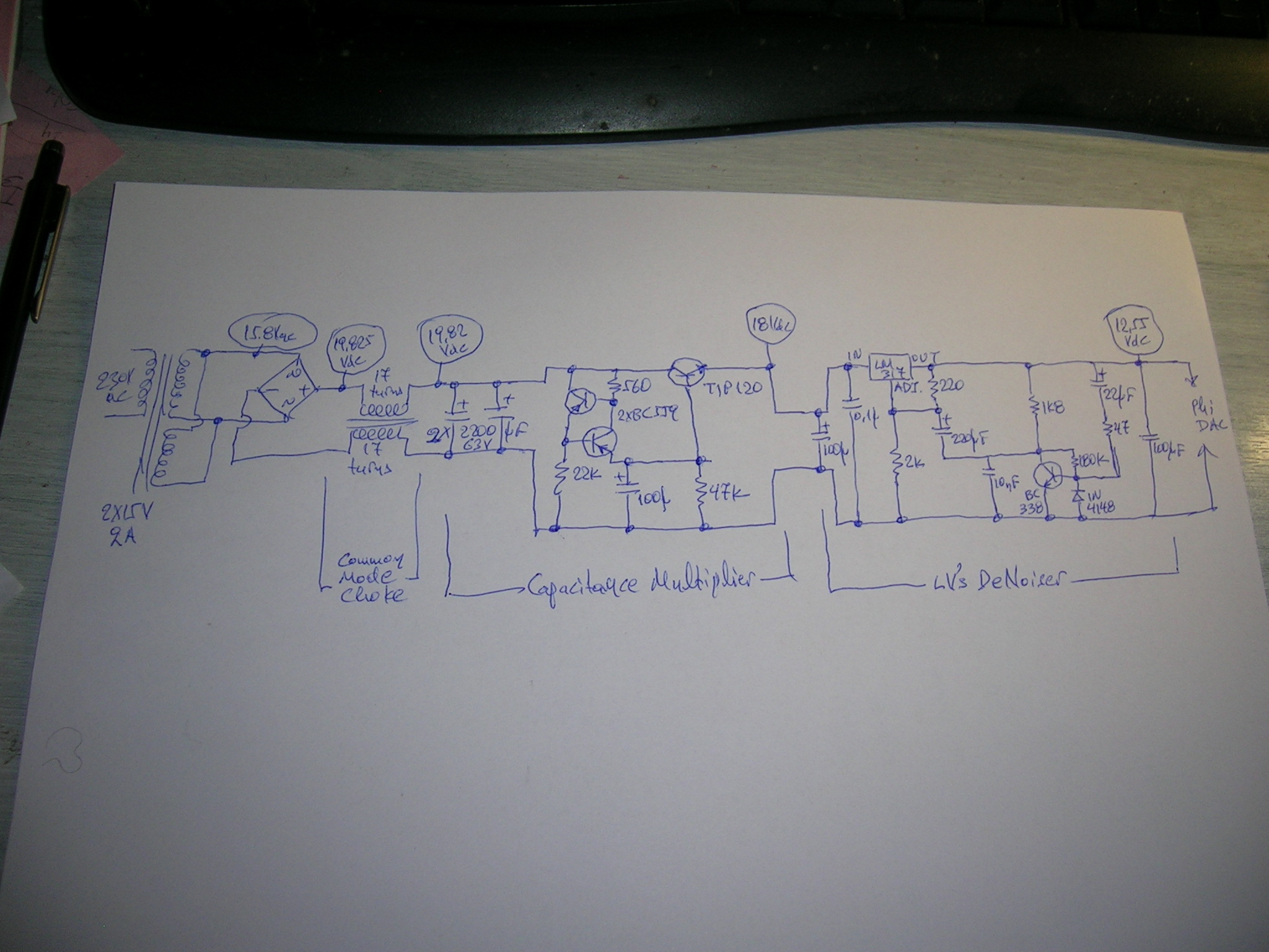

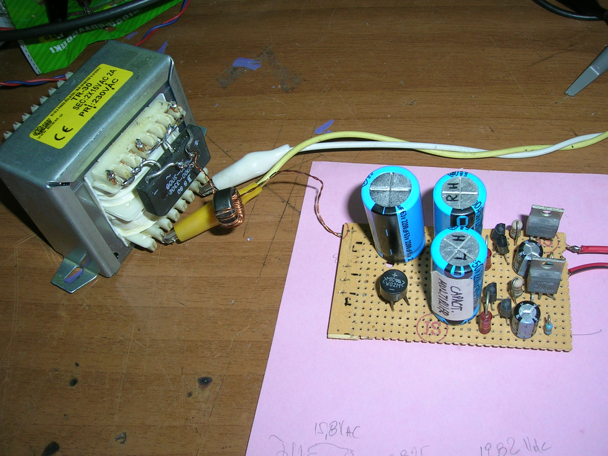

The wiring route from transformer's secondary to rectifying bridge to cap bank carries the HF spurae and spreads EMI pollution.
I keep the bridge very close to the transformer and if possible the caps as well.

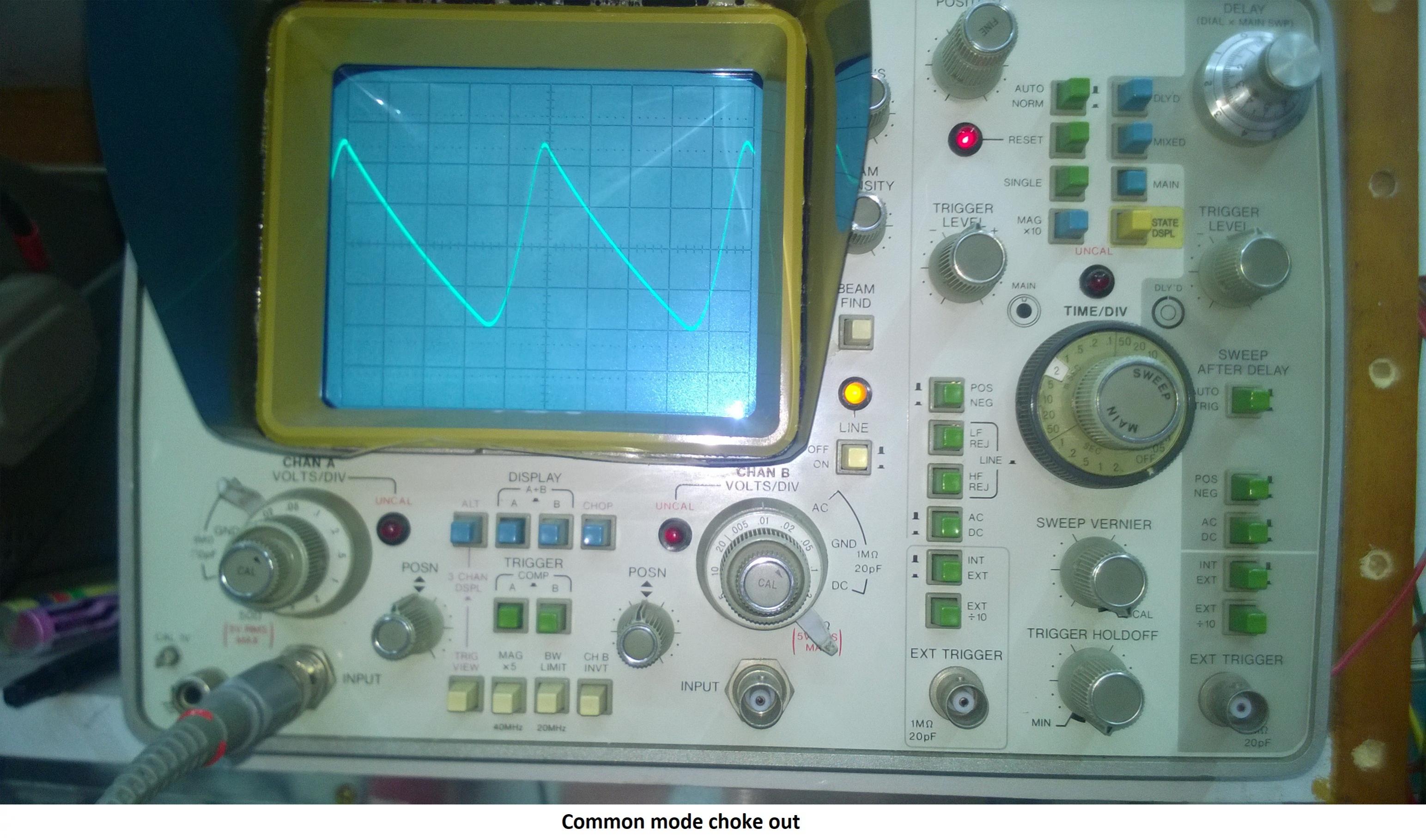

If not, I place a common mode choke in series to the distant caps (and twisted wiring).

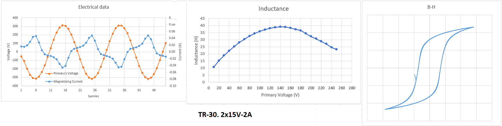

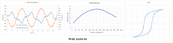

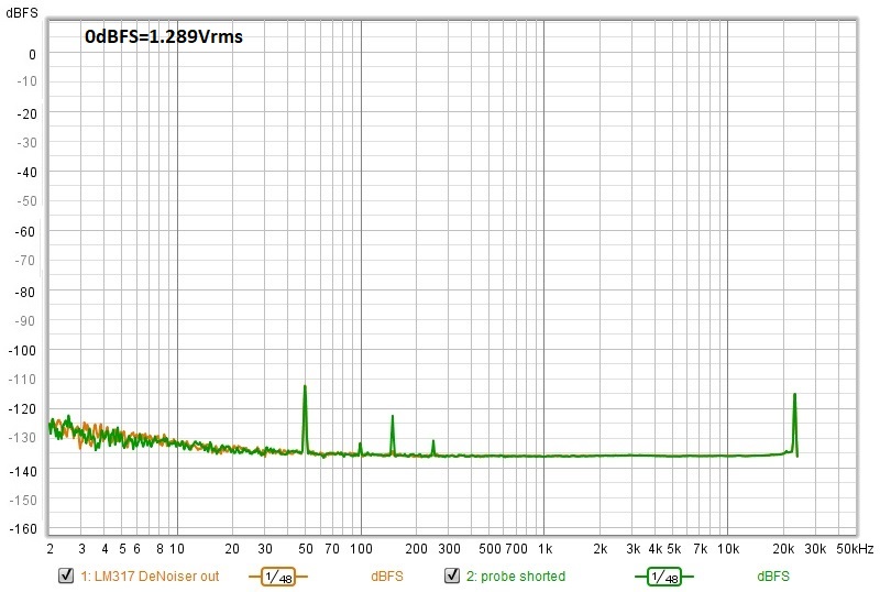

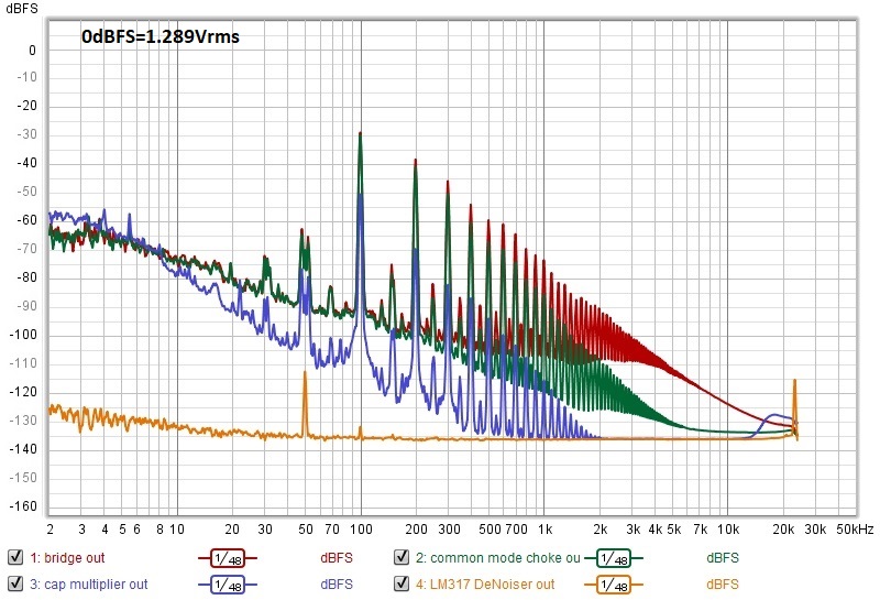

Regarding transformers, all those I have measured start to saturate at around 70% of their rated main's voltage.
It helps with voltage self stabilisation, but once saturation commences, magnetic flux leakage increases, making the transformer add to the EMI spread.
George
