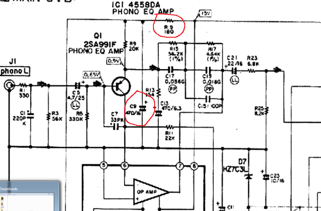

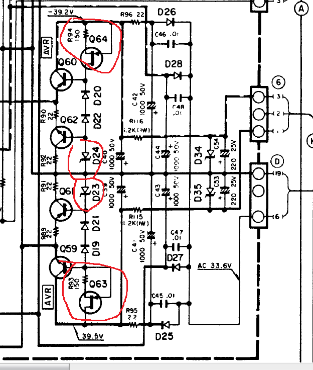

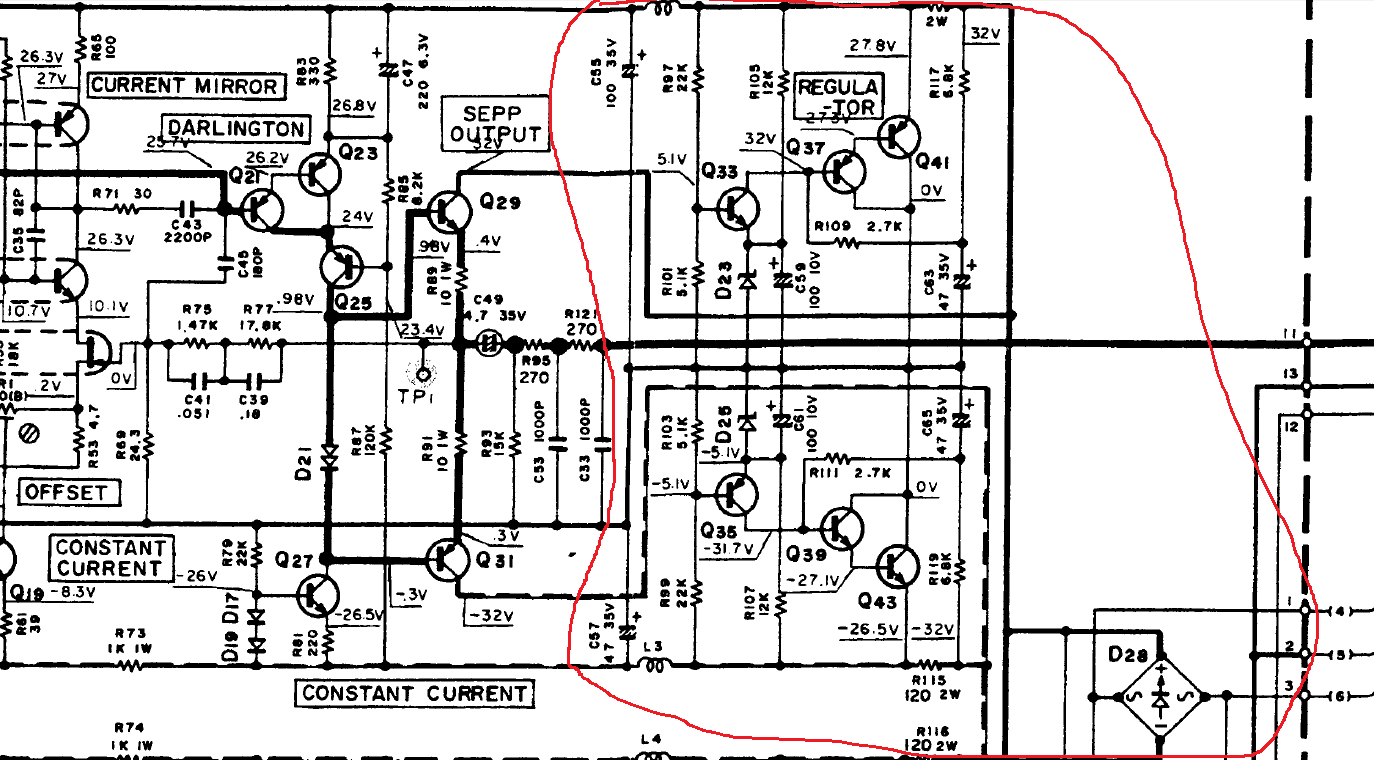

The previous post had some parts of a schematic that used a +-20v dc series reglator after another series +-24v reglator in order to spply a phono preamp...
i understand the beneffits of Jung Didden reg yet it looks like they are made for circuits with no PSRR of their own...
some very advanced phono preamps used some of these circuits, but their lowest noise stages had it all sorted out straight from their own internal current sorces...

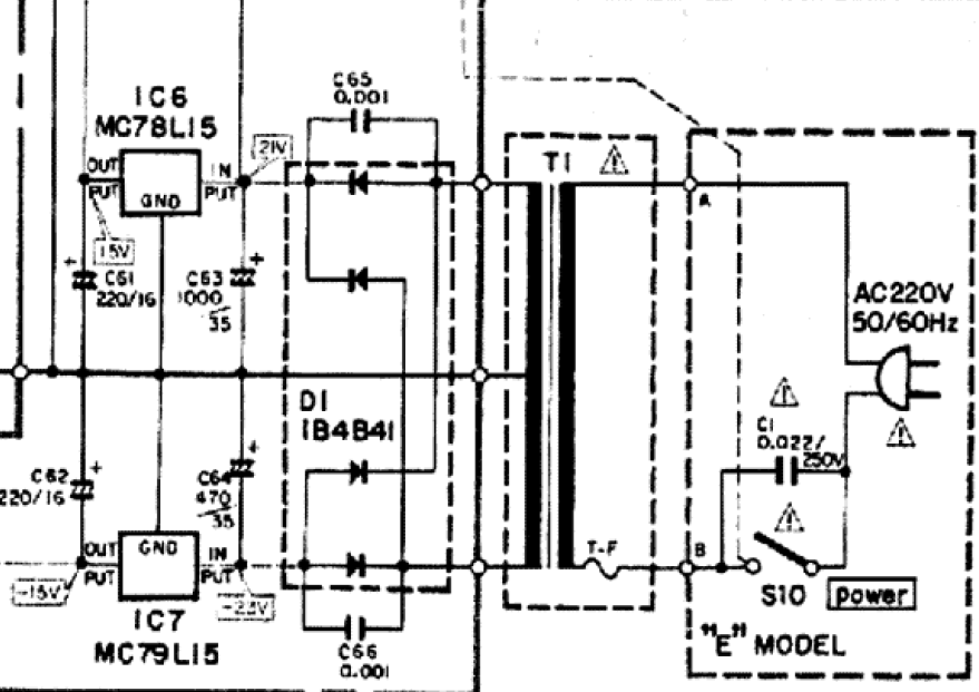

i have a successful semi-professional recording soundcard using Linear technology switching regulators for +-12v of all dacs and op-amps inside and the switching chip is actually designed in the 90's while the soundcard was made in 2016, best sales on Amazon for a sondcard in 2017 and still in production for a higher price than in 2017 when i purchessed mine...Audient ID22

if yo don't like having no regulator at all yo can simply go with the L version of 78/79xx regulators and an additional rc filter for the most sensitive parts.OP-amps have their own PSRR which isn't really bad most of the times.

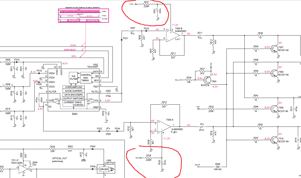

To answer the original question: that depends on the circuit that is to be supplied. In most cases cheap IC voltage regulators work well enough, but if it is some low noise circuit with a limited PSRR or a DAC reference, I would insert a brute-force low-pass filter to get rid of the regulator's noise, or use a very low noise IC regulator like an LT3042 (which gets its low noise by brute force low-pass filtering between its reference and the rest), or use some other type of regulator.

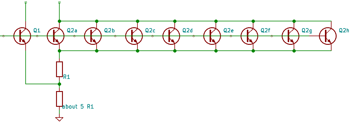

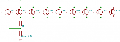

If I understood correctly, a bandgap reference can be made from a diode and a resistor connected in series with one end to ground and supplied current by a constant current source. If the resistor has a positive temperature coefficient 'a', then the resistance should satisfy 0.002 = a.R.I, where R is the value of the series resistance and I the constant current. The 2mV/K drop across the diode is compensated for by an equal increase in voltage across the resistor.
Indeed, but the positive temperature coefficient current itself is derived from the voltage difference between two diodes running at different current densities, and in practice one preferably uses transistors rather than diodes.
A typical bandgap reference could consist of the attached schematic plus a feedback loop that changes the base voltages until the collector current of Q1 equals the sum of the collector currents of Q2a...Q2h and is not zero. Due to the lower current density, the base-emitter voltages of Q2a...Q2h have a slightly more negative temperature coefficient than the base-emitter voltage of Q1. As a result, the currents through the resistors get a positive temperature coefficient, in fact they will ideally be proportional to absolute temperature (PTAT) when the resistors are temperature-independent.
The reason that the circuit is noisy is that you are amplifying a small difference between base-emitter voltages. The emitter resistor R1 is normally the dominant noise source. A much better approach if you want low noise is to use stacks of scaled transistors rather than one scaled pair, but that requires more transistors and more supply voltage.
