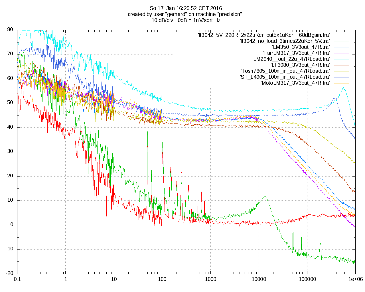

LM317/337 is not the solution. In fact, it does not make much of a difference
which one of the crowd you use. Noisewise, they are all in a 10 dB band.
LT3042, 3045, 3094? for neg. is a completely different league.

Zeners at <= 3V3 are wonderful. The onset of avalanching already at < 5V
destroys their noise behaviour. The TC compensation at 6V8 relies on the
opposite TC of the Zener and the avalange effect. Those diodes are
temp-stable, but they are noise generators. Some examples are in the
pictures to the right/left.
The 723 with it's 6V zener is not so wonderful. OK, it can stand it's ground
against the noisy bandgaps. I wonder what tricks LT did pull to compete
successfully with the Zeners in the LT6655.
Cheers, Gerhard

I's outright dumb to throw out a part that is 40 dB better right from the start.
LT4042 is handicapped at low frequencies by the preamp and
FFT analyzer noise.
