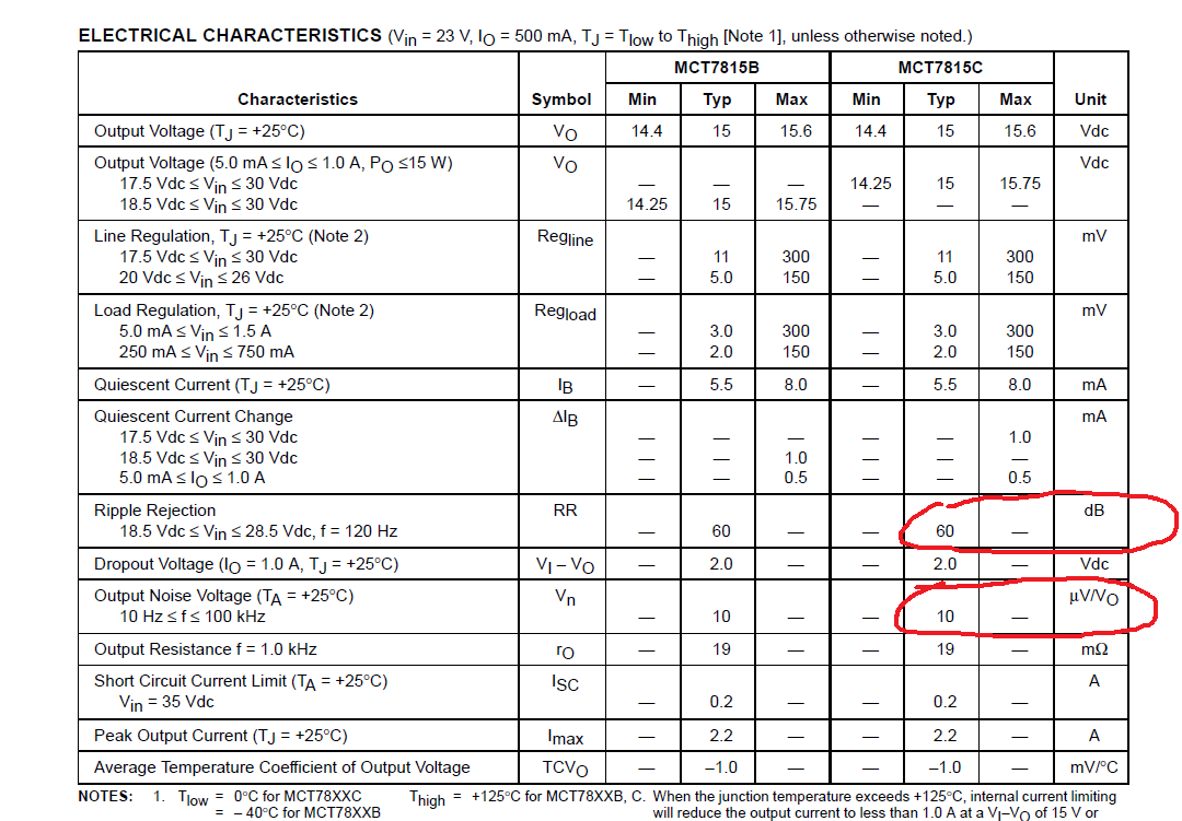

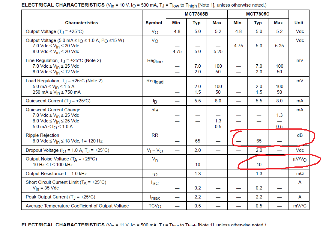

I found something interesting comparing all the 78xx/79xx datasheet available online.The Motorola MCT78xx, although it doesn't have a great ripple rejection, it has a constant and lowest noise over 10hz...100khz.I'm not amazed that it is the lowest but i fear it is a mistake in the datasheet because it's the same in all 78xx series.At the same time the superior LM340 78xx series has a better ripple rehjection but significantly worse noise figures and it's also the same as in all other datasheet from other manufacturers, the noise varies with output voltage.It's only Motorla MCT series that has a constant and lowest 10uv noise in all 78xx series.What do you think?Is the datasheet wrong?
