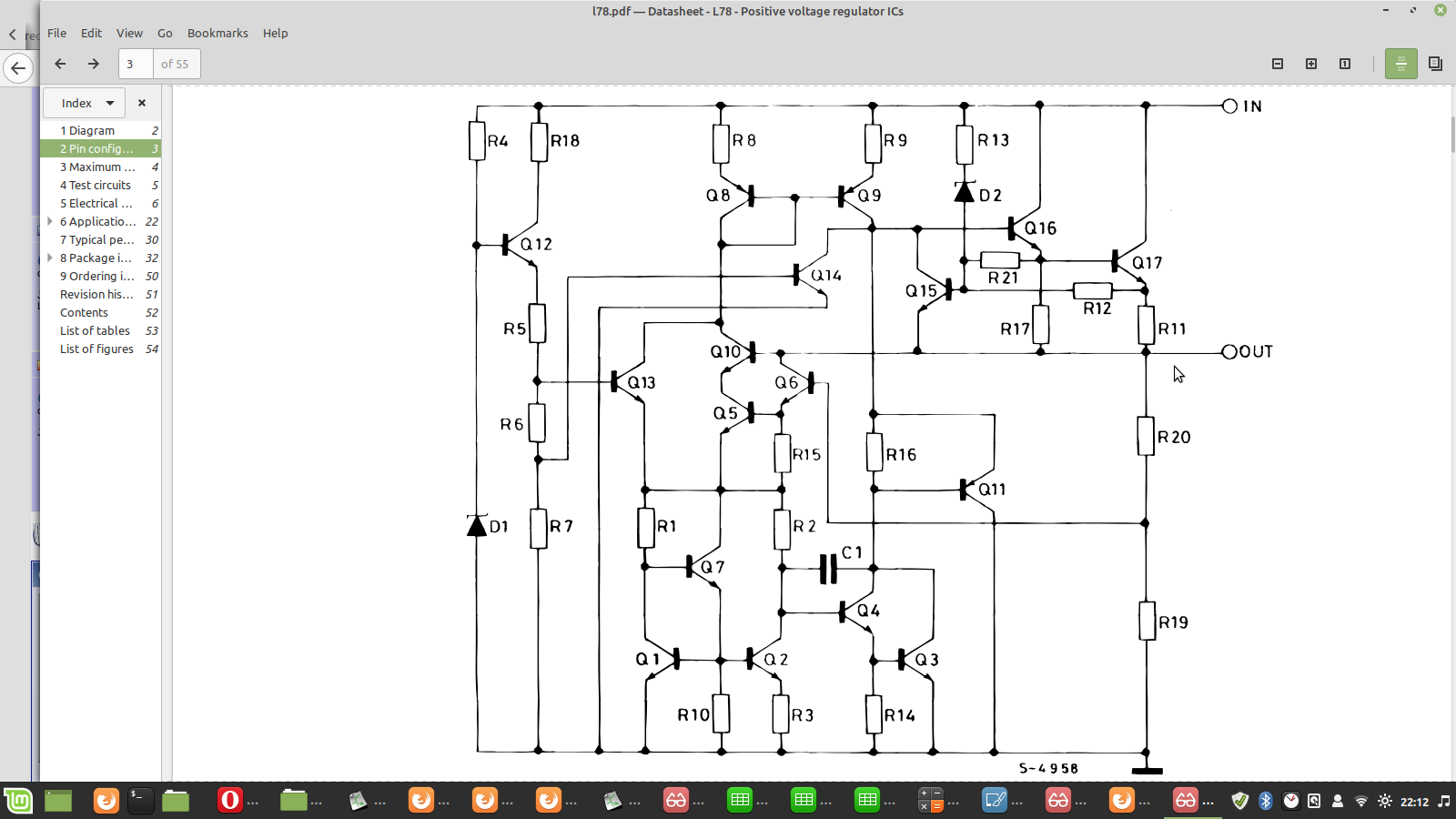

Are you really fine with IC voltage regulators ?
"78/79xx has no divider at the output,it is referenced to ground...the divider is internal, can't be disabled or modified.it's lm317/337/lt1083...86 that has it. "
R17/R11 / R20+R19 I think suggests otherwise in the schematic of a 78xx
whereas D2 + D3 which are zeners in a 317 complicate its output being classed as a divider
rather it has zeners biased by internal resistance as shunt regulation

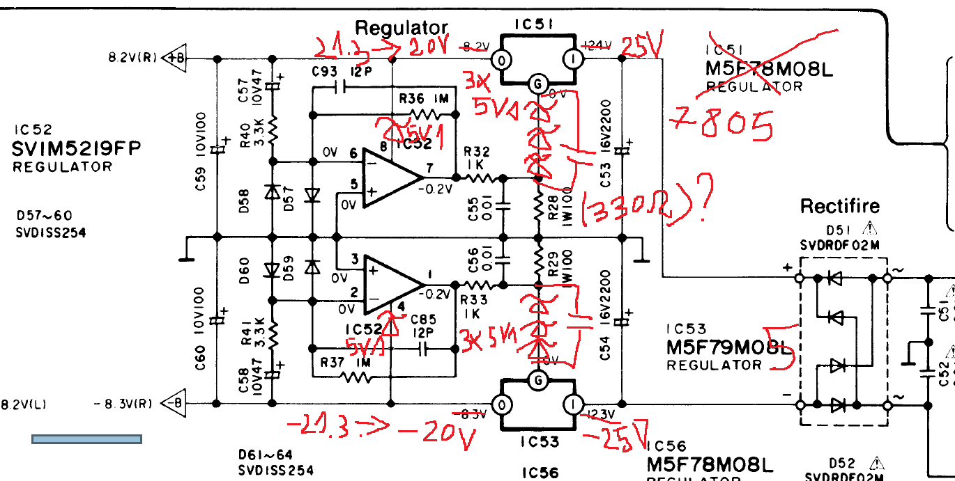

Could you possibly help me with commenting my idea if there's anything wrong with it? I already built one regulator like this for +-10v supply rails for a headphones amp.
As i need to supply a phono preamp too, I thought of trying to modify the Technics regulators so that i get the best noise and regulation for +-20v suply rails too .
Using the lowest voltage 78/79xx regulators(using lm340 either MCT 78xx and mc79xx if their datasheet are true to the last bit)
???? https://www.diyaudio.com/forums/power-supplies/359652-fine-ic-voltage-regulators-14.html#post6335583
and a series of zenner diodes to get to the voltage i want , i should get the lowest noise and best ripple rejection.
I don't really know the zenner noise though...i can only shunt them with a 100nf...10uf capacitor.
Also the 100ohms resistor used to apply the current feedback to the regulator should probably be raised to 330...470ohms to be more efective which will raise the output even more by about 1.2...1.5v , thus i'd have a +-21.3v voltage regulator, ideal for my last phono preamp.
Using 3 zenner diodes in series i should also lower some of their counterphase noise too.
I can replace the 5v1 zener resistors with 4v7 variation to get the output voltage to +-20v as the thermal variation in 4v7 is very close to 5v1 zenner one.
The aditional op-amp improves the ripple rejection by at least 20db as i read in a very old article on those technics cd players using this kind of regulator .OPA2227 comes to mind as op-amp.
Using the 7805/7905 and three 5v1 zenners as refference with a 330ohm feedback resistor lowers the output headroomin case of a bigger surge i think...that might be the only downside in my view now, but i'm just focusing on reducing the noise and ripple for the moment as the circuits involved don't take too much current.
I am thinking of supplying also the +-10v regulator with the +-20v regulator and maybe no big value capacitor should be used at the +-20v reg output for that matter.
One more thing, consulting the actual datasheet from Philips and Vishay for BZX 55c series , the lowest tempco zenners are the 5.1v and 4v7 zenner , not the 6v(6v2) ones as the Art of Electronics said.

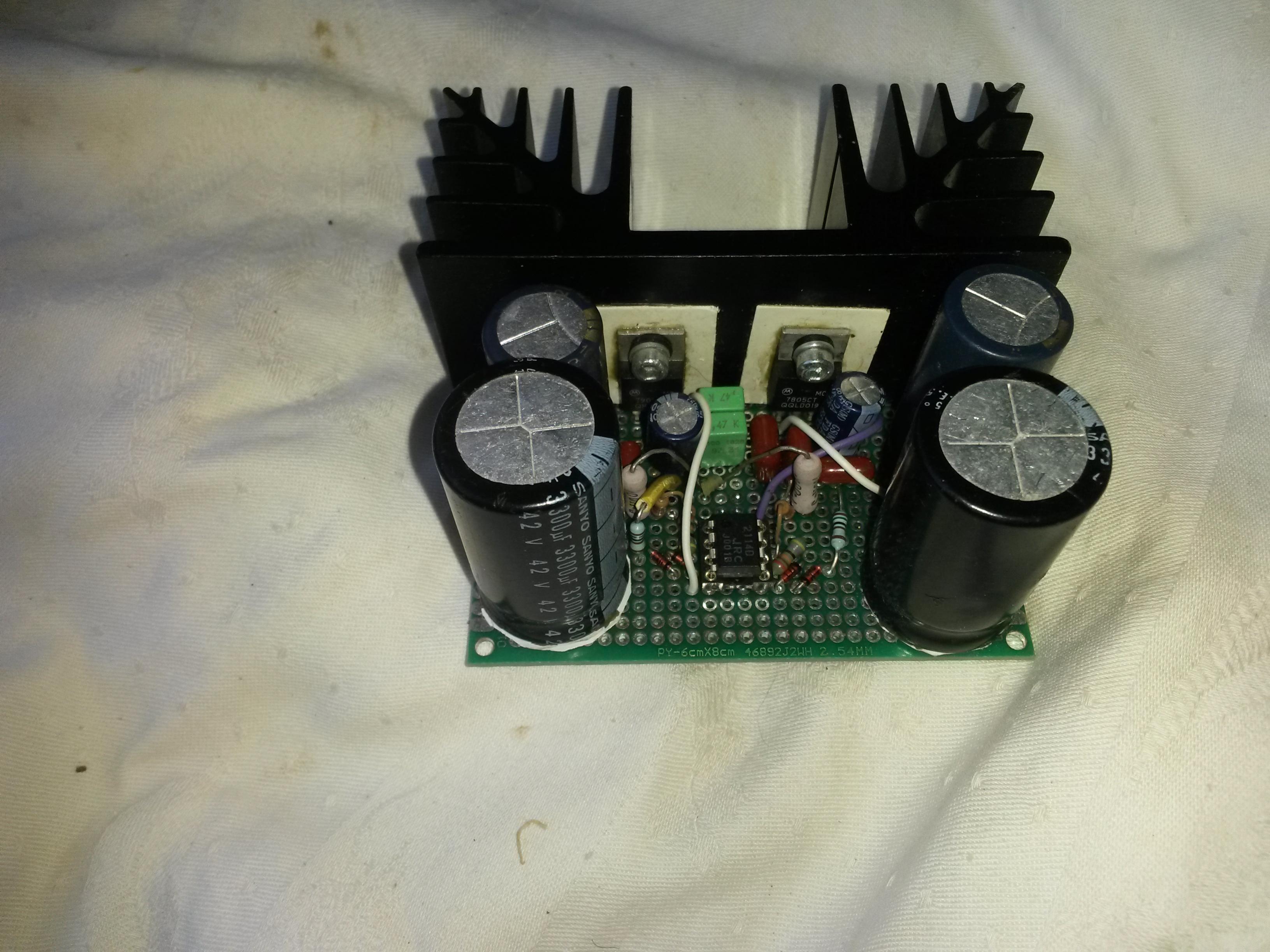

i know...everybody is sending me again and again to elvee's regulator...i stick with the Technics as it looks more promissing and is also taking less space for two regulators.Here's the +-10v regulator for my headphone's amp.Not yet connected...Looking first for building the second +-20v regulator for the phono preamp then hooking them up in series...so the headphone's amp regulator will load the phono preamp regulator too...I'll just see which one is better, the Kenwood regulator or this new one.

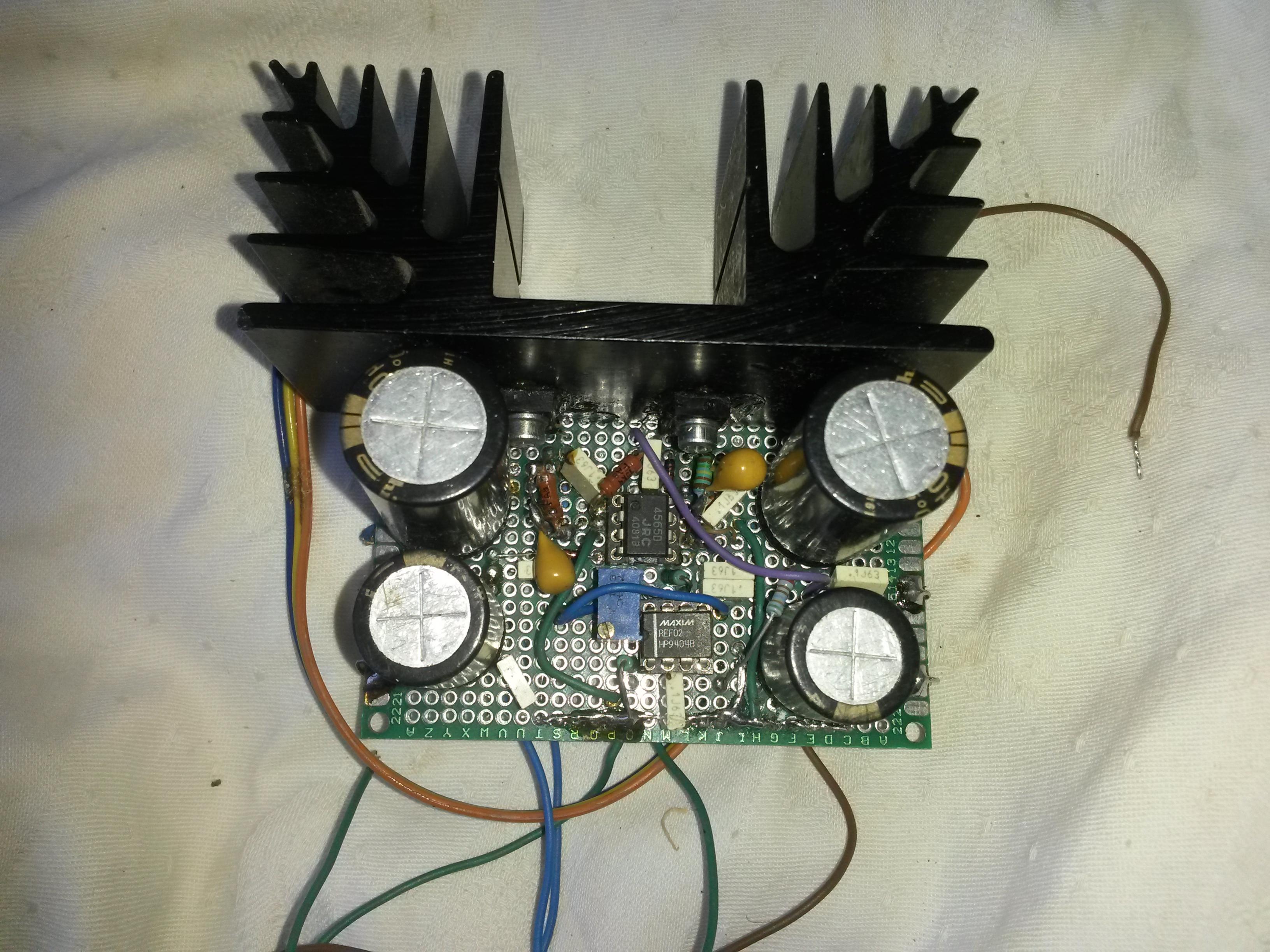

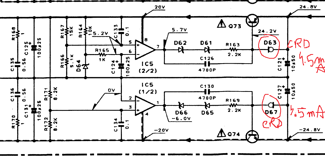

I already built a +-20v regulator based on a Kenwood schematic based on op-amp transistor and zenners...i just want to check the Technics variation too. Lm329 has 100uv of noise by itself...i still have no idea what a bzx 55c zenner diode noise would be compared to a regulated zenner.I don't need overcomplications.

what i don't like at technics regulator is that it's not a tracking one like kenwood...
I do not know if that was a question.
Why do you think you need tracking regulators? Your in/outs should reference local "zero", NOT "half the difference between the supplies".
Tracking is convenient for highly adjustable supplies. It also avoids one voltage reference. Unless otherwise specified, it does not ensure both rails collapse if one does.
