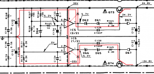

Are you really fine with IC voltage regulators ?
It's not really clear to me how they ensure start up for the common emitter case. With 0 output voltages and hence 0 op-amp supply voltages, the op-amps already have to supply the transistors with enough base current to make the whole thing start up. Maybe they use MOS op-amps so drain-bulk diodes will conduct current at start up?
For the common collector case, the current sources supply the base current. When the voltage of the Zener diodes between the op-amp and the transistor exceeds the minimum op-amp supply voltage plus one VBE, it should all work.

In this case, the output voltages are controlled by an op-amp that only works when the output voltages are high enough. It seems clear to me that you have to think beforehand about start up with a circuit like that.
I think the start-up goes via the internal diodes output-V+ and output -V-
The decoupling capacitors and the supply current of the opamp closes the loop.

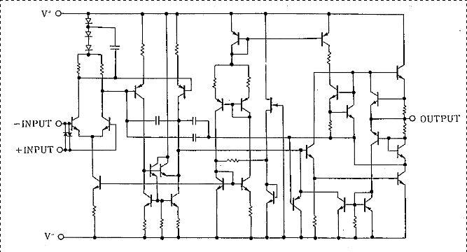

That also occurred to me, that's why I wondered whether they use CMOS op-amps (those almost always have drain-bulk diodes to the supplies). According to post #184 they don't, they use NJM2114 op-amps, which according to their datasheet have the attached internal schematic (although I have the impression that there are some polarities mixed up).
When the current has to flow into the output (positive regulator), the base-collector diode of the upper NPN current limiting transistor and the base-collector diode of the NPN output transistor provide a current path to the positive supply. So far, so good.
When the current has to flow out of the output (negative regulator), the collector to substrate diode of the NPN just below the output probably does the trick.
All in all, I think you are right.

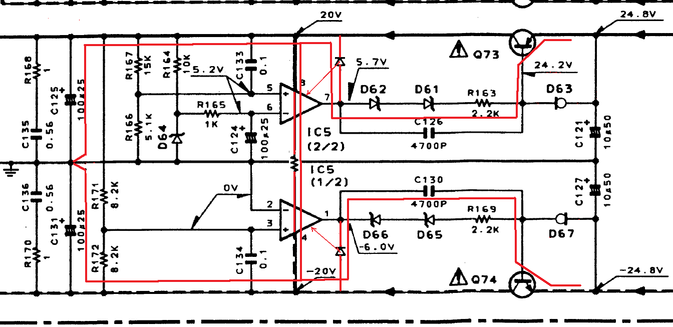

The way I see the start up.
At start IC5 is not powered, so it's output is 0V under some impedance from the output stage of IC5.
I guess this impedance is low enough to sink enough current through the zeners D62 D61 + 2.2K to bring the transistor into conduction. Then bingo, voltage appears at the 20V to give normal power to IC5
This asks for an inspection of what's inside IC5 at the output stage. A totem pole I presume. But more complex when under powered because it is an IC with a substrate that is actually a diode reverse biased when powered normally.
I guess the Japanese engineers measured the behavior of the output of that specific IC when underpowered.
May be a lengthy text equivalent to the previous posts.
This could lead to some nasty surprises for op-amp rollers...
the output stage of njum 2114 is almost identical to ne5532(34) .2114 was advertised as a ne5532 improvement too...so we may have some options .At the same time why would you roll op-amps in a power supply especially when you have such a good op-amp as njm2114 there? i wouldn't replace njm2114 with anything in audio signal path if the circuit was designed for njm2114.
