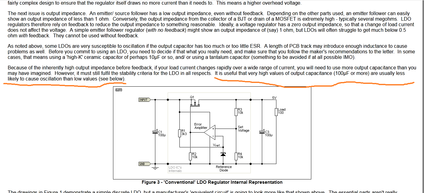

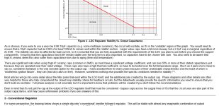

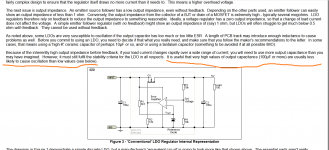

You might find useful this statemnt on ESP site .I often saw LDO's using very high output capacitors who's esr nor esl factors are really low , but you can control them in a real circuit with a little bit of holistic thinking.Sometimes a 10 000uf capacitor works great with an LDO, but at the same time if you are using an LDO with a high Vin-Vout margin everything is safe with almost every capacitor output .
LDO Regulators

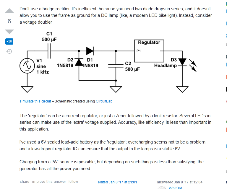

Two years ago a i had a small project with a school that asked me to make a small instalation that would show students how you can charge a smartphone using a bike and a dynamo.As it was for students it had to be very descriptive with lots of lights(vu-meters, voltage and current display at all times. I made two types of regulators for the usb carger: one was a 0.5v drop regular LDO chip, the other was a buck boost converter and actually one of the most efficient on the market. Due to the very low output of the bike dynamo it prooved that the series regulator LDO had the same efficiency as the switching circuit, but to make sure that both the LDO and the switching charger would get me the best efficiency all the time no matter how hard the kids were pedalling, i chose a trick shown by a guy whose post you have below. Since then i always try using voltage multipliers in my low power circuits as they also show better filtering right from the start . For a static instalation that you don't need to move pedaling the sealed lead battery regulator was the real deal 🙂
